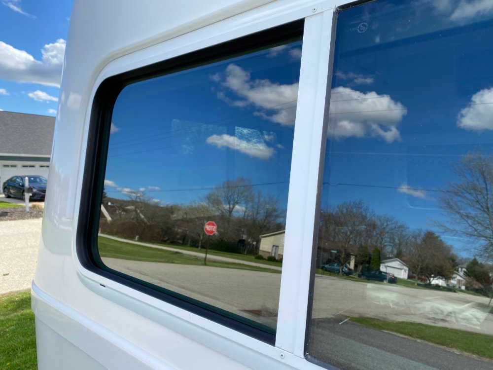

RustyMD Posted January 8, 2023 Share Posted January 8, 2023 Is the window weather stripping that Oliver uses commercially available? Thought I’d look into that before submitting a ticket. I understand that it can shrink over time. Robert Youens LE II 2023 Robert Youens 2023 LEII Hull #1304 TV 2022 RAM 1500 5.7L Hemi e-torque with tow package Link to comment Share on other sites More sharing options...
Frank C Posted January 8, 2023 Share Posted January 8, 2023 21 minutes ago, RustyMD said: Is the window weather stripping that Oliver uses commercially available? Thought I’d look into that before submitting a ticket. I understand that it can shrink over time. Robert Youens LE II 2023 Yes, available from Pelland Enterprises. Sold by the foot in both white and black. https://www.pellandent.com/Half-Inch-Glass-Vinyl-Seal I changed mine to black since the white was so hard to keep clean. 3 Link to comment Share on other sites More sharing options...
Moderators mossemi Posted January 8, 2023 Moderators Share Posted January 8, 2023 48 minutes ago, RustyMD said: I understand that it can shrink over time. The only shrinkage I have noticed with the Pelland Enterprises replacement seal is in the length. So when you are cutting a replacement, try not to stretch the seal and cut it long. If it is too long to install then you will have some left to trim. Mossey 2 1 Mike and Krunch Lutz, FL 2017 LEII #193 “the dog house” Link to comment Share on other sites More sharing options...

Moderator+ ScubaRx Posted January 8, 2023 Moderator+ Share Posted January 8, 2023 2 hours ago, mossemi said: The only shrinkage I have noticed with the Pelland Enterprises replacement seal is in the length. So when you are cutting a replacement, try not to stretch the seal and cut it long. If it is too long to install then you will have some left to trim. Mossey Good advice... I helped a buddy build a barn years ago. He cautioned me against cutting the boards, saying "If you cut it too short, we can always piece it, but if you cut it too long, I don't know what we'll do!!!???" 😀🤪😉 1 4 Steve, Tali and our dog Rocky plus our beloved Storm, Maggie, Lucy and Reacher (all waiting at the Rainbow Bridge) 2008 Legacy Elite I - Outlaw Oliver, Hull #026 | 2014 Legacy Elite II - Outlaw Oliver, Hull #050 | 2022 Silverado High Country 3500HD SRW Diesel 4x4 Link to comment Share on other sites More sharing options...
