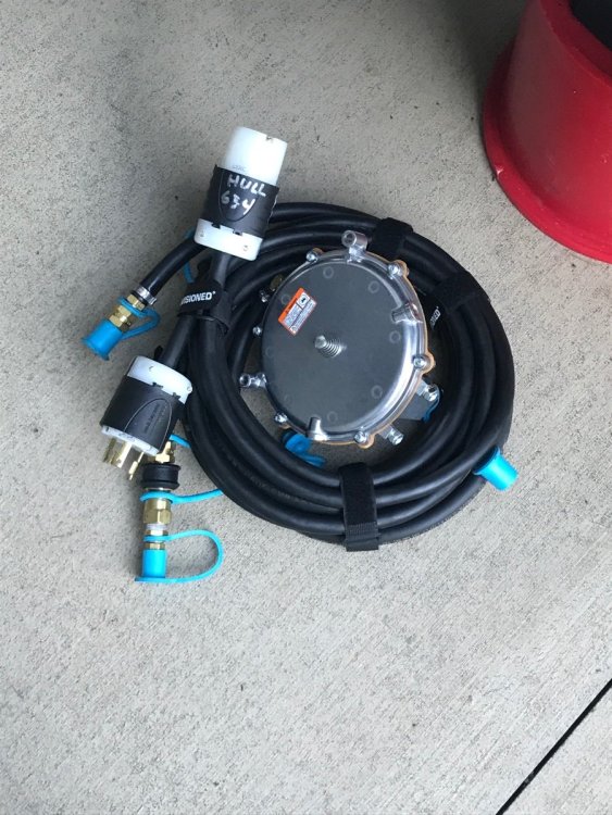

I have a Honda eu3000is which I converted to LP not wanting to carry any gasoline in my TV. I have successfully run my generator off our Oliver’s QC. I retrofit the Hutchmountain LP conversion kit to this Honda. It does require a demand regulator to run the generator. Look closely at my photo and you will see the demand regulator. It has a small button which I push to prime the generator when starting to get the flow of LP going. It only requires one touch of the button and the Honda fires right up. I don’t know if this helps since you have a different brand generator but thought I would share what works for my whisper quiet Honda.
