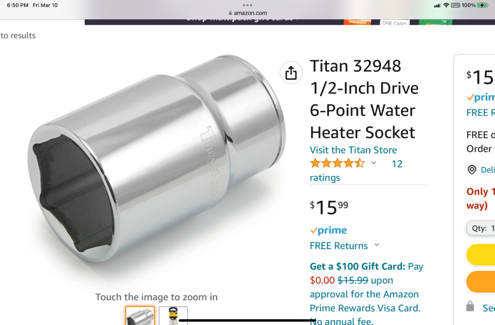

John E Davies Posted March 11, 2023 Posted March 11, 2023 Do you have the special 1 1/2” thinwalled socket? breaker bar or impact gun? There are cheap stamped tools, but IMHO you should buy a quality one that will make the job easy. Turn off the shore power and trip the water heater circuit breaker! Open the relief valve lever so that the water pressure will vent. If you don’t have the other tools you need, go ahead and buy a socket for the anode rod so you can remove it. Use a water heater flush wand hooked to a garden hose to flush out any gunk before reassembly. Use teflon tape on the anode when reassemble it. The heating element should come with a new gasket, it doesn’t need tape but the surfaces must be spotless. John Davies Spokane WA 2 SOLD 07/23 "Mouse": 2017 Legacy Elite II Two Beds, Hull Number 218, See my HOW TO threads: Tow Vehicle: 2013 Land Cruiser 200, 32” LT tires, airbags, Safari snorkel, Maggiolina Grand Tour 360 Carbon RTT.

Moderator+ ScubaRx Posted March 13, 2023 Moderator+ Posted March 13, 2023 On 3/10/2023 at 6:40 PM, Gliddenwoods said: I may have to replace my electric water heater element. I have watch a Youtube on the process and it looks straightforward enough. However any advice and/or cautions from those with experience would be welcomed. Thanks. It simply takes a 1-1/2” socket to remove the element. If your set doesn’t have one that large, I’d get one at Harbor Freight. 1 Steve, Tali and our dog Rocky plus our beloved dogs Storm, Lucy, Maggie and Reacher (all waiting at the Rainbow Bridge) 2008 Legacy Elite I - Outlaw Oliver, Hull #026 | 2014 Legacy Elite II - Outlaw Oliver, Hull #050 | 2022 Silverado High Country 3500HD SRW Diesel 4x4
