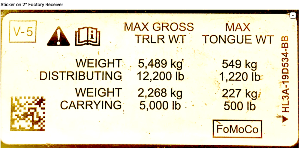

For your truck specifics, look at the RECEIVER  of your F150 Hitch for a Rating Sticker.
The one below is from a 2018 F150 with max tow package.
It shows two sets of numbers,
Weight Distributing:   States max trailer weight and max tongue weight for the hitch if you are using a weight distribution trailer hitch (like the Anderson used on Olivers).  In this case 12,200 lb trailer and 1,220 lbs direct downward force of tongue weight.  An Elite II full of food and gear weighs between 5500-6500 lbs.  The tongue weight is about 10% of that and can range from 525-700 lbs depending on how you've loaded the trailer.  (10% of Trailer Wt calculated as tongue weight is a goal for a very stable tow with the Oliver Elite II)
Weight Carrying:  States the max trailer weight when you are NOT using a weight distribution hitch.  This is just dropping a trailer on the ball and driving away.  Note it's set to a 5000 lb trailer (like the Elite single axle) and 500lb's max tongue weight.
Most of the time you'll find that a loaded Oliver Elite II will have greater than a 500lb tongue weight.  (Ours runs in the 620+ range because we have a front basked full of gear.
Implication:
If you have an F150 with these receiver ratings, you should be using a weight distributing Anderson hitch with your Oliver Elite II for safety purposes.
