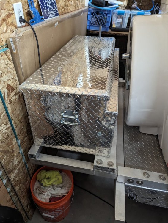

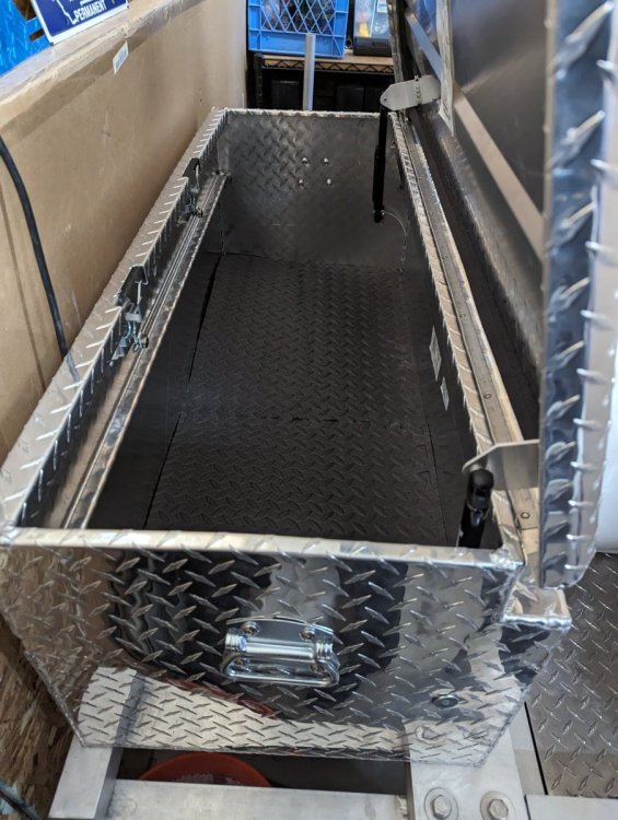

Another winter project with help of good friend with "SKILLS" in welding aluminum. Added Bumper box. Thanks to all who contributed on the subjet.
I did get endcaps put on and license plate bracket . Before picture. Picture was taken . Will update with better pictures later when snow clears.

An interesting and neat looking storage area. How much does the new storage box and mounting system weigh and how much weight will you be able to safely carry in the box?
Thanks!
To add to Patriot’s line of questioning, how difficult is it to access the spare tire?

I would suggest that only 150 lbs (including the box) be added.
Same weight that OTT recommends for bikes and bike racks on the back.
