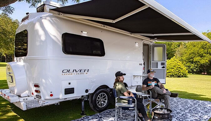

Oliver Travel Trailers: Durable and beautiful, easy to tow and maintain, loved by campers for unforgettable adventures
Born from Passion, Made for Adventure
Born from the Oliver family's passion for camping, our Tennessee-made travel trailers deliver unmatched durability, beauty, and hassle-free setup. Easy to tow, these premium trailers are perfect for all campers and ideal as destination trailers.

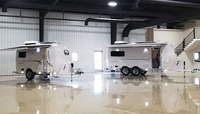

Oliver's Legacy Elite and Elite II trailers, launched in 2007-2008, renowned for fiberglass quality and record sales post-2013
Quality & Resilience
Since 2007, Oliver Travel Trailers has crafted the 18′ 5″ Legacy Elite and 23′ 6″ Legacy Elite II, renowned for premium fiberglass quality and durability. After a brief 2008 pause due to economic conditions, our Tennessee travel trailer manufacturing resumed in 2013, delivering exceptional quality.
