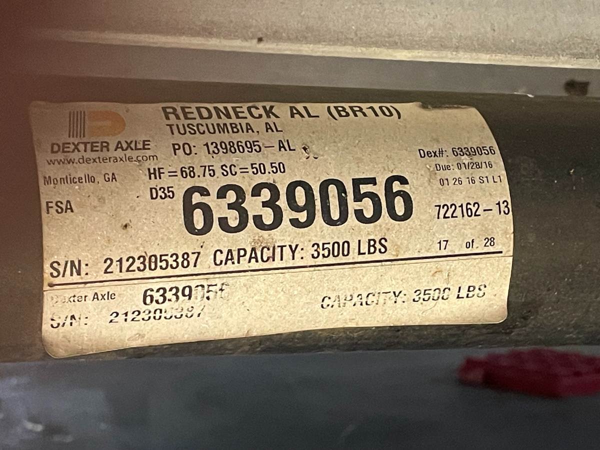

ScottyGS replied to Wayfinder's topic in Mechanical & Technical Tips
I know this is an old thread but.... I am currently in the market for the Nev-R-Lube Axles and wanted to share that Hull #145, a 2016 model, picked up in June has the 50.5" axles. I also assume that current LE2's are provided the D52 axle with an SC measurement of 50.5"..... If someone would confirm that for me I would appreciate it. TIA, Scotty -
