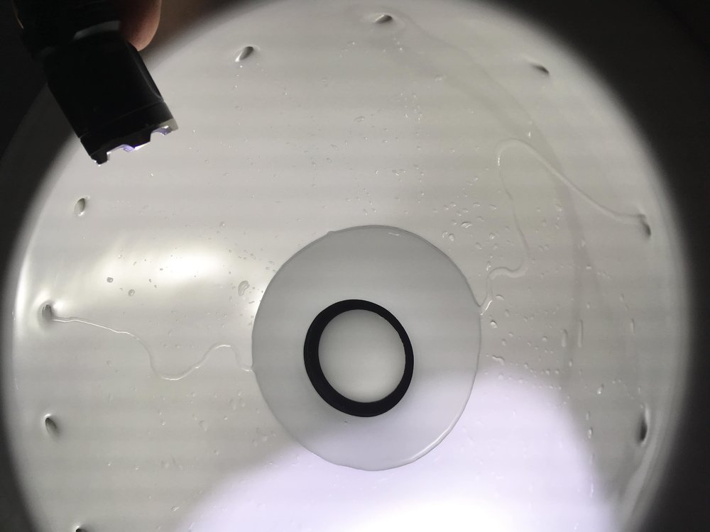

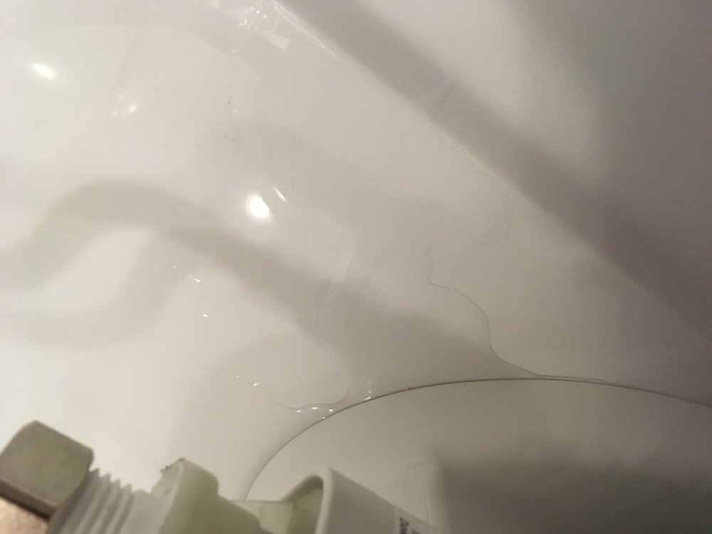

we were attached to city water. Water pump was not on. At the backside valve, there is no constant dripping. The only way I knew that it was coming from that underside “cutout/window” was that I had my head down there when a thin stream of water was released. It didn’t spray, the small amount of water was just released from the valve area almost as if a tiny cup were filling and then tipped over. It made a dollop of water about the size of a quarter and then just stopped. Not more dripping. We timed between “dollops” and it was about 2 min. Inside the bowl there is a slow constant stream from 2 holes at about the 1:00 and 7:00 positions. You can see a slight pulsation at the water edge as the bowl slowly fills.
not yet. I jiggled on the connector and it didn’t feel loose. For the rest of the trip ( just an overnight) we turned off the inlet valve and only turned it on to flush. Once we got back I had to go back to work. We’re gonna check with Oliver as we found some other things that need to be addressed. The leak is strsnge though because it’s not a steady stream or even a drip. It’s more of a timed pulse of water that comes out approx every 2 min. Also the streams of water from the 2 holes in the bowel also have a slight pulse pattern to them. It’s just odd. Angela

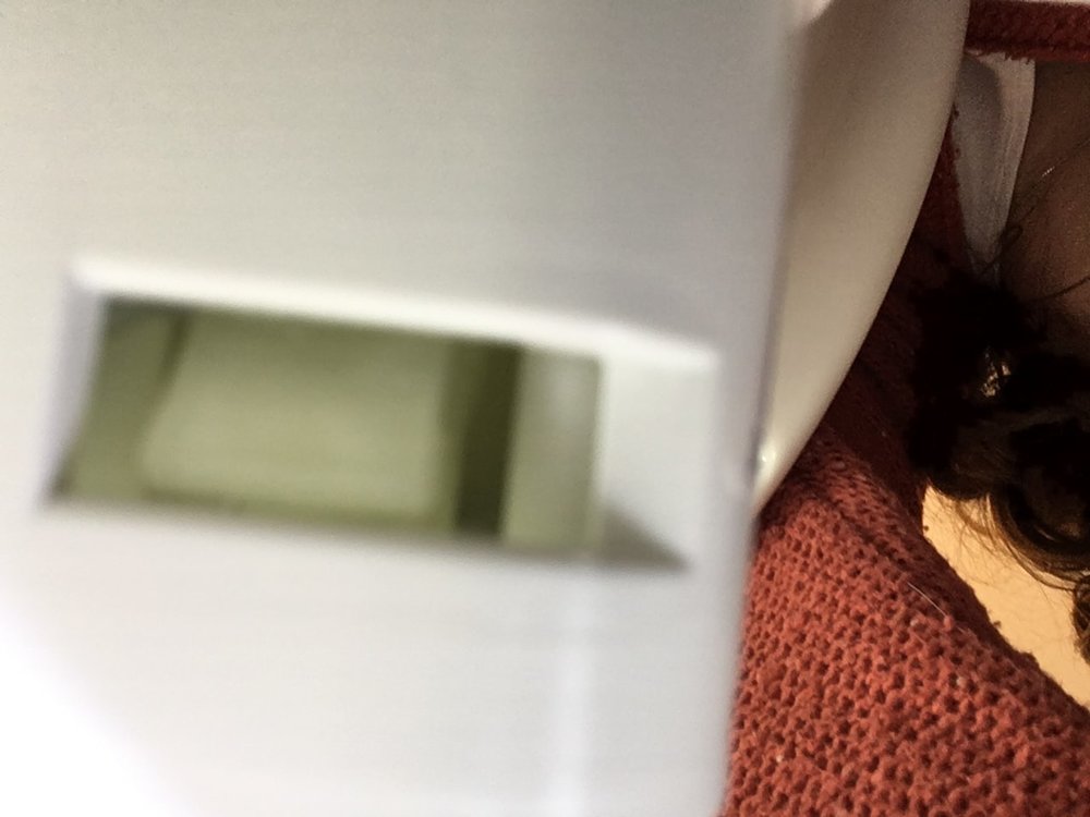

Just craned my head behind the toilet and see that there is a square opening on the underside of the solid piece that projects from the back base. Approx every 2 min there is a squirt of water. The pic is oriented with my phone on the floor looking up at the just out piece.
This is our second trip. We are experiencing leaking water from the base of the toilet around the back of the toilet. Also inside the toilet bowl, 2 of the water holes continue to leak water after flushing. We had no trouble in our pick up trip in October. Anyone have any thoughts?
