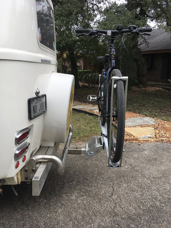

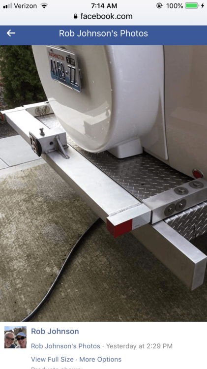

Thanks John for your quick response and many ideas. We particularly like the idea of the compression sleeves to make the bolts more secure. As a point of clarification, we are working with Rob Babcock, who built Pete's bicycle rack. We want to have a 2 inch receiver so that we can swap out our bike rack from the Oliver, to our Tundra. We are planning on using square stainless steel tubes, that will be mounted onto the side of the frame rails with a plate. I think that we will likely remove the diamond plate on the sides. We think that a side mounted rack would be more secure and stable. We are really enjoying our Oliver. Thanks again John, and everyone else on this forum-it is invaluable!

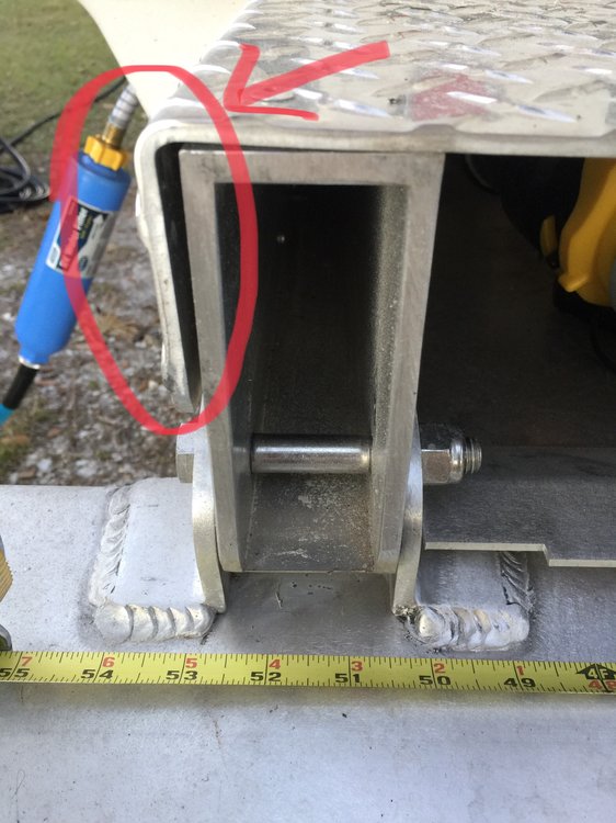

Not sure if this is the right place to post this question; we are building a bicycle rack and plan on mounting it using plates and bolts onto the side of the bumper. However, the diamond plate that wraps around the bumper is not flush against the bumper, so we would need to bend the diamond plate so that it is flush . What is the best way to bend diamond plate? Is there any risk of cracking the diamond plate when it is being bent? We noticed that most people mount their bicylce rack from the top-we felt that mounting it from the side using plates would allow for a stiffer rack and shorter bolts increasing strength.
Hey John We were glad to see your post re building a bike rack. After a lot of thinking and looking, Kim and I have settled on having a bike rack built. We had originally thought that we would have Babcock Metals, LLC build a rack like Pete had made, but are moving towards a different style that apparently was first made by Oliver. After talking with Rob Babcock he also felt that the second design would be more fitting for an Oliver. We are in the process of getting measurements and design specs to Rob. For those of you that don't know, Babcock Metals, LLC built Pete's rack-Rob Babcock is based in Utah. He is very open to doing custom fabrications and does very good work. The measurement that you are looking for is one that we will need for our rack, and will secure in the next week or so. Once we have numbers we will post them. We have bought a Yakima Longhaul bicycle rack that uses a 2 inch. receiver hitch and can be used on both the RV and our truck. We plan on using the rack for carrying two gravel grinder bikes and a Serotta road bike. David Thompson
