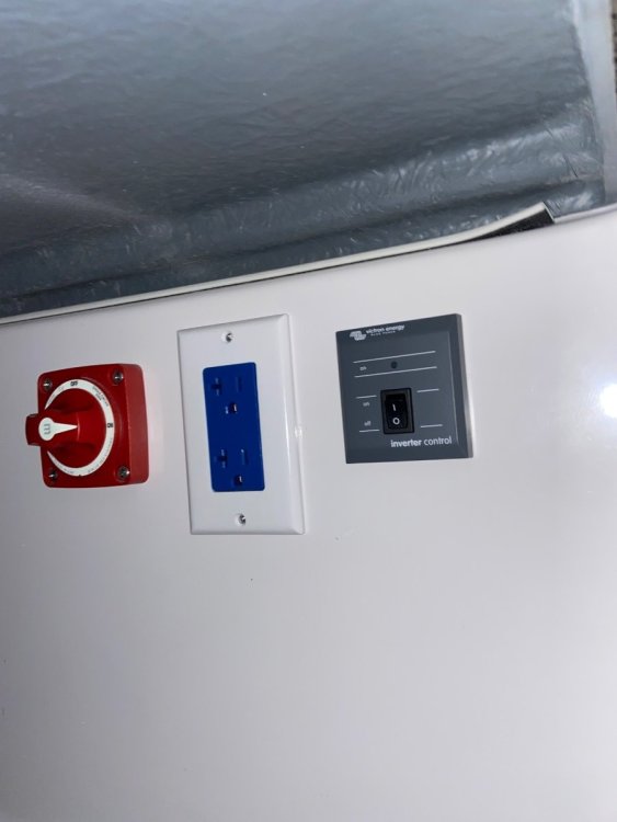

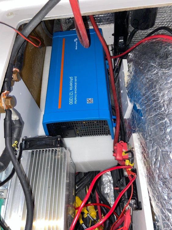

Well, I explored the possibility of installing my inverter in the rear upper corner as Oliver does, but wasn’t comfortable with that location. So, after some rearranging of wiring, I managed to make a suitable area for it to be mounted below the dinette seating. It will power a dedicated outlet under the bed. I don’t plan on using it much, but as the say it’s better to have it and not need it than need it and not have it.
I want to install a 1200w inverter in my Elite I. Can’t seem to find enough room under the bench access panels near batteries. Where does the factory install the optional Xantrex inverter during construction in the smaller Elite I?
