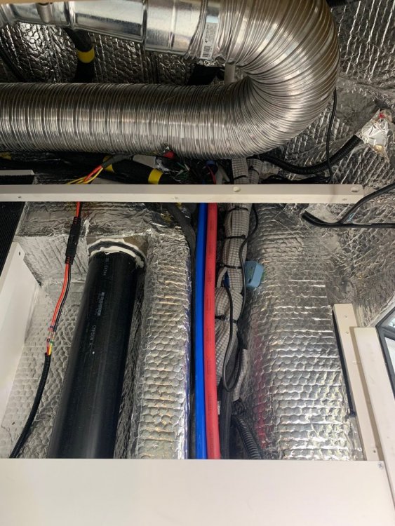

Hi @Ray and Susan Huff, you don't have to disconnect the batteries - use the relay cutoff located under the street side bed - nearest the pantry. There are two in there and you want the one that is mounted directly under the pantry. Here's a picture looking down the basement from the rear to the front on the street side. I've circled the breaker that is in between the batteries and the inverter. This is the one that you want to "trip" by pushing the top red square button. When you do that the bar on the side will come out - the picture shows the bar on mine "tripped". Do this and also cut off shore power. Then reset this breaker by pushing that bar on the side back in and turn on shore power if you want - then see if you have reset your remote. Sorry for confusion!!
