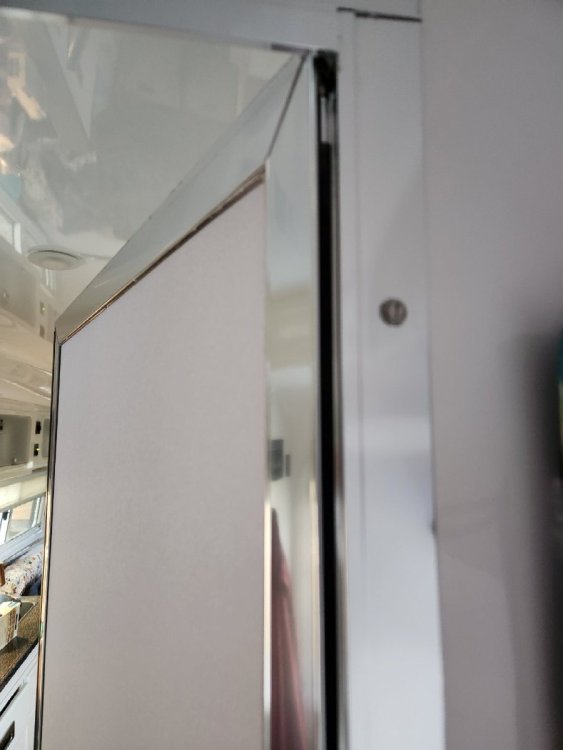

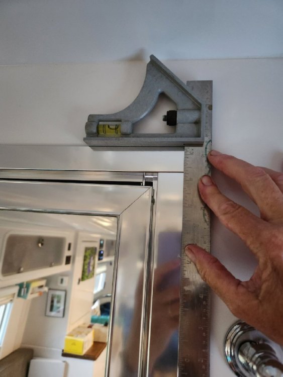

Thanks all. The trailer is as level as it's going to get and we're parked for a while. The hinge seems to be a single pin that runs the length of the door. Pics attached
I re hung the lav door after getting the glass replaced and it is not square (I don't think it ever was completely square, but now it's worse) Is there a way to adjust it to make it hang straighter? The lower right (as you're facing it) corner hangs up on the threshold so I have to lift the door to get it to close all the way and then again to open it.
