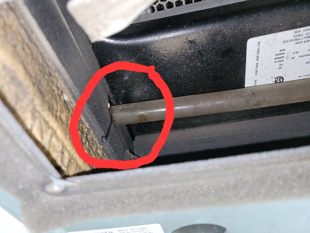

Dometic a/c tubing
Alberta and Randy replied to Alberta and Randy's topic in Mechanical & Technical Tips
Thanks everyone for the quick replies. I continued researching after I posted and found mossemi previous post (thanks for your link again here! ) and spoke with scubaRx. I believe I have a path forward... will see if it's successful. Appreciate all your input! -
2015 LE2 Hull 67 We are trying to figure out where the plastic tubing, shown in pictures, goes when it disappears from view? In hopes that will troubleshoot the real problem. Water is dripping at each location where tube goes behind fiberglass wall? The exterior drip hole on bottom street side does have water dripping out, sometimes slow sometimes faster. We pushed a wire up there and only got small black smears out, so didn't feel like it was stopped up from insect or other. Took the top cover off and didn't see anything eye catching (drip pan blockage). Appreciate any tips.
