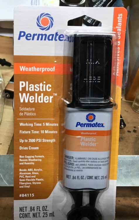

I think Oliver uses a material that is used by the boating industry called starboard. Others may have the correct name if this isn’t correct. I have used vinyl trim board readily available at Lowe’s and Home Depot in various widths and thickness. I also use an epoxy by Permatex that is very high solvent content and actually melts into both the vinyl board and the fiberglass surface and is much like fiberglass resin.IMG_1106.thumb.jpeg.be9e030bf13b5401c9d6fdad7f025ba0.jpeg
