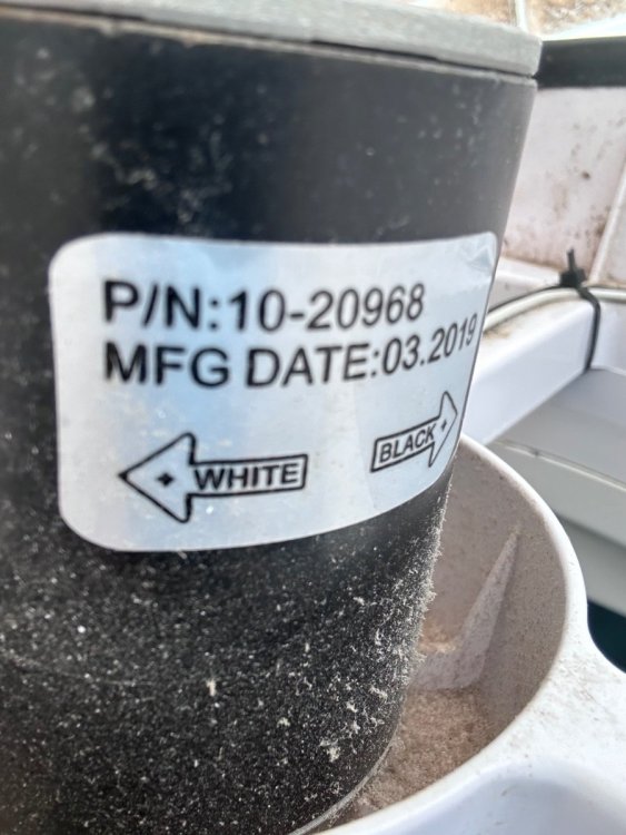

From the motor of our 2019IMG_7151.thumb.jpeg.feae7a0aaecf1757ac3e92c7418b4190.jpeg

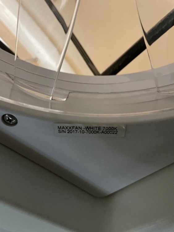

Are you looking for the fan motor data label or the model and SN of the whole fan? This is the model of the whole fan on 2019 hull 313. Remove the screen and you will see this label.
