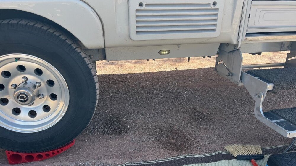

I understand the several weep holes around the perimeter of the Oliver are designed to drip water to remove condensate, but how much is normal? This picture was taken at 10 AM on a sunny day at a campground north of I-40 in dry Arizona. You can see the 3 water spots. The center one for the fridge had twice the volume of water than the two weep holes.
Chris was cleaning up breakfast dishes and I noticed this when breaking camp outside and took this picture. My first thought was a leak in the kitchen plumbing.
I have read here that some of you in other climates have condensation issues, talk of dehumidifiers. In the SW, this time of year is the windy-dry season, and we run 4 large humidifiers! I had not witnessed any moisture on windows during our trip, or down below when I worked upgrade projects, and the wet bath dries in minutes after a shower.
Is this normal, or should I check the plumbing under the kitchen sink?

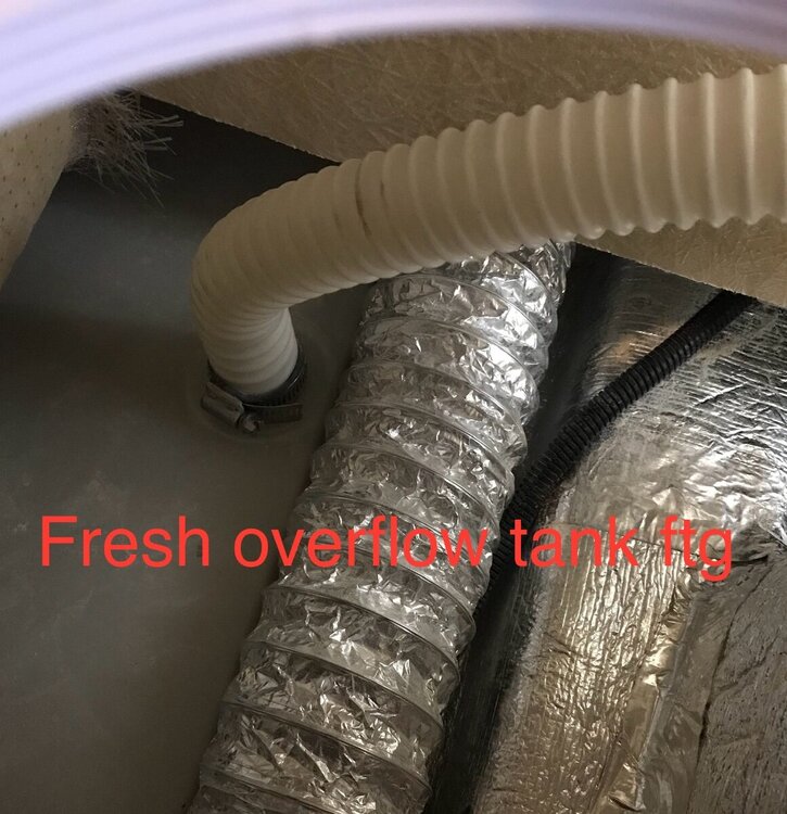

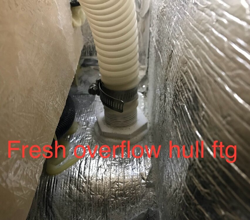

Do you have water in your fresh tank? The reason I ask is on our OEII the fresh water overflow tube clamp was loose on the tank fitting and we had water dripping from those holes. The water under the fridge drain is normal.
Picture through hole in bottom of kitchen cabinet. Hole was installed by factory service department so they could tighten the clamps.

When we have condensation between the hulls, have seen more condensation between the hulls at the rear Oliver sign. Have not seen much condensation between the hulls in the area where you see water dripping out.

Yes, we certainly had water in the FWT, filled 2 days before using the boondocking port, filling the FWT from the extra tank in our TV, at our previous camp. Our tank only fills to 20 +/- gallons due to the tank issue in the older hulls (not yet warranty repaired by OTT). Between camps, we drove 165 miles, parked and this was the next morning. You would think if water was going to come out of the overflow it would be while on the road, water in the tank sloshing back and forth.
We used water for dinner, bathroom during our stay and Chris was doing breakfast dishes while this was leaking. I'm trying to figure out, how would the overflow tub have any water in it to leak through this fitting? Thanks again.

@jd1923 my guess is the hose clamp on the through hull fitting is loose or the fitting itself is cracked and water from the fresh tank sloshing has run down and out the hull drain. Hull 313 only has one hull drain in that area , plus the fridge drain and the overflow drain.

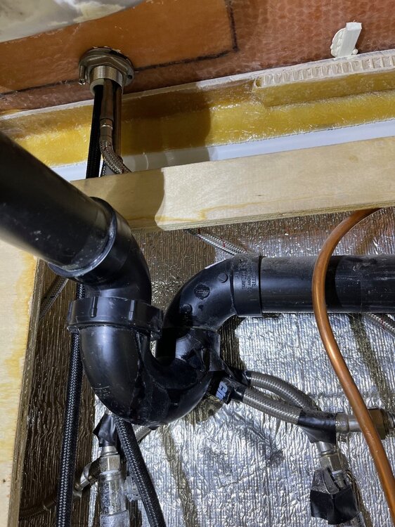

I would remove the drawers and the panel at the back of the drawer cavity and make sure the sink trap fitting is tight and that you don’t have a leak from the faucet. Then stick your phone camera in behind the fridge and make a video.

I noticed a minor drip on the far rear weep hole at a different time. What you experienced could have been your level a a bit off. We get the level spot-on with the LevelMatePRO and it was level at the time when the leak was pictured. I have never noticed any drip on the driver's side, all curbside, and this points to a plumbing leak vs. condensation.

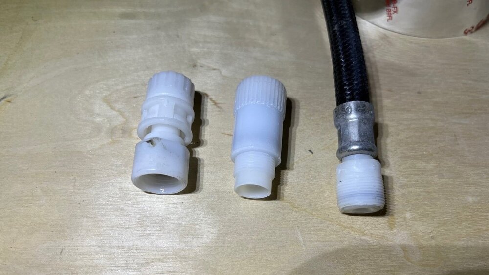

Bill, your first guess was the charm. At first i could not even see that connection, as in our hull it is right behind the cabinet crossbar. I could turn it 2-3 turns with just my fingers. I pulled it out to make sure the o-rings were good. It's an odd little part, combination restrictor and back-flow preventer? But it seems like it works the wrong direction. Not sure, I was getting tired when I finished. Next chance to work on it will be Tuesday afternoon.
The large threaded nut on the p-trap was also loose enough to move by hand. I was hoping to remove that to clean since it flows very slowly as compared to the bathroom, likely food gunk. Thoughts on cleaning that?
