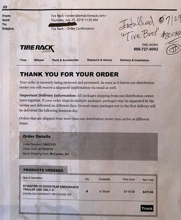

9 hours ago, rideandfly said:
Goodyear Endurance ST tire made in USA is a great quality trailer tire.
It's about the only trailer tire (ST) made in the USA! Put a set on my flatbed trailer 5 years ago. When I noticed the price today, I was like, What??? Just the cost of the today's economy. I'm going to have leave these on 10 years vs. 7! We only use it on slow roads around the county to haul dirt bikes, or an occasional trip to Lowes or Depot, low miles, keep them covered. Size on mine a little smaller. That would have been +$10 back then. Wow, by the time I need new ones they'll be $300 each!
Edited by jd1923
  • Sad 1
Yep, inflation at work!
Paid 155.00 last March through Wally World and quote today is 190.00.. Almost 22% increase in just over a year...
