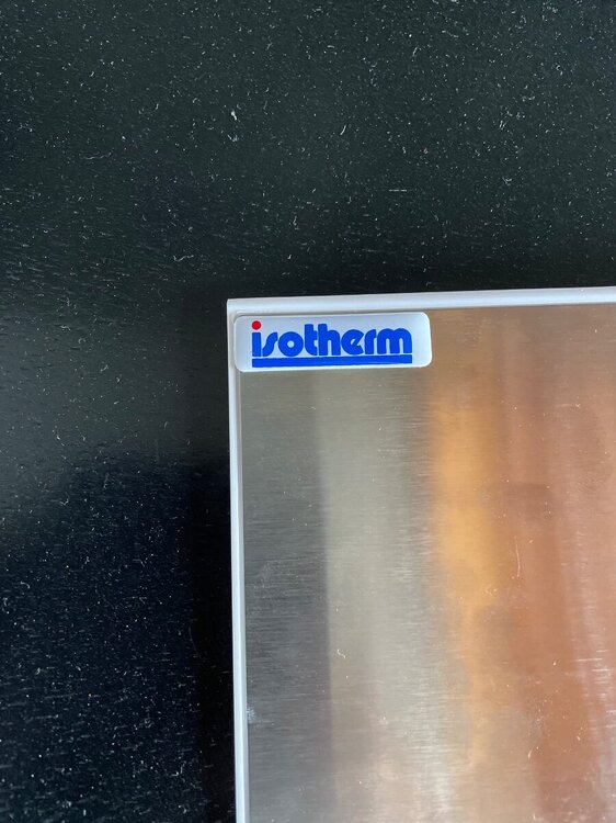

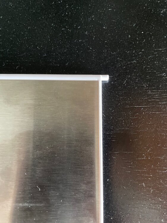

Has anyone else broke the tip off the freezer door?
How did you fix it?
Unbroken side
I bought a new door. If your fridge is a cf130, same door as my truckrfridge tf 130. Same puny pins. I broke mine a few years ago because I tried tp close it with too much frost buildup.
Part is readily available,  and install is about 1 minute.

Where do I find out the model of my fridge?
Measuring my door, it seems to match this door.
SGC00294AA Isotherm Elegance Cruise Evaporator Freezer Door Replacement (pantherrvproducts.com)
We also have a 2023 LE2, model# is next to the light switch, should be CR130EL
