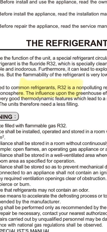

rideadeuce Posted June 18, 2024 Posted June 18, 2024 (edited) 5 hours ago, Ronbrink said: According to product specifications, the GREE and ECO-COOL both use R410 Not according to the Eco Cool/Gree user manual. ECO-COOL_Users_Manual.pdf Am I reading this wrong? Edited June 18, 2024 by rideadeuce 1 - Mike Brentwood, TN - 2018 Elite II - Spirit of Adventure Hull #308 - 2016 Toyota Tundra Limited 5.7L Class IV hitch with 12k lb coupler, Weigh safe adjustable trailer hitch, Dobinsons HD 2in Leaf springs, Timbren bump stops, Dobinsons 3in coilovers and UCAs, Mechman 370 amp HO alternator. Oliver upgrades: Starlink, Cradlepoint cellular modem, Victron Multiplus II 12V 3000W, Ekrano display, Orion XS 50amp DC/DC charger with Anderson connections, Toshiba 6-in-1 Microwave oven - air fryer combo, Atmos 4.4 15k AC/12K Heat pump, Nova Kool 5810 fridge, Epoch 460aH x2, 520 watts solar on top, Custom aluminum bicycle rack, Alcan Springs, Bulldog shocks, Falken H/T02 tires, Seabiscuit Metal Designs front storage box and moose rack.

jd1923 Posted June 18, 2024 Posted June 18, 2024 36 minutes ago, rideadeuce said: Not according to the Eco Cool/Gree user manual... I read on the Sprinter Forum that the Gree Eco Cool used to be R-410a but switched to R32. I could not find a Gree on Amazon, but Tosot was there. Note this listing states R-410A, so be careful with any online purchase. It appears as @Ronbrink stated R32 is preferred/more efficient, less battery amperage. Does anybody understand the relationship between Dreiha Atmos 4.4, Gree Eco-Cool and Tosot? Amazon.com: TOSOT GO COOL RV Air Conditioner 15000 BTU, Non-Ducted Camper Rooftop AC Unit with Heat Pump, High-Efficiency EER 8.5, WiFi and Remote Control : Automotive Chris & John in Prescott, AZ | 2016 EII #113 | '01 Ram 2500 Cummins!

rideadeuce Posted June 18, 2024 Posted June 18, 2024 (edited) 42 minutes ago, jd1923 said: Tosot was there. Note this listing states R-410A, I agree you must be careful buying on Amazon but the current Tosot AC on their website is R-32. Probably the best thing to do is buy direct or from official distributors (Atmos 4.4) like the one in Indiana that I believe @Ronbrink is purchasing from. There are other option though if you do your homework and are willing to take the risk to save a little money. But I do believe they are all the same units manufactured by the same company. I think the 410 use is in older manufactured units. Would be my guess. Anyway, hope to see the R-32 version in a Oliver soon! Best, Mike Edited June 18, 2024 by rideadeuce 2 - Mike Brentwood, TN - 2018 Elite II - Spirit of Adventure Hull #308 - 2016 Toyota Tundra Limited 5.7L Class IV hitch with 12k lb coupler, Weigh safe adjustable trailer hitch, Dobinsons HD 2in Leaf springs, Timbren bump stops, Dobinsons 3in coilovers and UCAs, Mechman 370 amp HO alternator. Oliver upgrades: Starlink, Cradlepoint cellular modem, Victron Multiplus II 12V 3000W, Ekrano display, Orion XS 50amp DC/DC charger with Anderson connections, Toshiba 6-in-1 Microwave oven - air fryer combo, Atmos 4.4 15k AC/12K Heat pump, Nova Kool 5810 fridge, Epoch 460aH x2, 520 watts solar on top, Custom aluminum bicycle rack, Alcan Springs, Bulldog shocks, Falken H/T02 tires, Seabiscuit Metal Designs front storage box and moose rack.

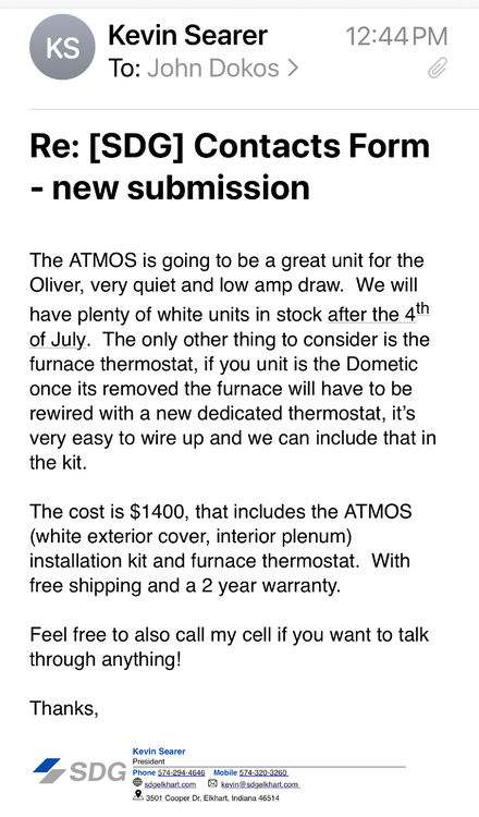

jd1923 Posted June 19, 2024 Posted June 19, 2024 Update from SDG on the Atmos 4.4 -- 1 Chris & John in Prescott, AZ | 2016 EII #113 | '01 Ram 2500 Cummins!
jd1923 Posted June 19, 2024 Posted June 19, 2024 Follow-up from Kevin and SDG -- 2 4 Chris & John in Prescott, AZ | 2016 EII #113 | '01 Ram 2500 Cummins!
