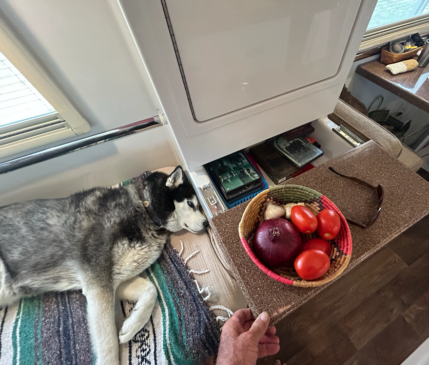

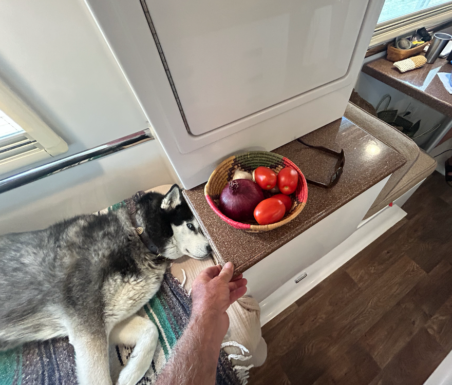

We removed the velcro under the pantry countertop and replace it with drawer slides that "soft close" - I'll do the nightstand top the same way after we're back home from this excursion...
Now you see it....
DVD storage above
Now you don't...
Oscar's not impressed at all!
