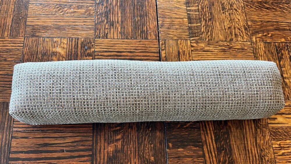

jd1923 Posted July 15, 2024 Author Posted July 15, 2024 On 7/14/2024 at 9:20 PM, SeaDawg said: If you never hit your head, let it go... Expand It's funny that in a year of use, 30+ days camping, and so many ins and outs doing repairs and mods, at 6'2" I never hit my head because of the way I carefully enter and exit. This weekend doing my fridge fan mod, I banged it pretty good! You can see in the picture; it's not even shaped squarely anymore. It's a big 3x3" wide, old foam on old plywood, not worth the time to reupholster. I'm thinking something semi-round and thinner like 2x2" wide, a cushion but not something upholstered. Still wondering if anybody had else replaced theirs with something else? Chris & John in Prescott, AZ | 2016 EII #113 | '01 Ram 2500 Cummins!

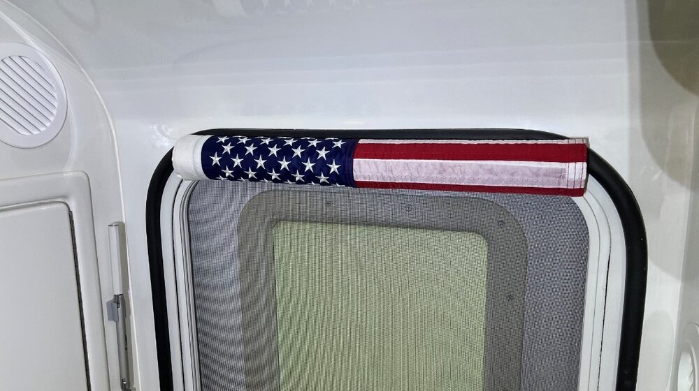

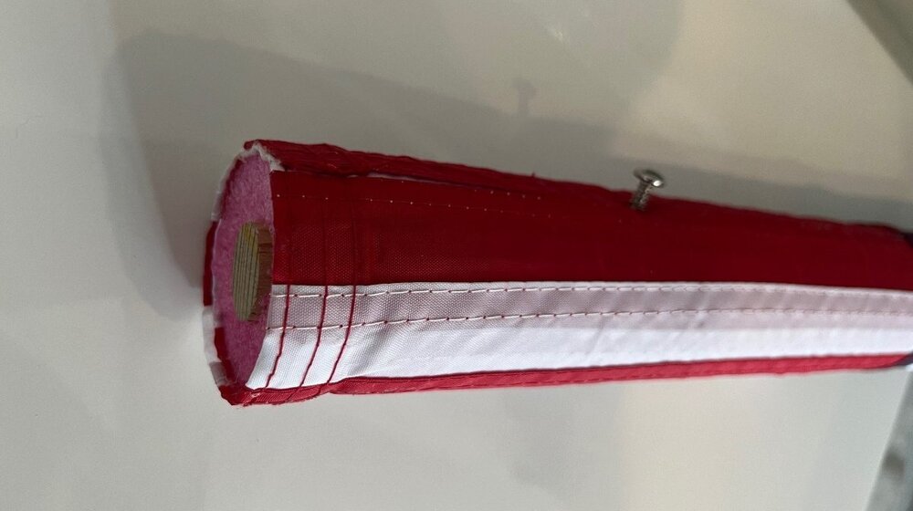

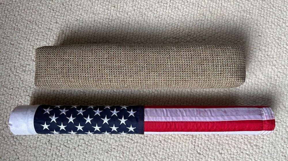

jd1923 Posted July 25, 2024 Author Posted July 25, 2024 On 7/15/2024 at 5:46 PM, SeaDawg said: You could wrap a chunk of pool noodle or... Expand I had this thought too and then there I was in our local Walmart, a box full of thin noodles! Chris is creating an Americana-Patriot theme for our interior decor, and she came up with the flag idea! I found a cheap 18" wide poly flag on Amazon. Had an old broomstick in the shed. Cut it to size and just a little sanding for the correct diameter. Used 3M spray glue and rolled it tight. Can't drill cloth, so first I used a needle tool to puncture and a center punch to widen the hole. Measured the first hole and mounted it to get the exact point for the second hole, two screws go through the wood center. It sure beats the ugly old burlap brick! Turned out pretty good. When I find a quality cotton flag, I'll do it again in a couple years. I have enough leftover noodle! 🤣 2 Chris & John in Prescott, AZ | 2016 EII #113 | '01 Ram 2500 Cummins!
