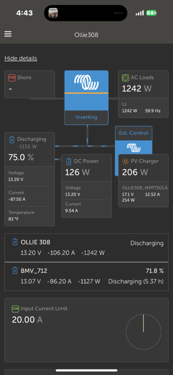

1st Road test: spoiler alert, I am quite impressed after 1st night with the fan running and the first trip with the AC set on AUTO AC at 70 degrees F.
When we left my dad's house in SW MI the temp was 66 degrees.  Epoch batteries 99%
By Mid day temps had climbed to 84.
Pulling into our house south Nashville 8 hrs later it was 91 degrees outside and the Epoch batteries showed 75% with a 87.5 amperage draw on high AC output.
I know it is a lot different than coming up from FL but still pretty happy with the results. Cabin temperature never got above 72.

The highest amperage draw on high that I have seen is still under 90 amps

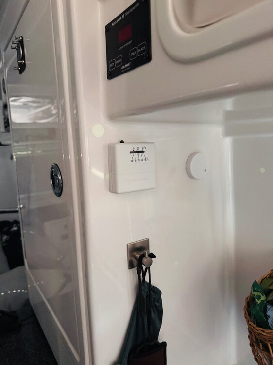

Took off the back plate for T-stat. Looks better.

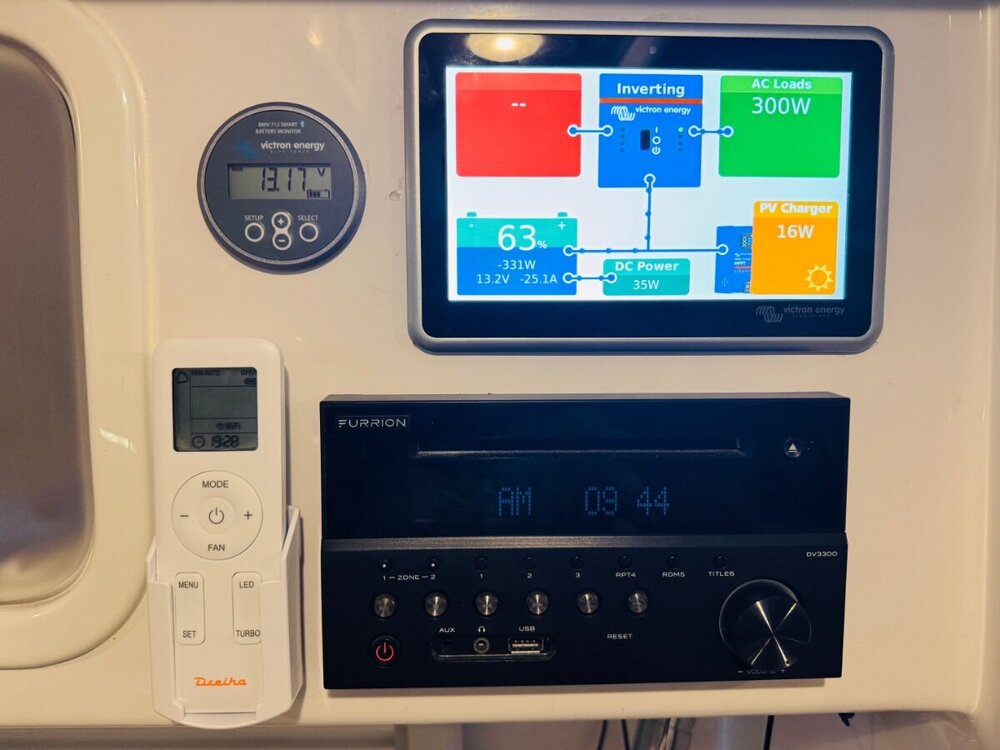

The remote is nice but still figuring it out. Comes with a mount.

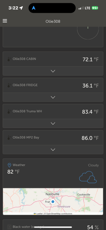

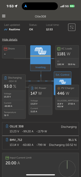

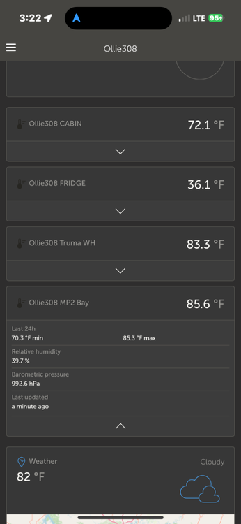

Screen shots riding down the road at different times during the drive home.
IMG_9704.thumb.PNG.eab27963175eea8ea04c778ea2c27e4e.PNGIMG_9712.thumb.PNG.60ff295b05c1aa139339162fb7690e20.PNGIMG_9707.thumb.PNG.5f7c4ffe27bc86b474a76d54415466c3.PNG

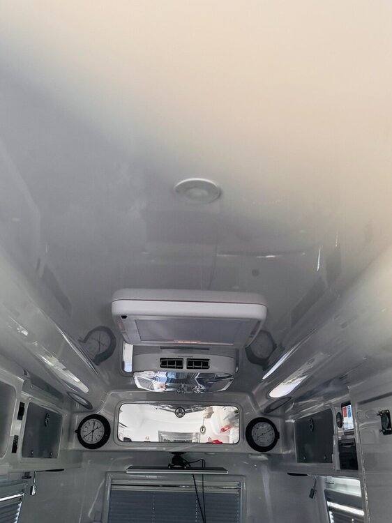

@rideadeuce: Looks great, Mike!   OBTW:  we love your ship's clock and humidity(?)/barometric(?) gauges on the rear bulkhead - nice touch!
