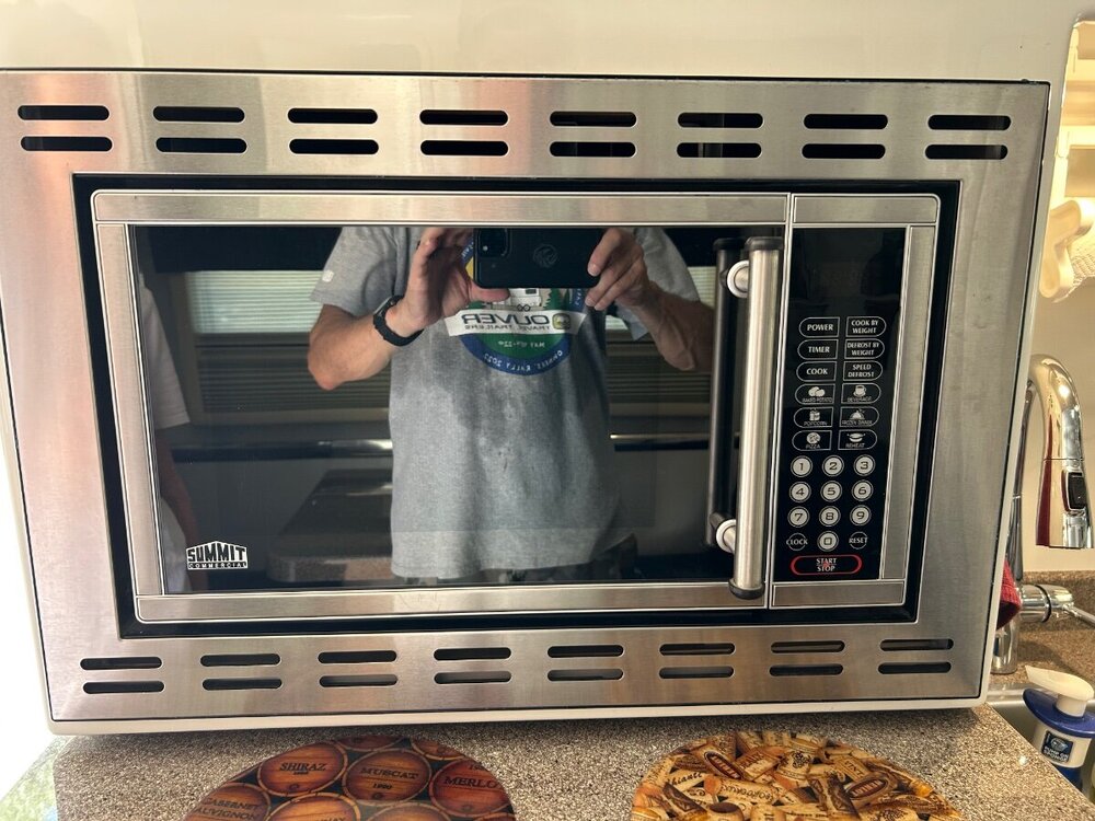

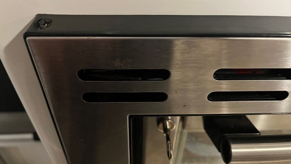

If your goal is only to secure the microwave vs. removing it, likely you can leave the bezel as-is. If it needs major surgery, the bezel is held by four (4) screws. See the first picture, all 4 corners are the same. The two screws in the bottom corners are not easy to remove. Pull the countertop first to give more room and not to damage it and you will likely need a right-angle Phillips to access these. I have one that drives off a 1/4" impact that worked well.

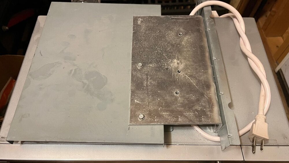

Honestly, I could not believe this installation. More of a backyard mechanic rig vs. a factory installation. Empty the cabinet above, pull the rubber lining and you should find 3 screws (see three holes in the metal plate, second picture).
It's likely these have loosened. If so, remove the loosest screw, keeping the others in place and work to replace one at a time. However, they may all be gone. If you're lucky you could install screws of same length, one size up or finer threads to hold. If they are all disconnected, you will need a long thin punch or a nail to something to realign the holes.

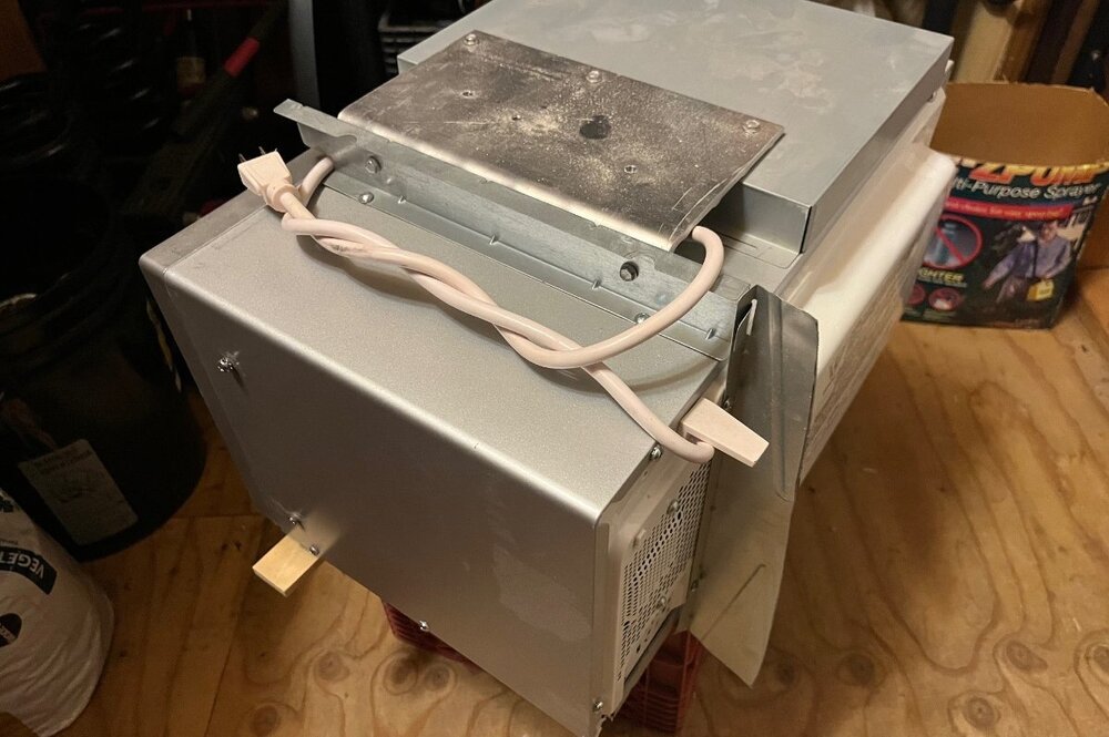

My guess is the top mount is the issue and remember to check this before messing with the bezel. I supplied two more pics so you can see the other sides. I don't remember any other screws holding it in place. The sheet metal in the rear just rests against the curved cabinet. Note the wood strip along the bottom-front which is designed to keep the microwave from sliding front to back. This should get you started, and you'll likely get it secured quickly. Best wishes, JD

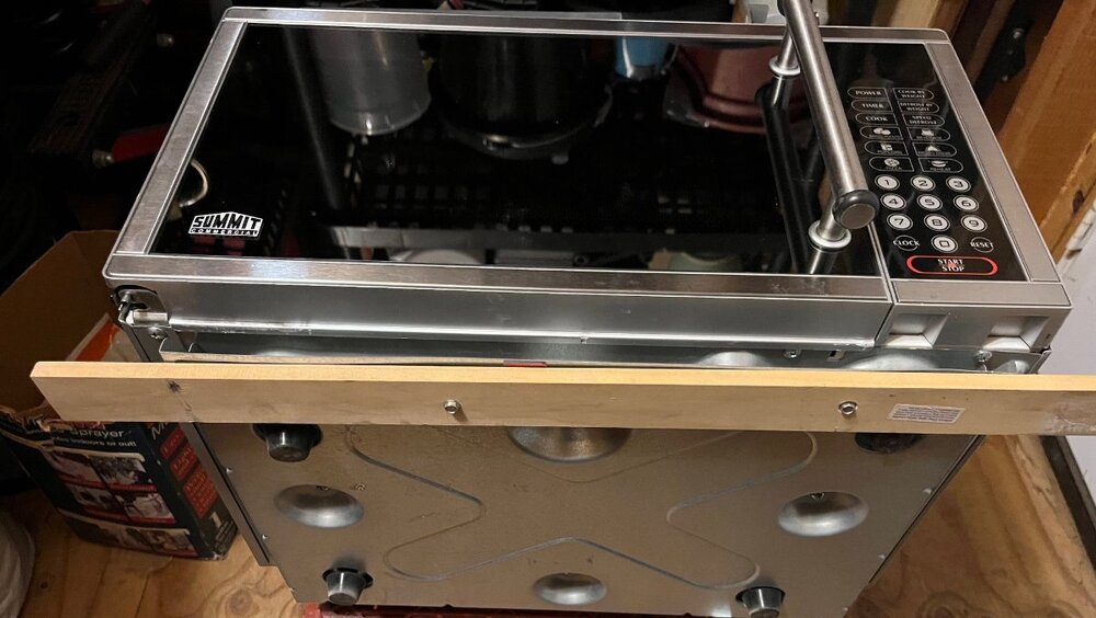

Here are a couple more that show the microwave without the "brace" on top.
In the case of my microwave - the top brace was never installed during manufacturer such that the only thing holding it in the cabinet was the trim frame.  Obviously the trim frame didn't hold it in place very long and with the help (via phone) I added the top brace.
Unfortunately, even the top brace didn't hold the microwave securely - perhaps it is all those dirt roads I travel looking for trout that combine to shake it loose.  The oven bounced around in there such that the "feet" on the bottom actually eventually broke off!  In any case, as long as you have things apart I would highly recommend that you add additional bracing between the cabinet and the microwave such that the oven is basically wedged into the space and does not move with or without the brace.  I simply used scrap pieces of wood for this purpose.
JD and Bill, thanks!  That’s what I needed.  As I mentioned the four screws around the frame aren’t doing anything anymore, the two bottom screws are broken and the frame is broken in each corner of the top screws.  The MW is a little loose so I imagine the fasteners in the overhead are not tight.  I’ll work on it next week as we pack up for the rally at Inks Lake.  I’m tempted to just replace the whole thing with something else.  Mike

I'm sure you noticed Bill's second picture to see how the frame is attached to the microwave. When the top mounting screws are removed you can pull the MW out enough to remove these. I forgot about these mounting tabs because when replaced our MW with the Emeril Air Fryer I cut off these tabs as they would have had issue with the heat of the oven.
Given the top mounting screws are in place, remove them to slide the MW out a few inches to access the side screws. It appears you will have to remove the frame and epoxy it, do whatever so that the 4 corner screws will hold again. I don't imagine OTT still has this part but maybe.

Nope - neither Oliver nor the MW Manufacturer has it.  My frame was/is cracked like Mikes.  Once I got the MW secure inside the cabinet then I drilled two new holes in the face of the frame (midway down on each side), put a long stainless steel screw into the wood behind it and used black decorative caps on the screw heads in order to make it look a bit nicer.

Yep - I drilled those two holes as per the instructions from Oliver Service.  Not sure why you have three versus my two and I didn't even think to add a third.  I don't remember how many pieces of wood I put into the space to secure the MW but I did make sure that the final pieces I put in needed to be "tapped" into place for a tight fit.
