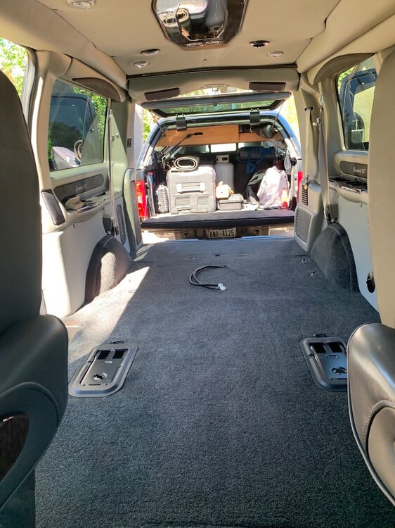

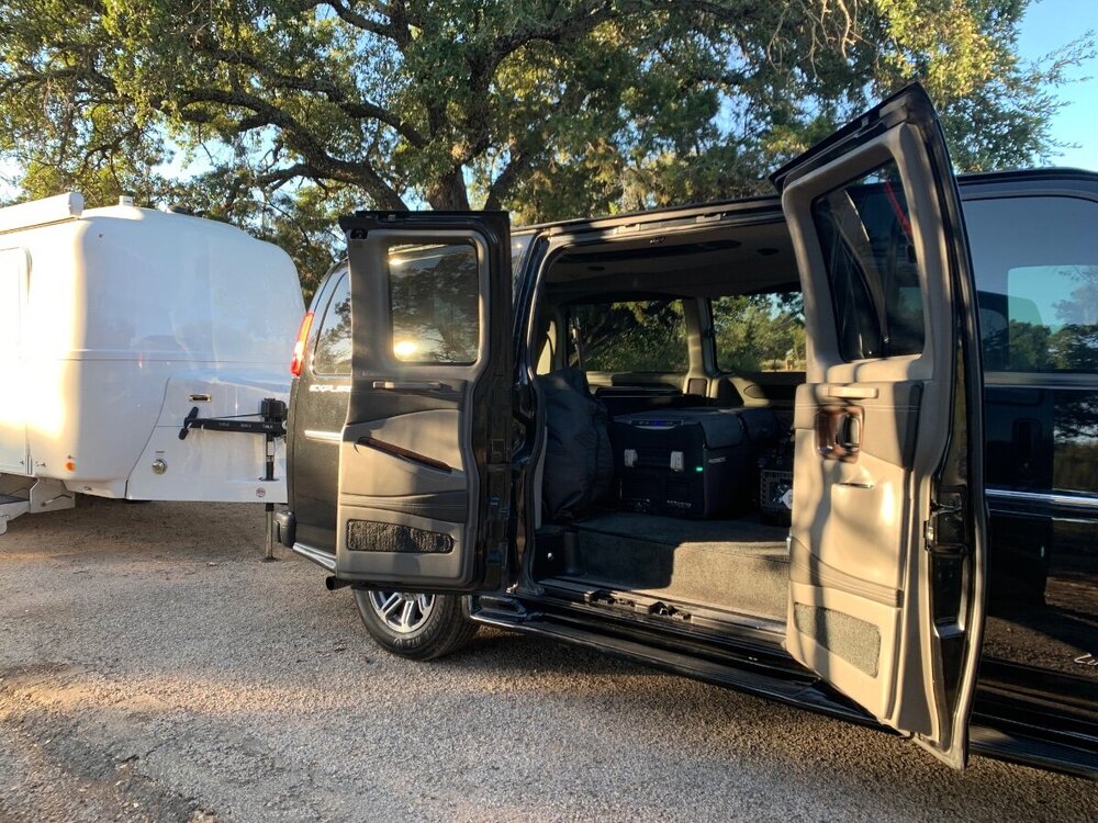

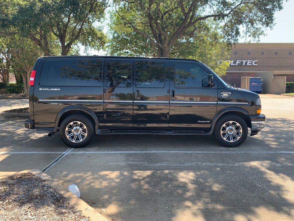

After several months of researching a suitable replacement TV, a van was decided to be our best choice based on perceived criterium, ie engine/drivetrain, cargo/tow capacity and tongue weight requirements for our OLEll and style of camping. The former 2012 Silverado 1500 4x4 was reaching ‘retirement age’ and I’ve been pushing its limits, regarding carrying capacity, for a couple of years. I will acknowledge up front that we are not minimalist! That said, this Explorer conversion van well exceeds my expectations in both spacial and towing considerations, as well as comfort and convenience. BTW, I told my wife “remind me to never buy another tow vehicle days before a planned trip!”

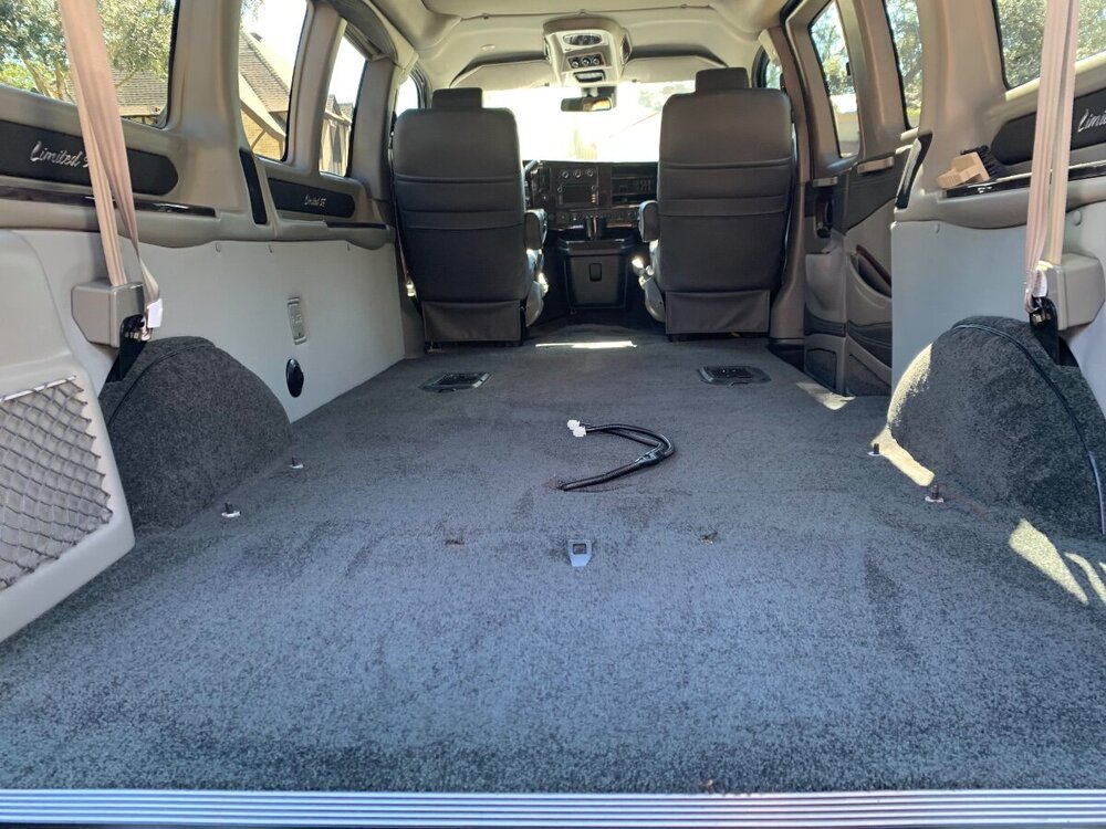

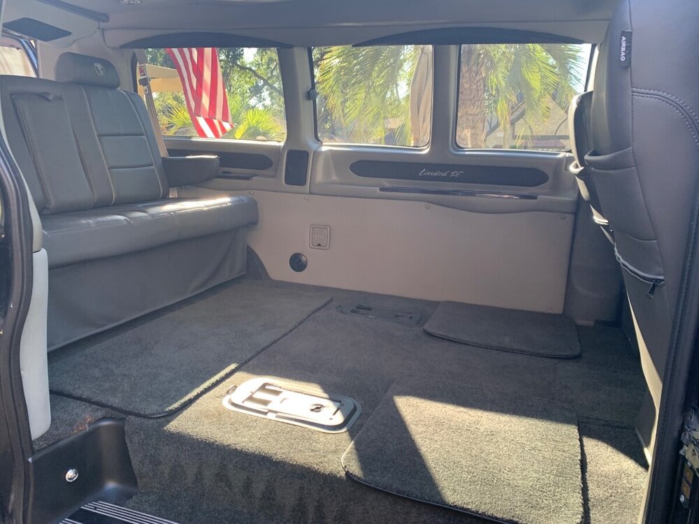

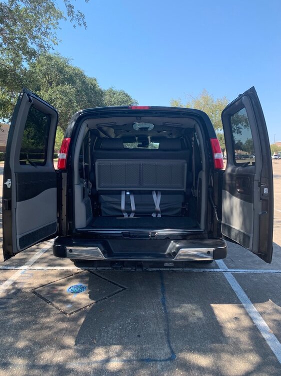

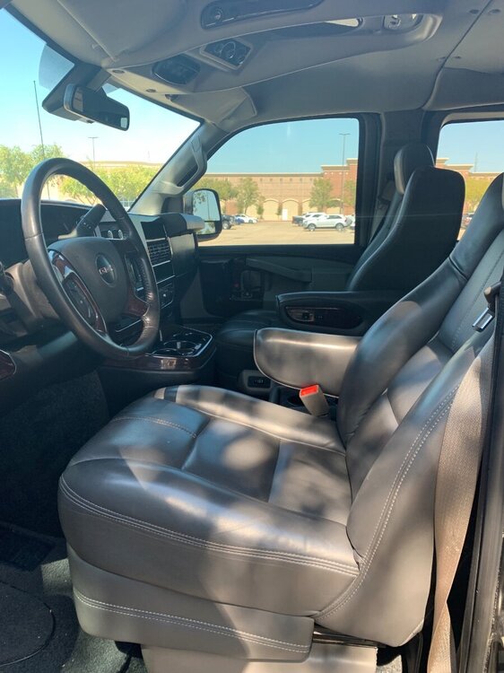

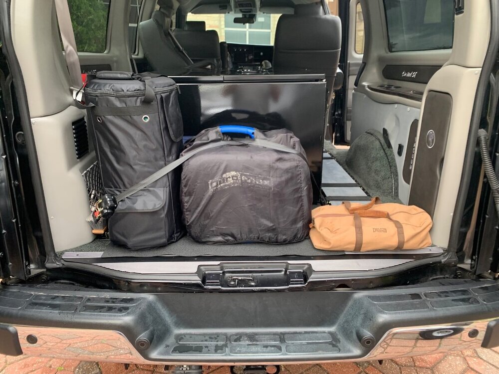

Although ‘well appointed’, the passenger seats had to go; at least when towing our Oliver. The two second row captain’s chairs are easily removed via a release mechanism from the floor mounting base for occasional use, as needed; the third row couch/reclining bed not so much and will go to storage.
By removing the passenger seats, I now have 10’ of open cargo space from the rear doors to the front seats; the Silverado’s bed only measured 5’8”, plus limited space in its back seat.
Having double doors on both side and rear of the van vastly improved access to the cargo area.

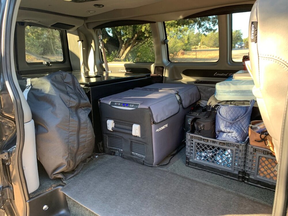

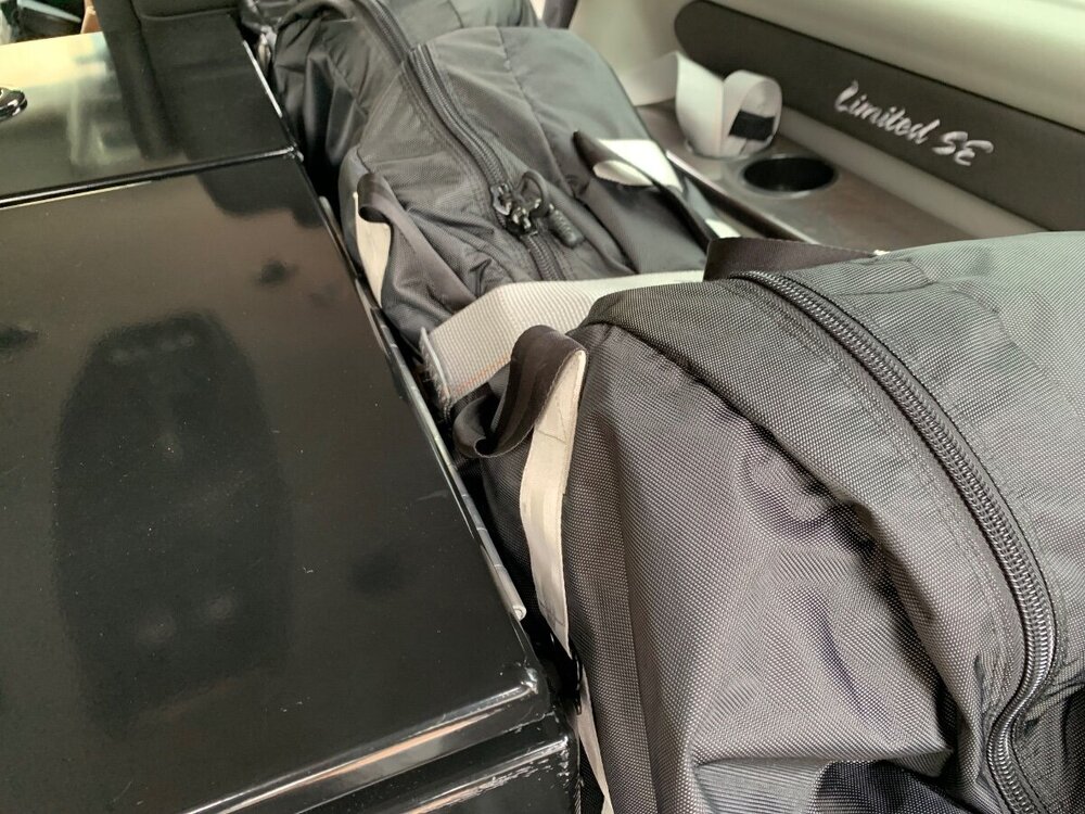

The two vehicles were positioned end-to-end to facilitate easy cargo transfer for organizational purposes. Ultimately, two storage boxes were acquired to safely stow much of the cargo; specifically, underbody tool boxes. Yep, delivered one day before our departure to the Texas Oliver Rally at Inks Lake SP, what was I thinking!
The boxes are serving their purpose by providing secured organization of supplies and gear, with ample room for our folding e-bikes, Dometic fridge/freezer, portable power station, generators, spare 30 lb. propane tank and a couple of small bins.

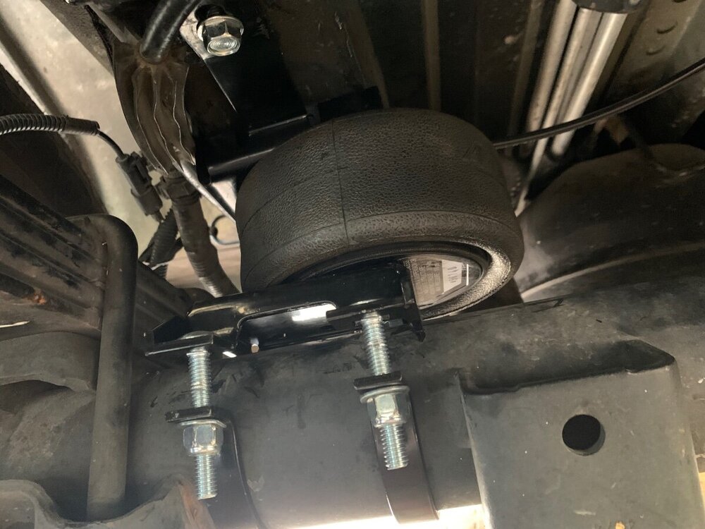

Yesterday I installed new AIR LIFT LoadLifter 5000 Ultimate Adjustable Air Springs on the Savana. I knew prior to departing for the Texas Oliver Rally that my receiver hitch was an inch shy of the recommended ball height with the trailer in tow, and that was after maxing out the pin hole height adjustment. As illustrated in the first picture of this post, the van and trailer were ‘well poised’, but once loaded with cargo for the trip there was a slight squat. Regardless, it was always my intent to install airbags for ease of adjustment in varying conditions. Today I will remove the AIR LIFT pump assembly from my former TV and reinstall on the Savana. Problem solved! As a side note, I really liked being able to inflate the airbags, via a remote, to tilt the Oliver upward when dumping the tanks and hopeful this new setup will provide like benefit.

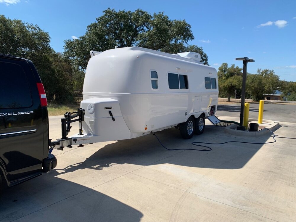

Inks Lake SP did it right with their new dump station! At some facilities however, raising the trailer’s nose is a must to fully empty the tanks. Did someone say ‘airbags’?

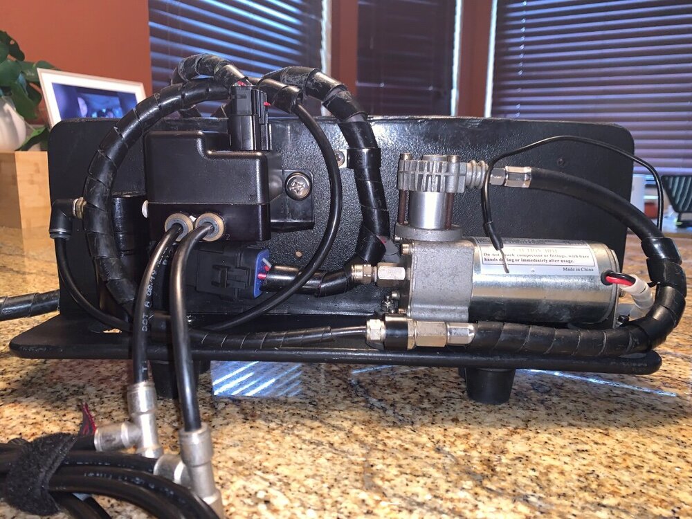

Well, upon removal of the AIR LIFT pump assembly from the Silverado a few days ago, I realized that system would require a reconfiguration to better serve the selected Savana mounting position. Yesterday said pump and new airline hoses were installed. Today the wiring harness will be routed to the engine bay to complete this project. BTW, the original AIR LIFT air springs remain on the Silverado and can be individually inflated with the Schrader Valve terminated supply airlines left in place.
Driver’s side airbag at 0 psi; 5 psi minimum upon install completion, as recommended to prevent damage.
AIR LIFT pump assembly readied for install.
Pump assembly with airlines, wiring harness and remote control.

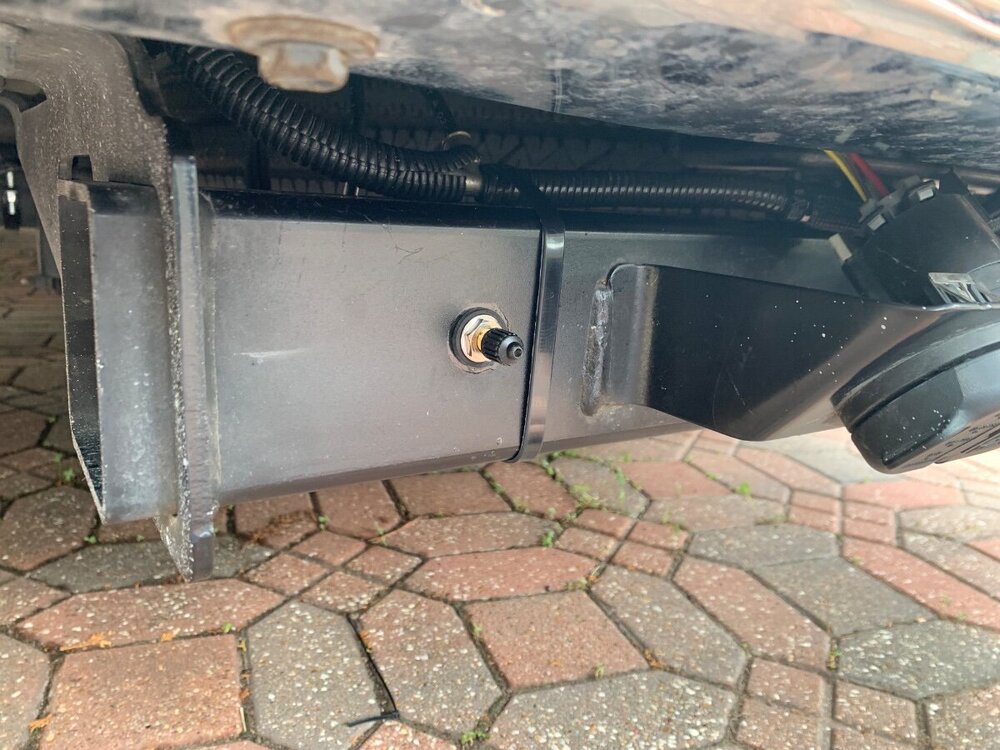

Pump assembly securely mounted atop the trailer hitch receiver. Once the wiring harness is connected, care will be taken to further protect with wiring loom and mounting straps tidied up.

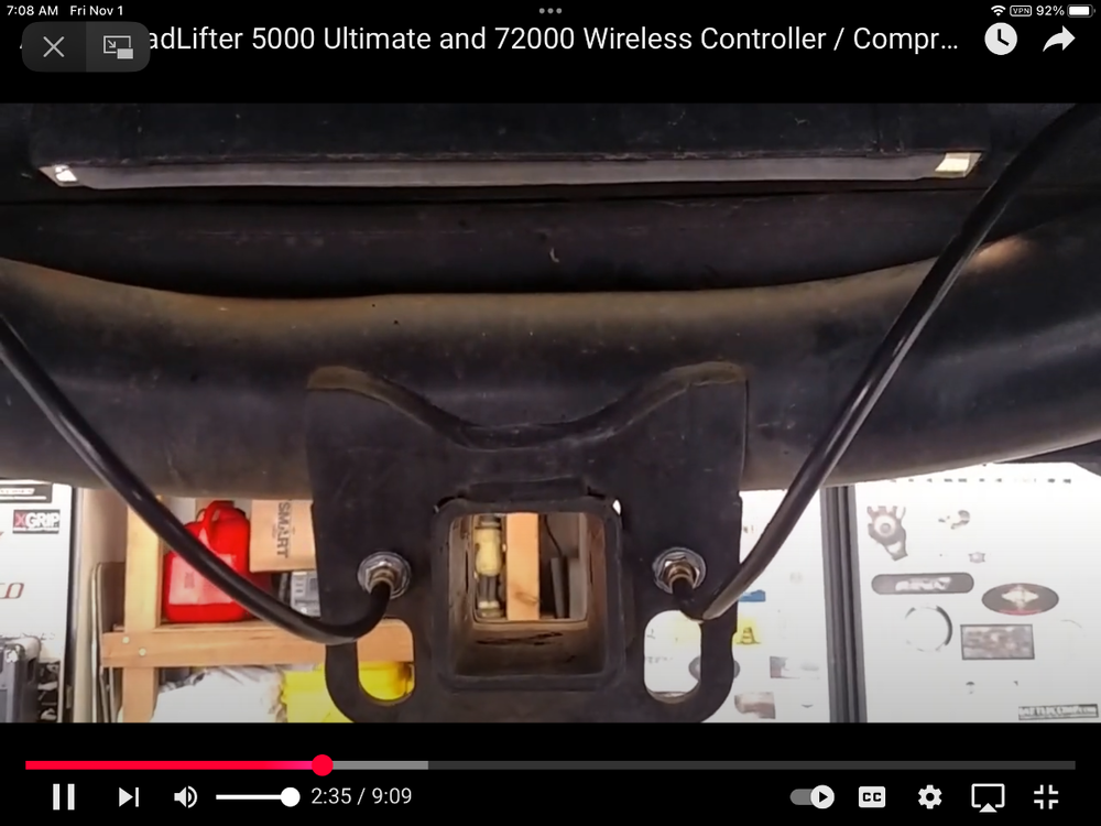

Potential location on backup fill ports in the event of a pump failure (screenshot taken from a YT video).

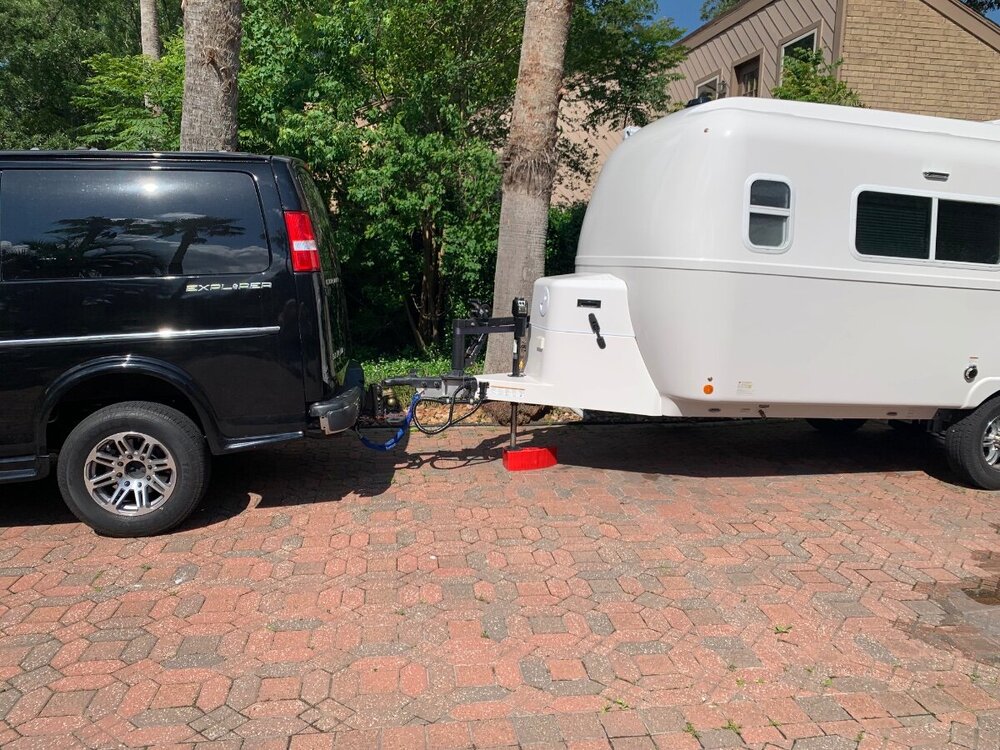

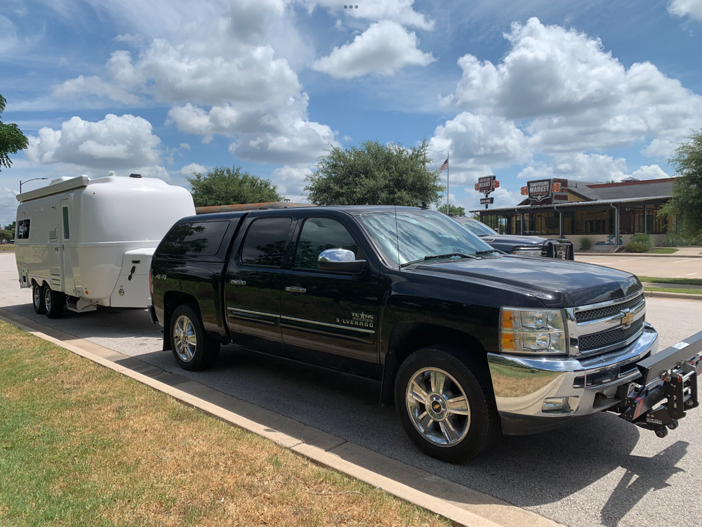

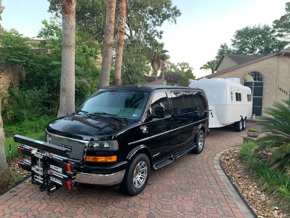

A change in vehicle type, but not in looks; truck vs van.
2012 Chevrolet 1500 Silverado 4x4, 144” wheelbase.
2019 GMC  2500 Savana Cargo Van, 135” wheelbase.

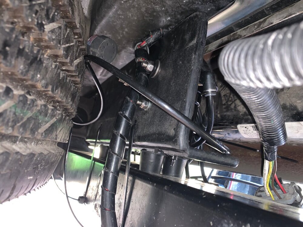

Alternate mounting of said ports from the aforementioned screenshot. Holes drilled (3/8” front, 5/16” rear) through the hitch receiver tube were made for adequate securement of these Schrader Valves once exposed metal was painted and allowed to cure.

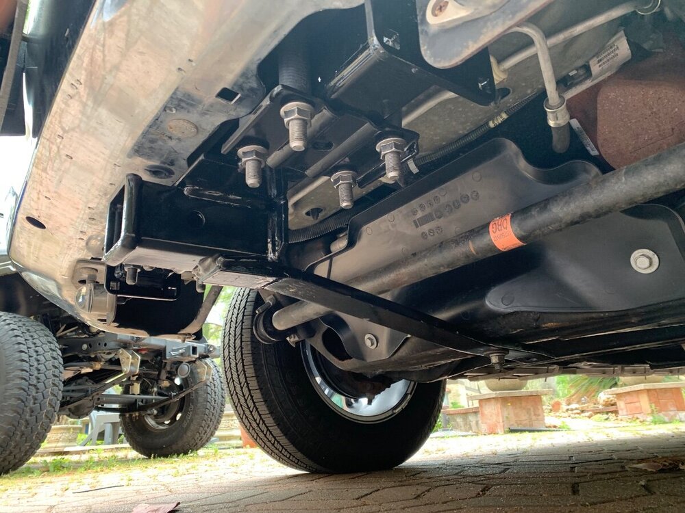

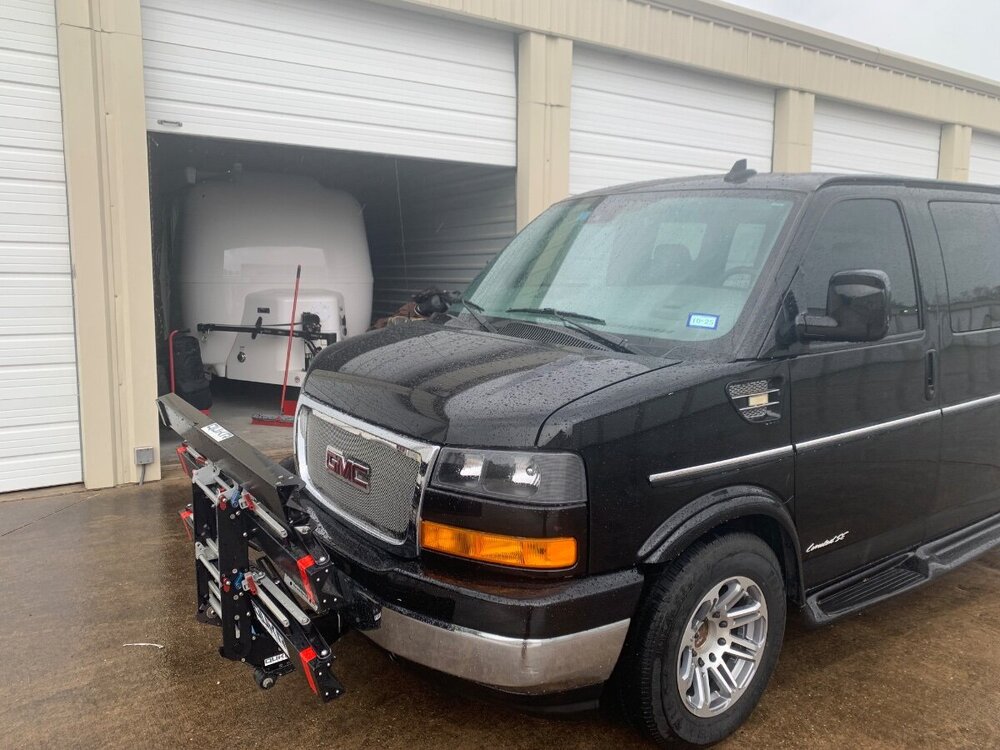

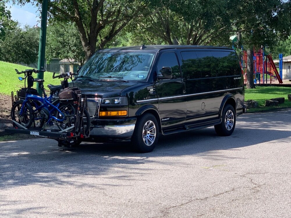

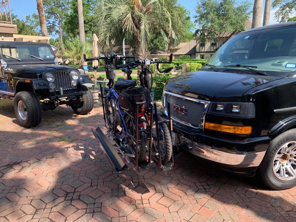

A few days ago I completed an installation of a front receiver hitch on the Savana. I previously installed same on the Silverado, specifically to carry a bike rack when underway for use with our folding ebikes once in camp, and liked its functionality. However, no such hitch was found available for the van and thus, removal and modification of the one that was on the former TV was in order. Once a mounting plan was devised for proper fitment and securement, necessary cutting, shaping, welding and painting was done.
Modifications in progress.
Hitch readied for install.
U-bolt and plate securement.
Front spoiler remounted with thru-hole, hitch extension installed.
Formerly fabricated roller skid plate I made to protect the bike rack got new paint job.
Savana sporting hitch/skid plate and QuikrStuff dual bike rack with ramp.

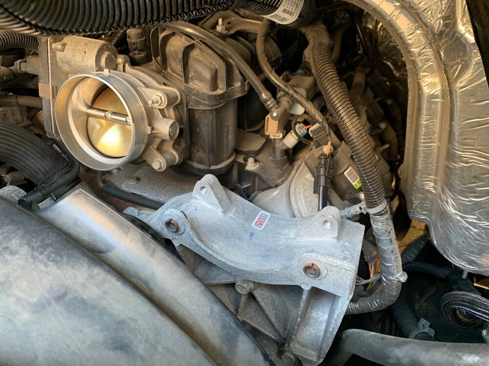

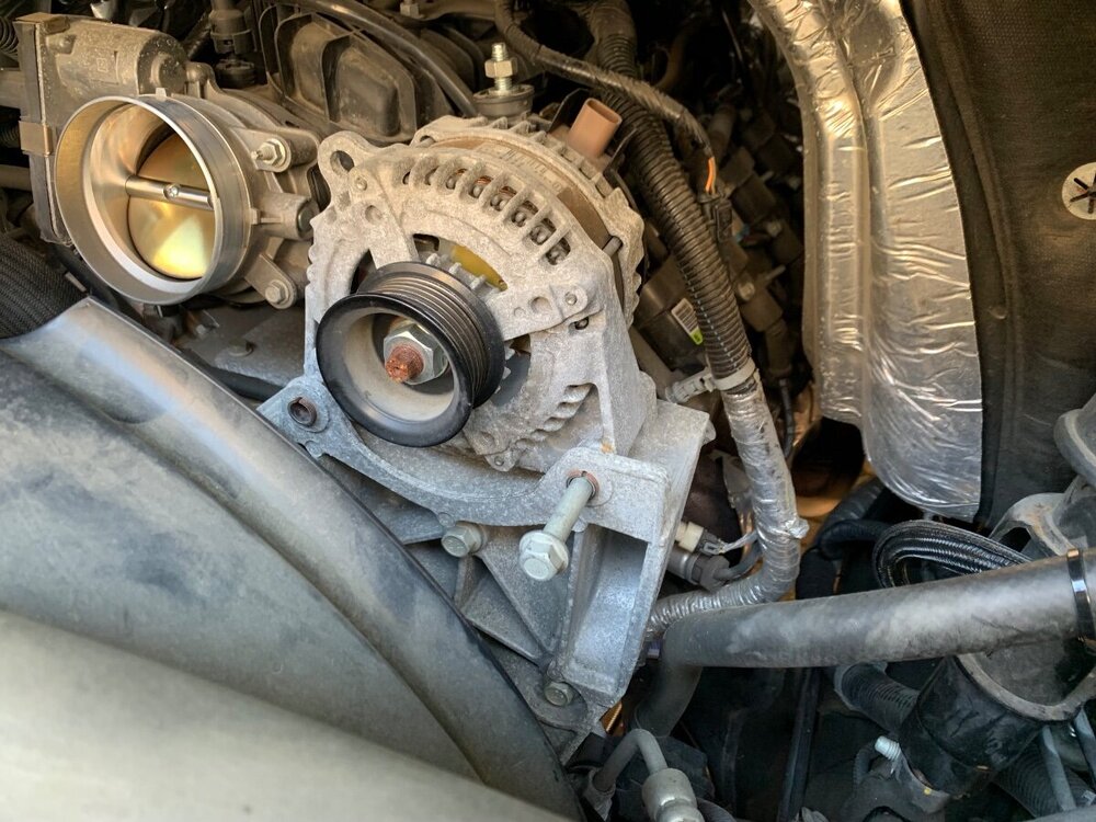

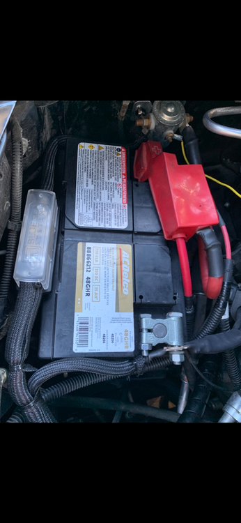

A couple days ago I successfully installed the Mechman 320A high output alternator and cable upgrades, previously on the former TV, to further enhance the Savana’s charging system. I should mention that a battery swap was done two months prior with the ACDelco top post battery a better choice for performance and reliability. Even though Mechman does not offer an alternator for the Savana, the mounting bracket and wiring appeared exactly the same as the Silverado’s; so my hopes were high that the stock 150A alternator could be replaced despite the seven year gap in year models and GMC 6.0L vs GM 5.3L engine size, respectively. Another consideration, the high output alternator requires a smaller pulley and thus, a bit shorter serpentine belt. Again, the new belt from the Silverado install was a perfect fit for the Savana.
ACDelco battery, as installed.
Removal of the stock 150A alternator in progress.
Mounting bracket cleaned and readied for Mechman 320A.
Side-by-side alternator comparison.
Mechman alternator a perfect fit. Note additional grounding cable at the mounting bolt.

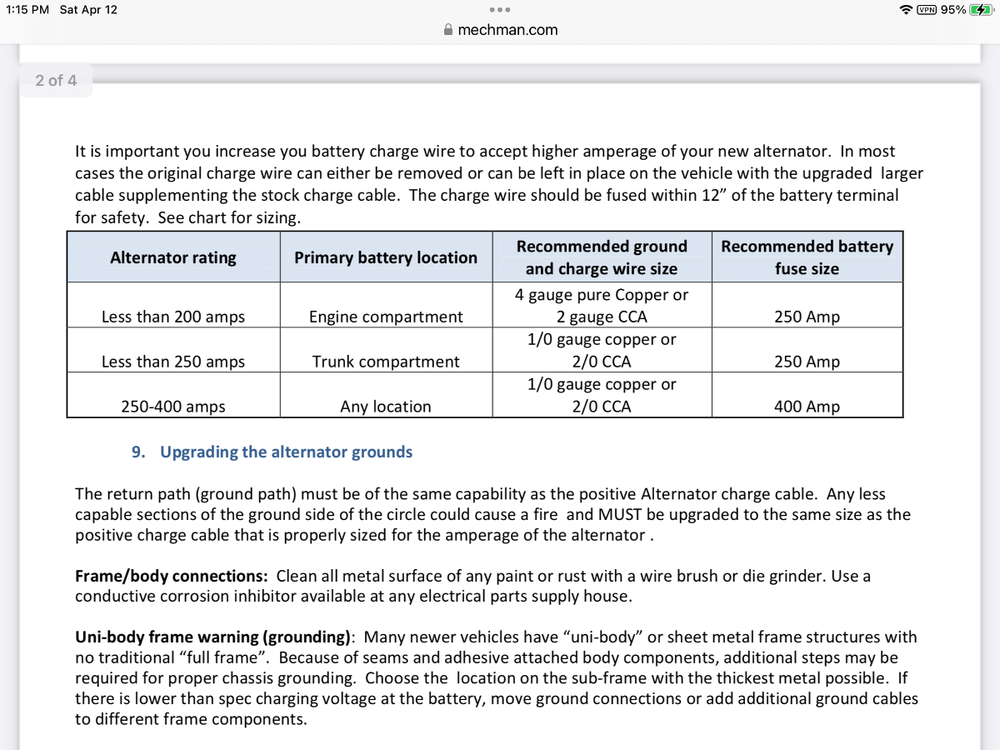

2020 OLEll, Twin, 579:
Very nice Ron! You can see the smaller pulley will spin the HO alternator twice as fast. Also, the additional ground will provide less overall resistance for your DC-DC charger!
The 1/0 Gauge ground cable (shown) from alternator mount to B- and a like size alternator+  to B+ are two of the ‘Big 3’ players recommended by Mechman with their high output alternators. The Savana already had a robust ground cable from B- to engine block to include a fine stranded braided cable split to frame for additional grounding. Would there be any benefit or need for another ground from alternator mount to body?
Your 1/0 cable is huge. I added 4 AWG B+ to alternator and B- to frame for the addition of the DC-DC charger.
An automotive alternator is already grounded through the engine and the engine has ground strap(s). My batteries only had a 6 or 8 AWG ground wire and same lighter gauge for the alternator connection to B+. Yours should be excellent as-is!
Edited by jd1923
Mechman specifies the 1/0 Gauge copper wire for ‘return ground’ and ‘alternator charge’ cables to battery with their 250-400 amp rated alternators, and a battery fuse size of 400A. They also recommend increasing the B- to body wire size, which could explain the extra wire from my previous install. Thanks again for your input!
When you word it this way, it certainly makes sense. That's a lot of amps! I upgraded the stock 130A alternator to 180A, so I figured adding additional 4 AWG cables was sufficient. The manufacturer had not suggested upgrading the wiring in their first level upgrade.
You done good! Here is an excerpt from Mechman’s Alternator Installation instructions, wherein 4 AWG is shown to be sufficient for your 180A alternator.
Edited by Ronbrink

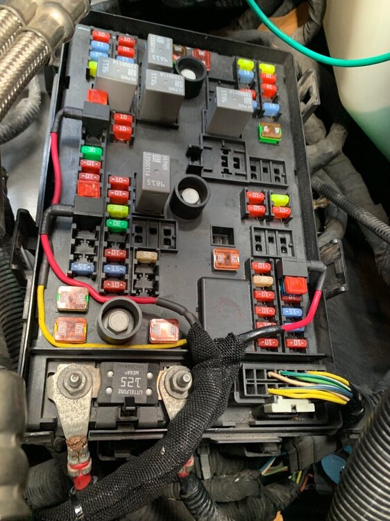

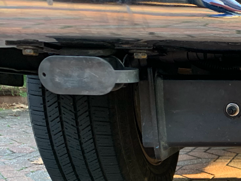

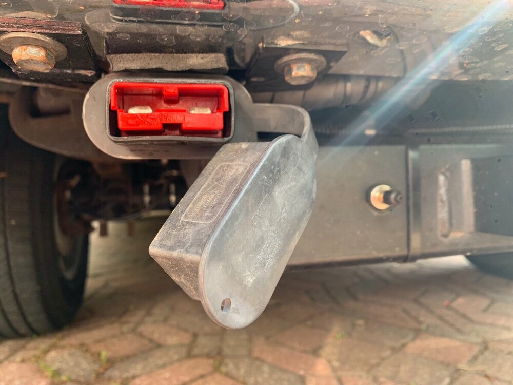

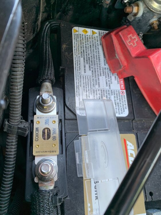

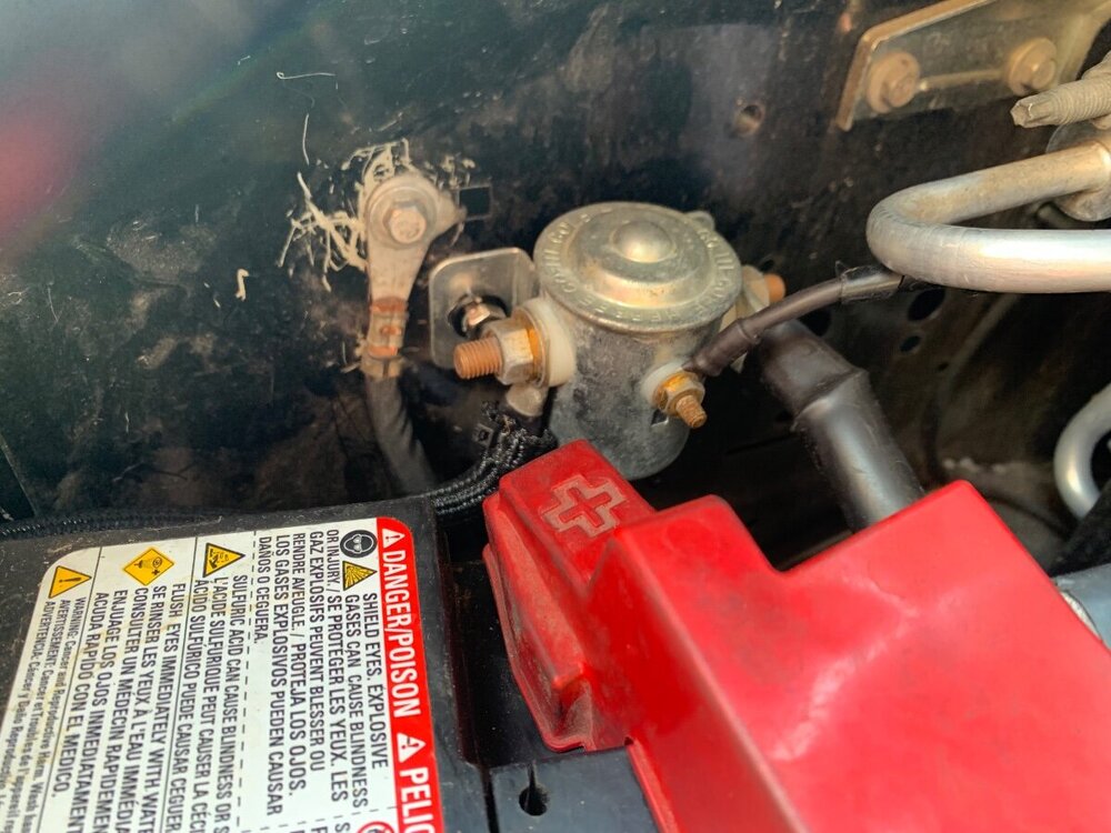

One of the last ‘must have’ transitions from the former TV to the Savana is the DC-DC charging cable setup and rear-mounted Anderson connection. The full length 4 AWG dedicated cables running from battery to rear bumper off the Silverado required no alteration with this retrofit. Admittedly said cables, rear bumper connection, a solenoid and ANL 60/fuse box were installed a few months ago, but activation was delayed pending install of the Mechman 320A alternator. The solenoid serves to energize the cable connection via a fuse tap trigger wire from the under hood fuse box and thus, requiring keyed power ignition for use as a precautionary measure.
Current fuse taps include the solenoid trigger wire, as well as one for the alternator and Air Lift power.
Solenoid and ANL fuse locations.
Rear bumper-mounted Anderson connection with Environmental Boot.

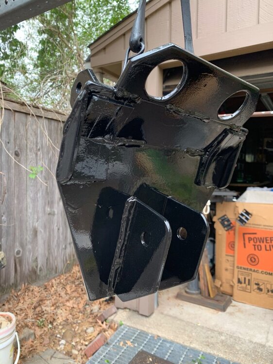

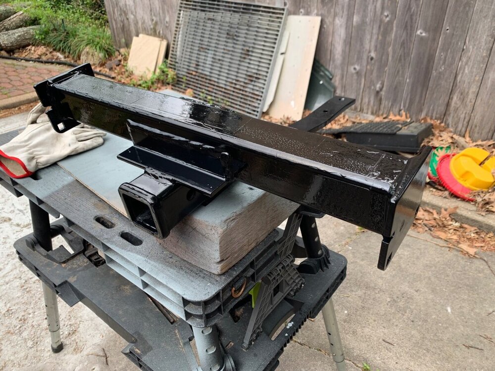

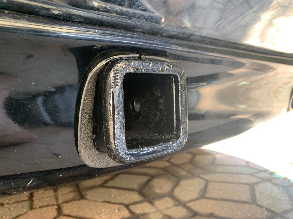

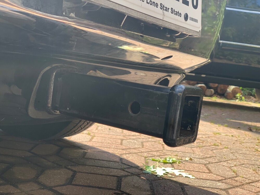

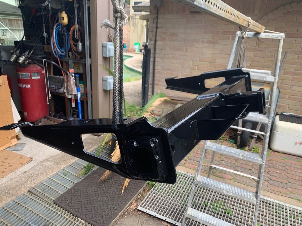

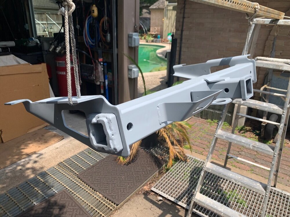

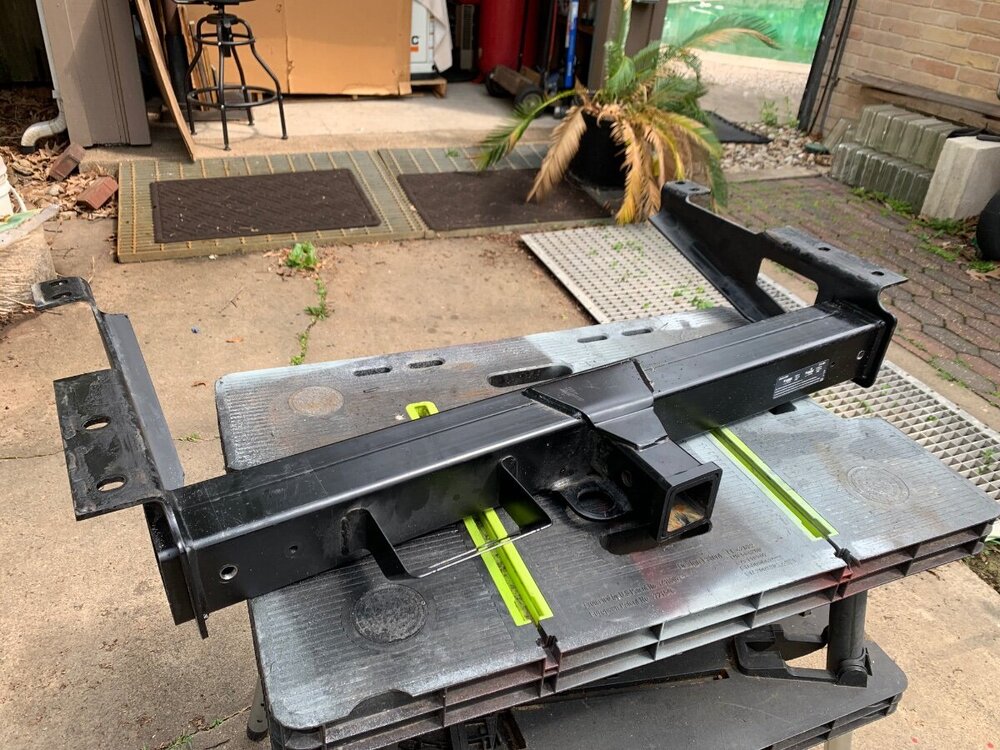

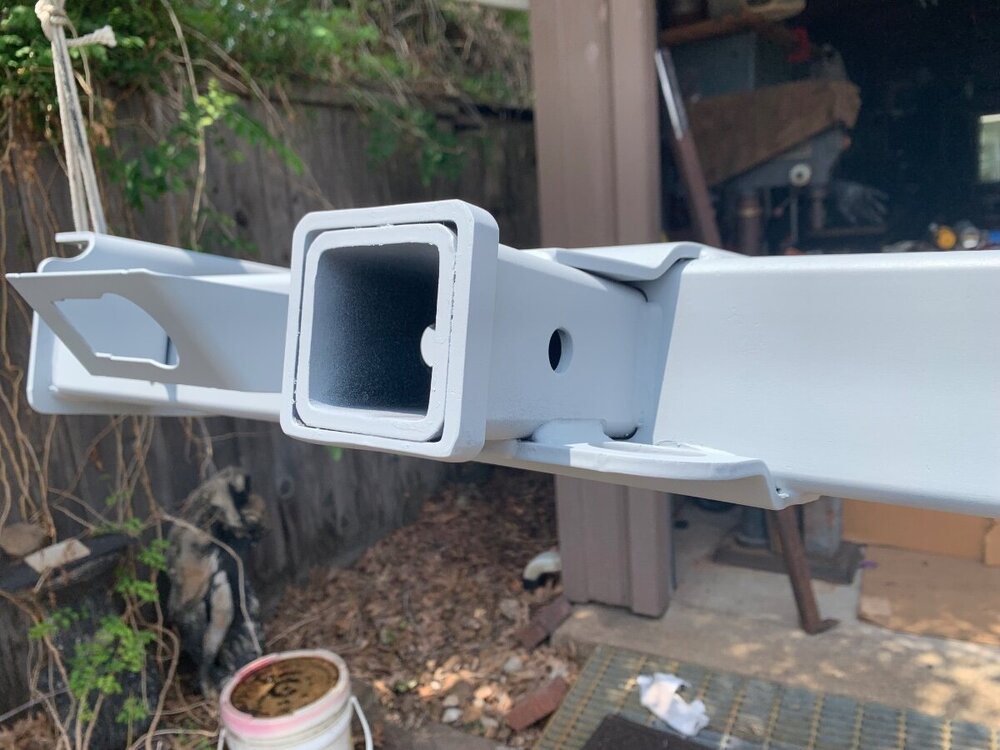

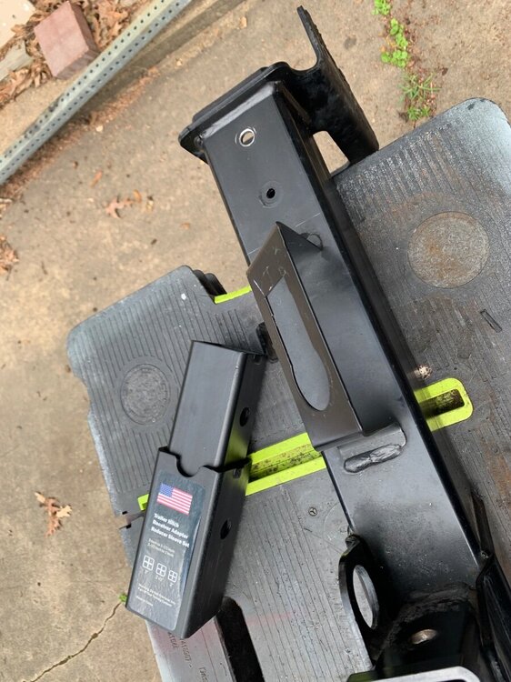

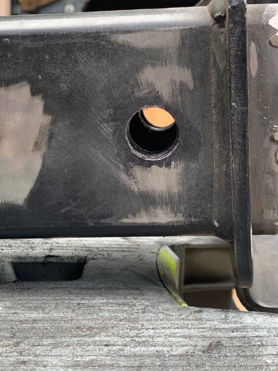

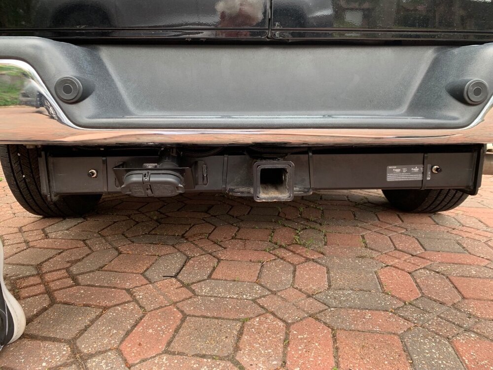

I’ve nearly completed Phase1 of the swing rack builds. The rear receiver hitch was removed from the Savana to enable some preliminary modifications, specifically welding reducer inserts in each end of the hitch’s cross tube, drilling holes for locking hitch pins and repositioned Air Lift auxiliary fill lines, and repainting. Once the paint is fully cured the hitch will be reinstalled in readiness for Phase2, actual fabrication of the individual swing racks. Unlike a pickup truck having a dropdown tailgate where a single swing arm would span the width of the vehicle, the van has two rear half doors and thus, separate swing arms for the custom racks. Also, unlike conventional installs where a vehicle’s rear bumper is either modified or replaced to accommodate a swing out carrier hinge, I’m making use of the stock receiver hitch to support the pivot points from below the bumper, whereby avoiding inherent door operation and clearance issues.
The receiver hitch, as removed, plus preliminary holes drilled at each end for additional locking hitch pins.

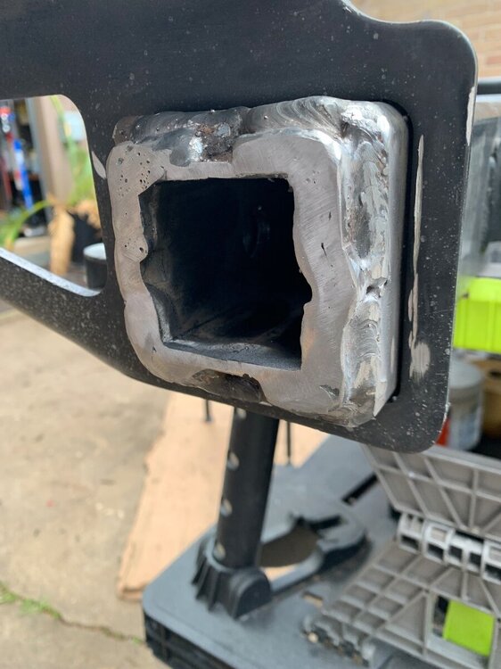

Reducers to transition the 3.5” OD square hitch tube to a 2” ID receiver.
Reducers welded into hitch tube at each end.
Matching .75” holes drilled in hitch tube for use of locking hitch pins to secure pending swing racks.
Modified receiver hitch primed.
The two hitch tube ends with installed reducers will now serve in like manner as the hitch ball mount receiver with locking pins.
Final topcoat of paint applied.
Modified receiver hitch ready for installation pending paint cure. Note the two small holes drilled in the support arms next to the voids where the Air Lift Schrader valve fill hoses will be repositioned.
And that is it for now!
Edited by Ronbrink

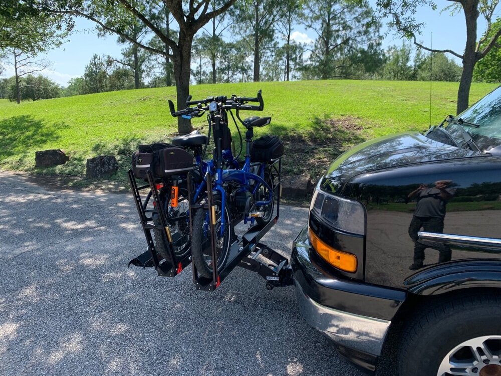

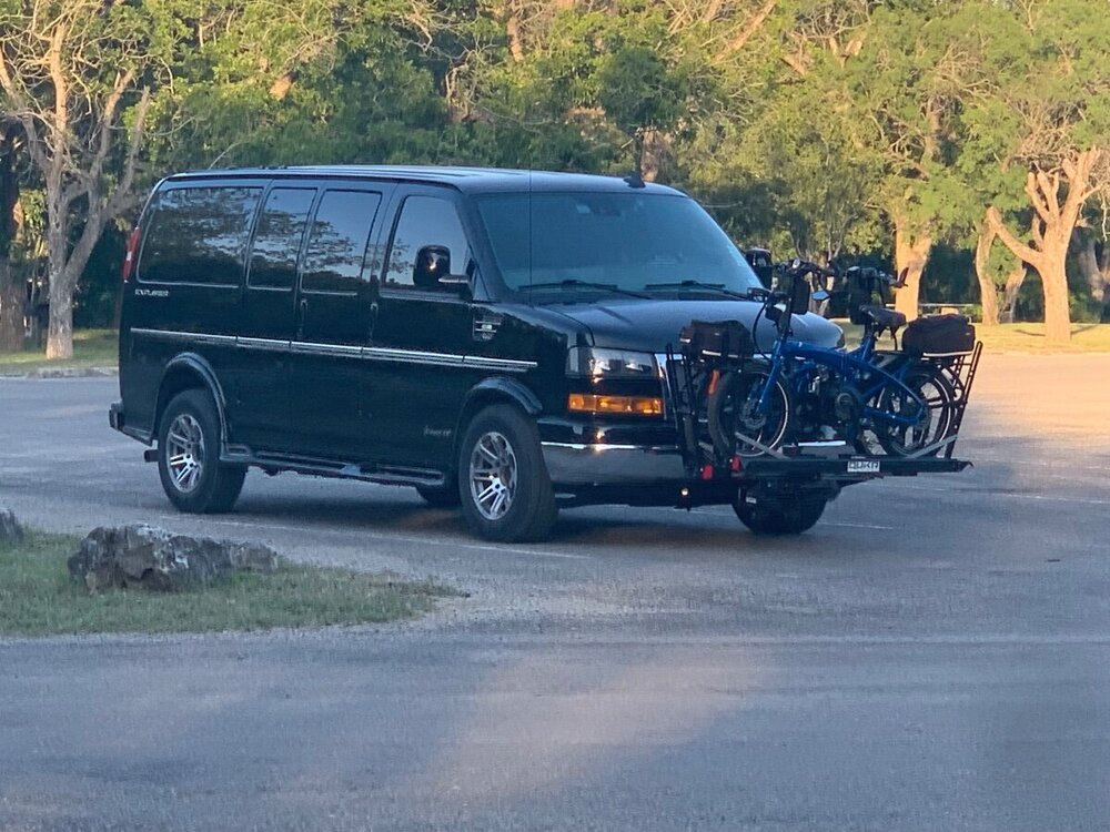

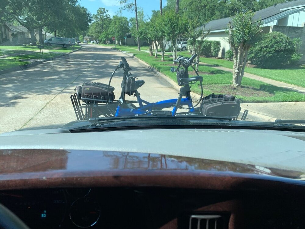

In preparation for next week’s trip, I thought best to test out our ebikes on the bike rack setup I recently retrofitted on the Savana. All went well and pleased that my vision from behind the steering wheel was even better than with the former TV. The front receiver hitch and bike rack rode solid around a neighborhood excursion. As a reminder, the folding ebikes are transported inside the van when underway to a destination then staged on the QuikrStuff bike rack once in camp. I do drive around with them mounted while inside a CG, to trailheads of proximity or nearby attractions.
5 hours ago, Ronbrink said:
...on the bike rack setup I recently retrofitted on the Savana...
Good work Ron and I must say, up front of the TV is the best place to add a bike rack!
I removed the OEM bike rack from our Oliver (I have an OEM mount with 2" receiver if anybody would like to buy one). So we have nothing mounted rear of our Oliver. Given that, our measured tongue weight is less than 580 LBS and GTW is 6500 LBS. This is 9% and good balance should be 10-15%. This light tongue weight creates what is called "porpoising" which the Anderson WDH controls (fights). You add a bike rack rack and the weight of bikes in the rear of the trailer and this ratio just gets worse. Instead front of the TV helps to balance any cargo weight.

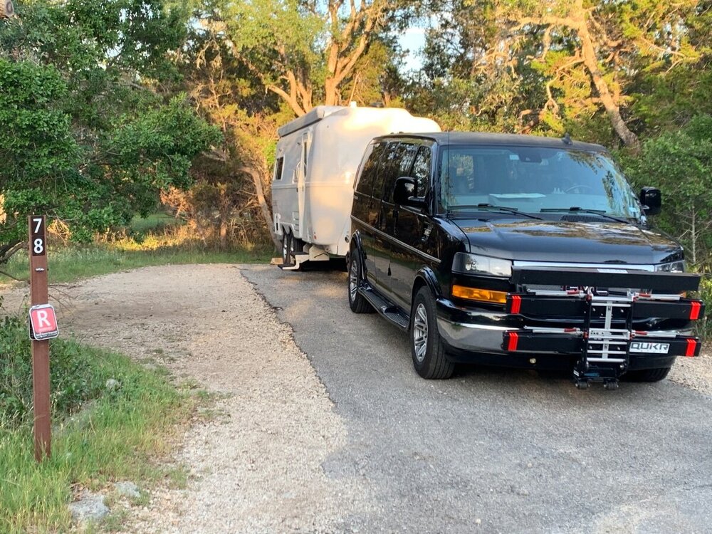

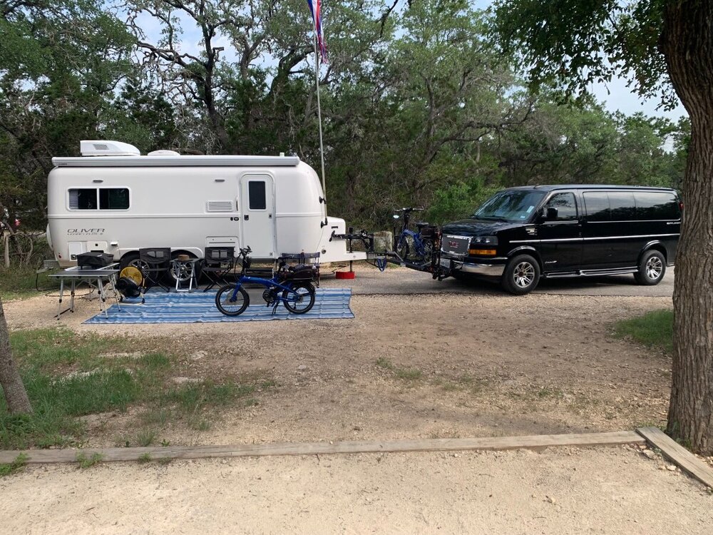

With the Savana readied to roll our COW to a scheduled destination, last week’s trip went very well; credit to the many upgrades and mods in the past few months. Here’s a few pics:
Loading modular box at COW Barn containing camping gear.

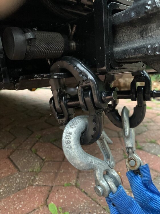

Improved safety chain management with newly installed hammerlock coupling links.
Newly configured 7-pin and DC-DC connection cables.
Ready for takeoff.
Smooth landing at destination.
Camp R&B, Guadalupe River SP, Spring Branch, Texas.
Trailhead parking for an evening bike ride.

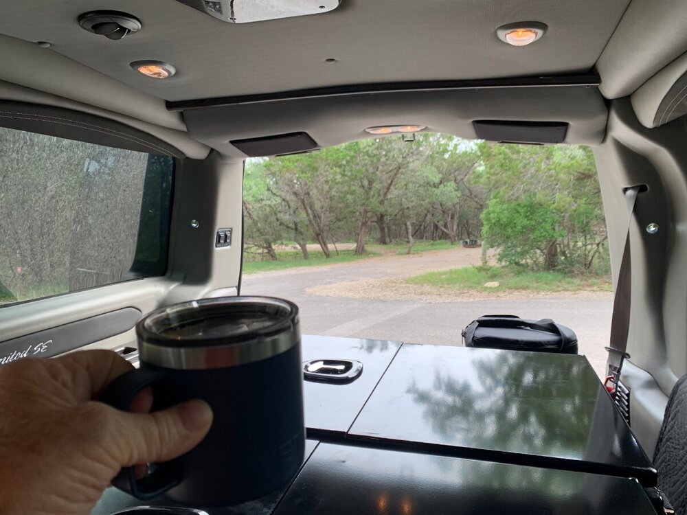

Morning coffee inside the Savana from a rear passenger captain seat.

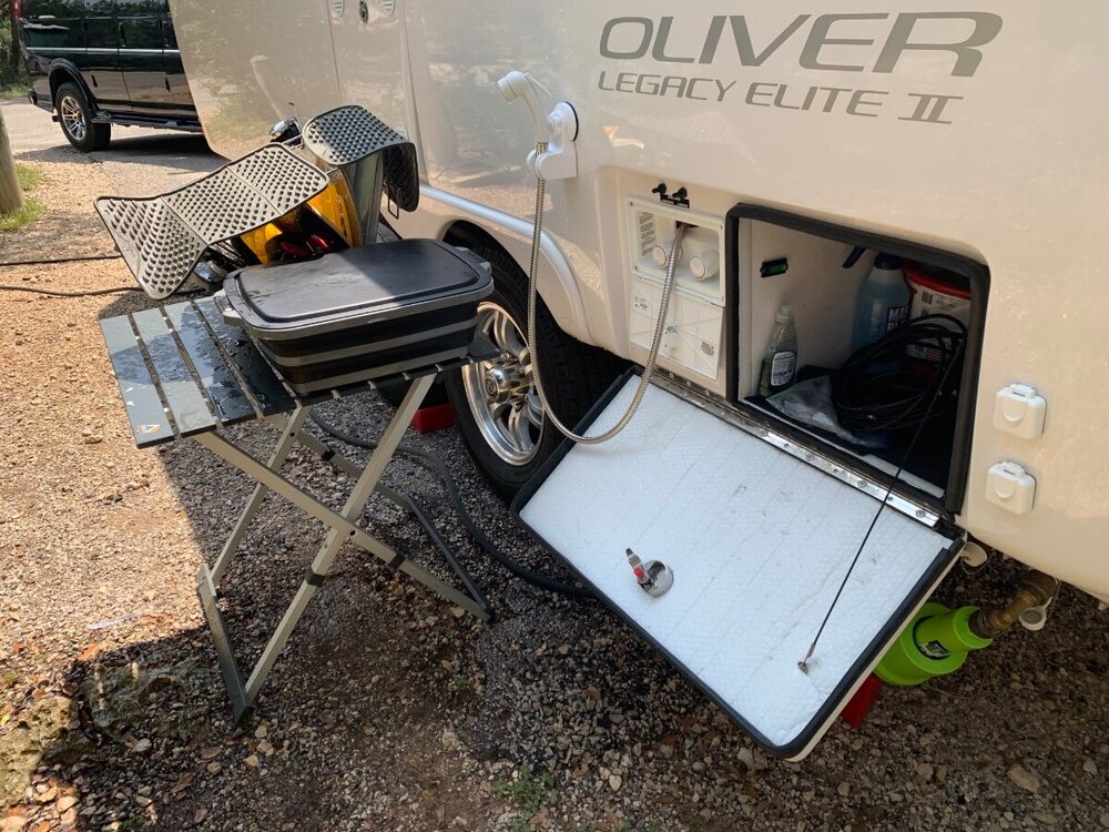

Wash station setup.

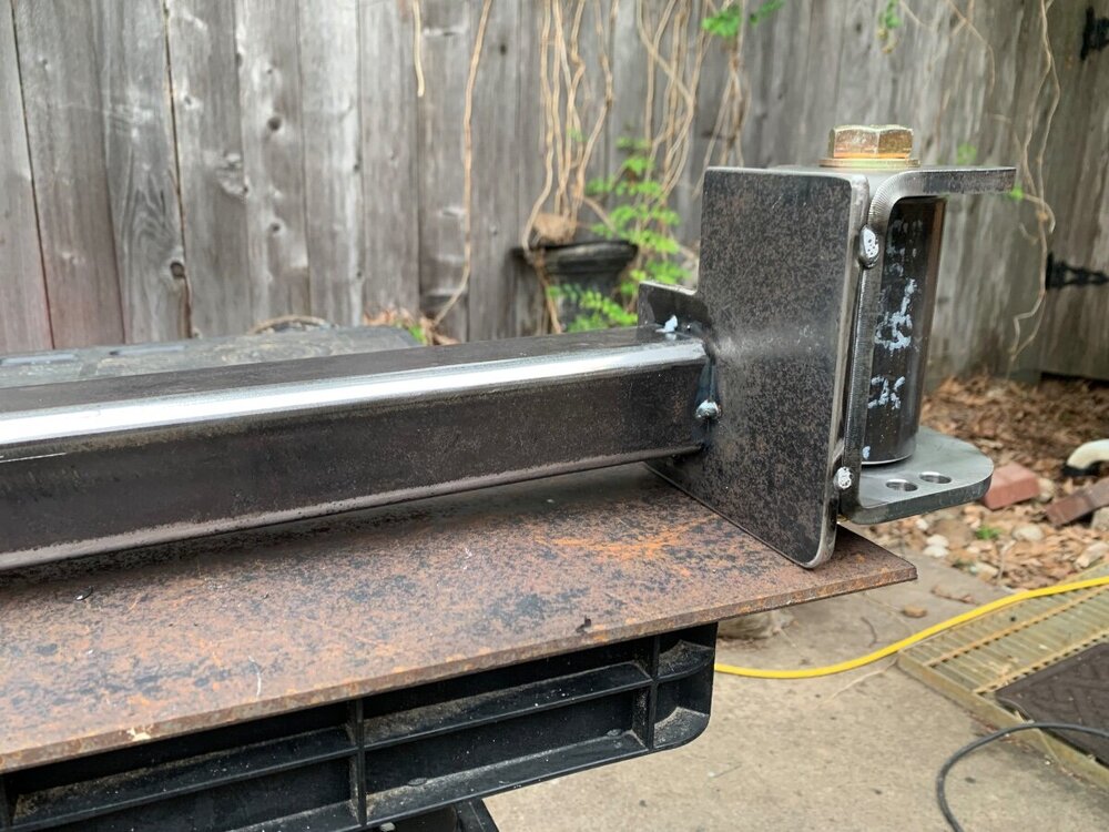

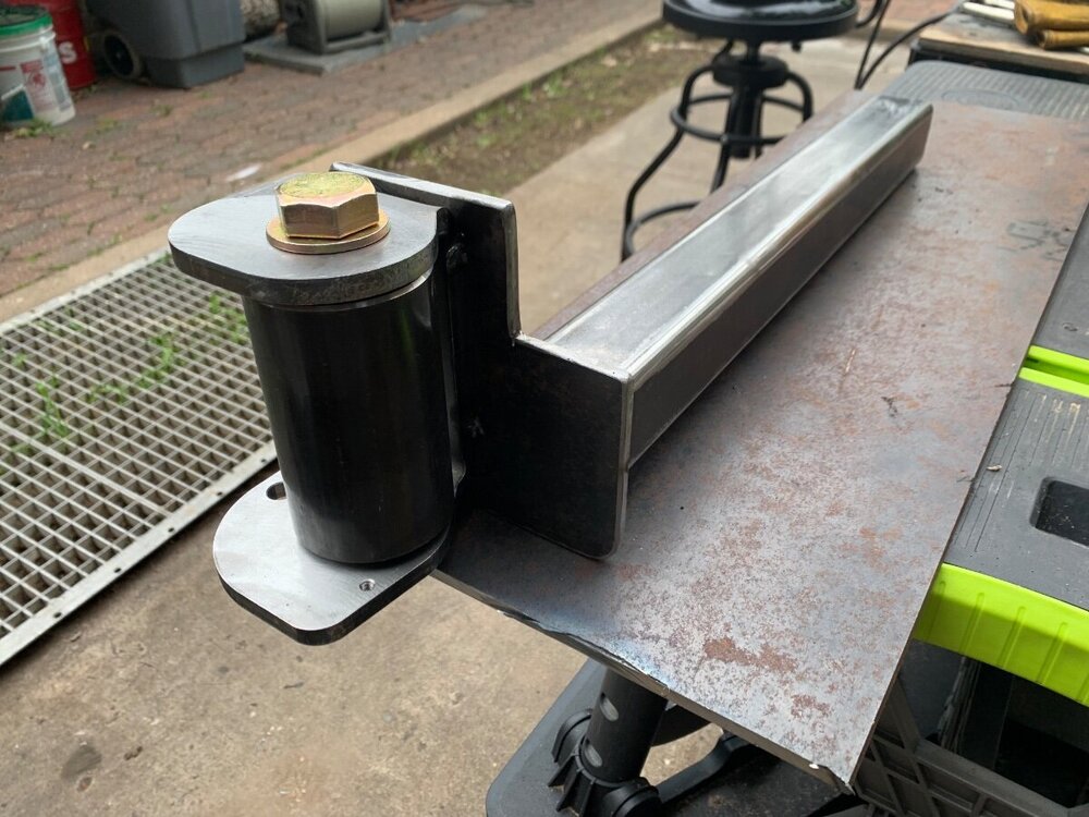

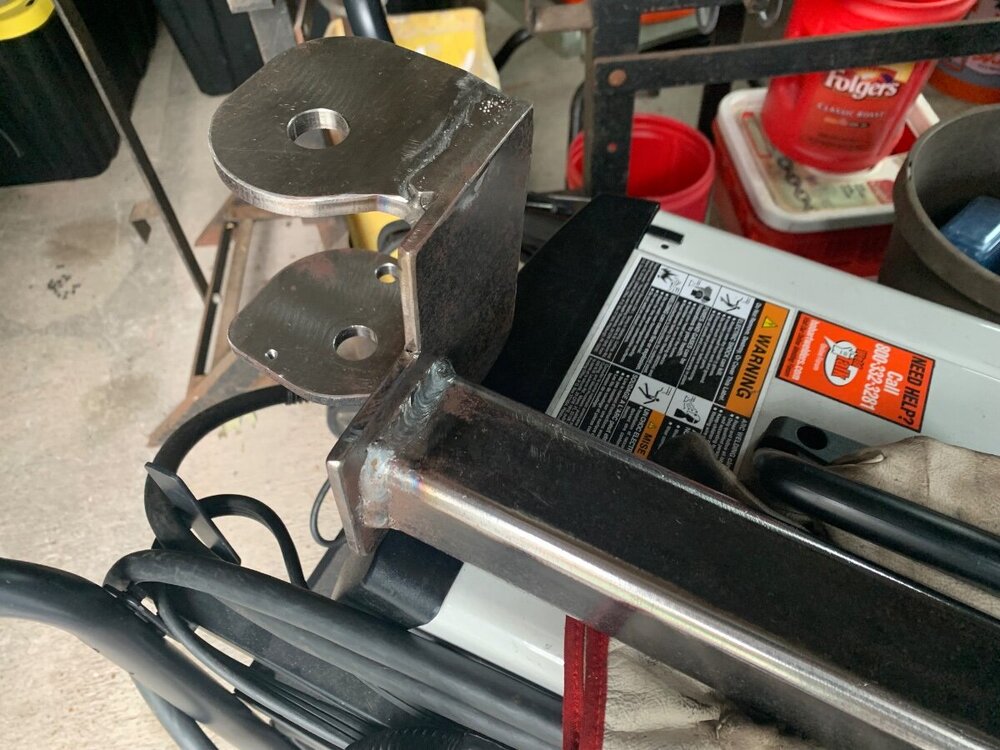

Back to last months swing rack builds with Phase 2 of that project; custom swing away racks for my two Wavian Jerry Cans and spare 30# propane tank. Had some supply delays, but now finding time seems to be an issue and thus, I will report as the builds progress. I completed fabrication of the primary driver side swing out carrier hinge and tack welds on the passenger side assemblies. Here’s a few pics:

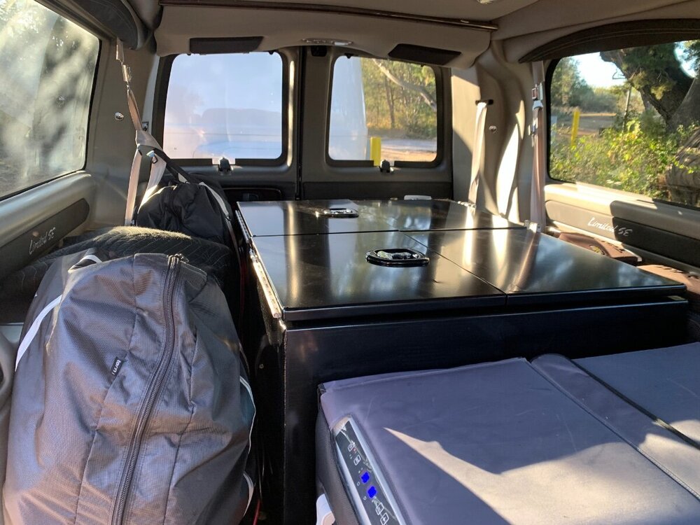

The following was copied from a former post and provided herein to better consolidate progressive modifications to the Savana in regards to the opening statement: “Ultimately, two storage boxes were acquired to safely stow much of the cargo; specifically, underbody tool boxes.”

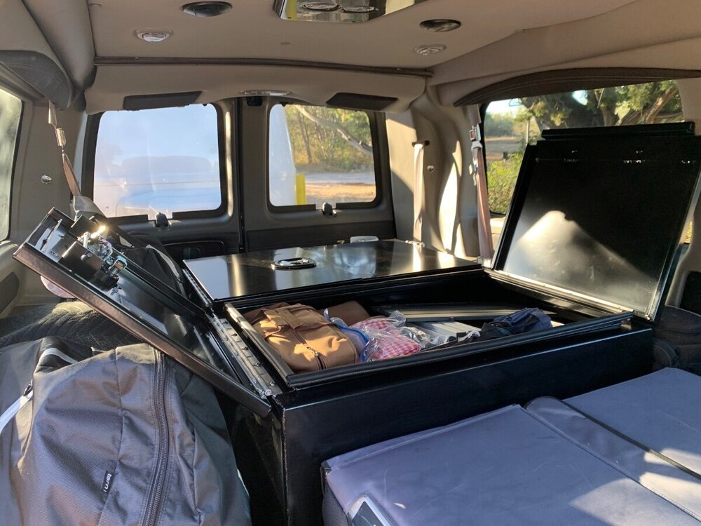

Cargo Securement Assurance/General Discussion   Posted December 14, 2024
When towing with a truck, the majority of ‘stuff’ brought along on a camping trip or road adventure is conveniently stowed within the various holds of the Oliver and bed of the TV. However, even though my former crew cab Silverado 1500 had a storage box under the rear seat, it was mostly used to accommodate service tools and supplies for the truck and thus, found myself utilizing the rear floorboards and seat as additional cargo space when traveling. There’s peace of mind knowing cargo carried in the bed of a truck is adequately secured, not so much for that behind the front seats! All one needs is something going on from behind when something tragic is happening up front, no bueno! We’re required to wear seatbelts for good reason, proper securement of vehicle interior cargo should be of equal importance. I would be interested in learning how owners with trucks/SUVs safely carry their cargo within.

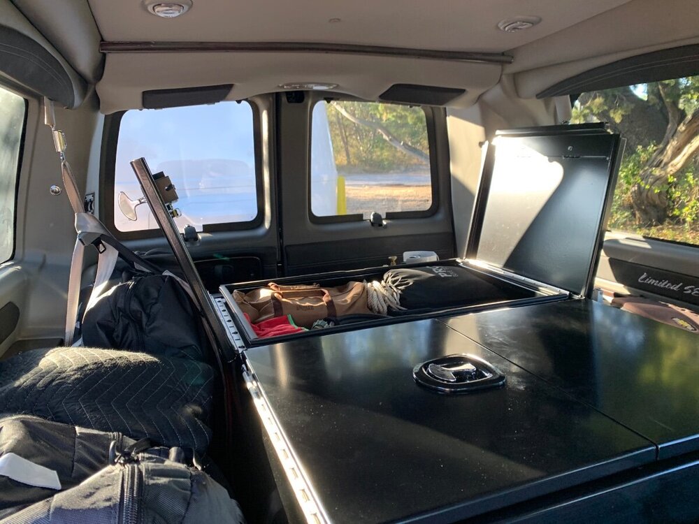

My awareness of cargo securement was heightened recently with acquisition of a converted cargo work van as my TV; specifics are detailed in a forum post last October under ‘Towing an Oliver’ and titled ‘2019 GMC Savana 2500 Cargo Van’, if interested. Unlike service utility work vans that generally have a partition or cargo net, along with containment shelves and boxes, to secure cargo and ensure personal safety; conversion and passenger vans are more designed for ‘people’ cargo. In the aforementioned forum post, I addressed cargo containment, but cargo securement was still under consideration. Here is what I did to address the subject matter:
Maiden voyage to Texas Oliver Rally, Inks Lake SP; cargo contained, but not secured!

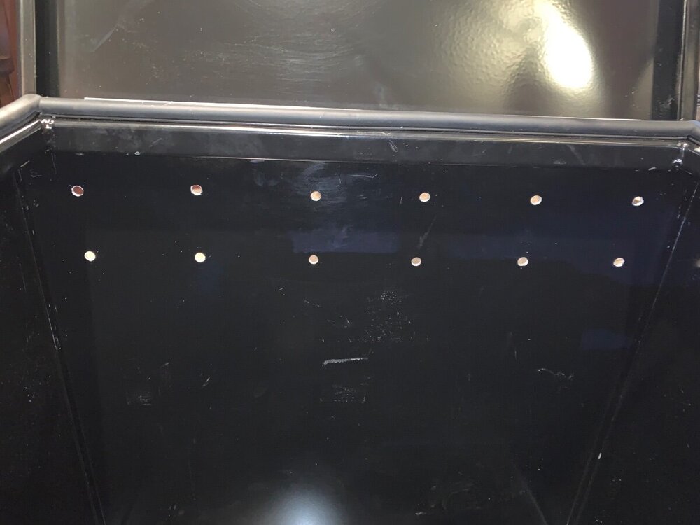

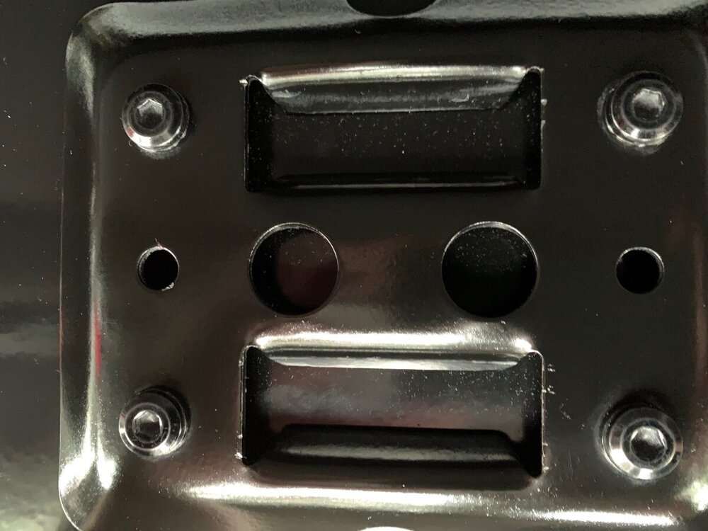

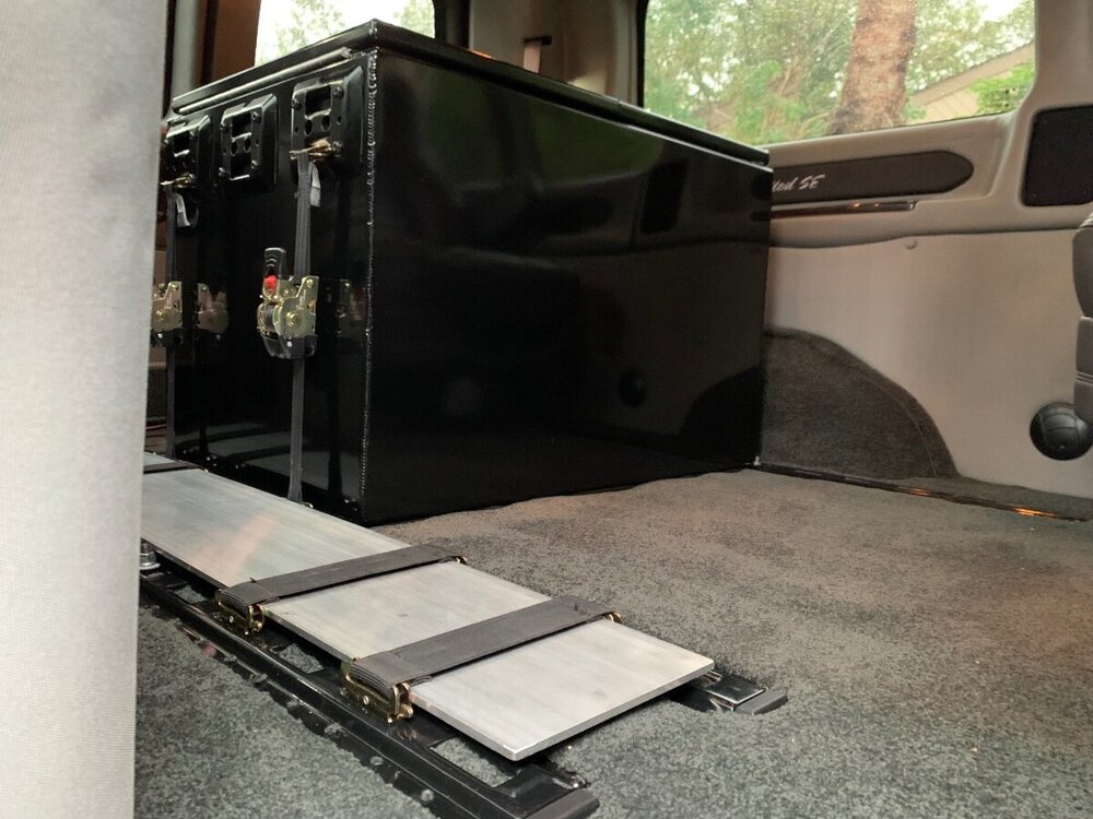

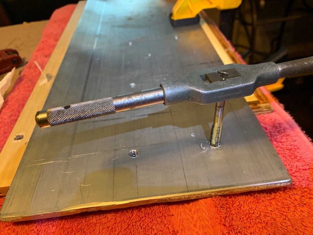

DC CARGO E-Track system components were obtained via online purchases from Tractor Supply. Each of the Buyers Products boxes were fitted with six of these brackets, three at the top of each end. A 1/4” x 8” aluminum backing plate was used to attach and strengthen these mounts.
Backing plate cut to size, holes drilled and tapped for mounting bolts.
Containment boxes prepped for backing plate and E-Track bracket installation.
Super Sliders affixed to bottom of containment boxes for ease of handling on interior carpet.

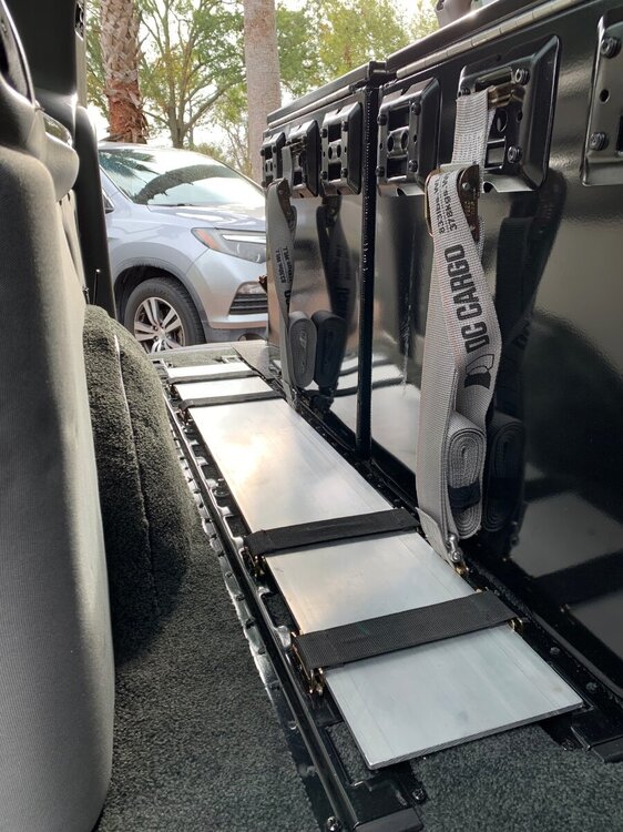

Three E-Tract rails fastened to deck to accommodate securement straps. Aluminum plate at floor level is runway for folded e-bikes. This box was slid rearward once back box was removed for storage at COW Barn. It primarily contains items typically kept in the TV with additional storage space, as needed, a trunk per se. Ratchet straps best used for non-towing vehicle use.

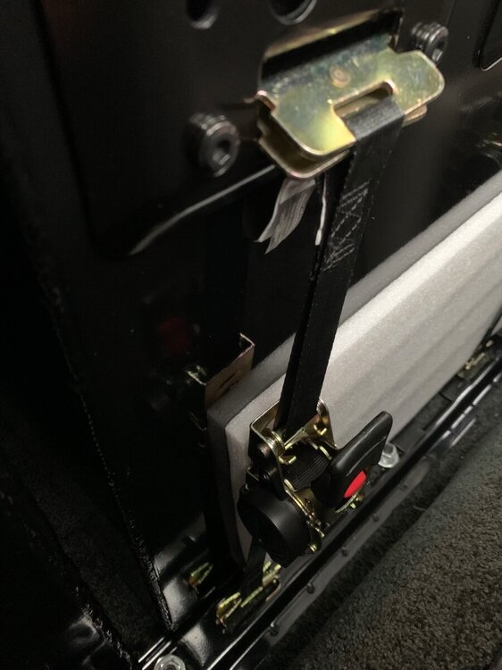

Box securement once e-bikes are deployed. Wider Cam straps best used for e-bikes and subsequent box securement when traveling. Rear box is for camping ‘stuff’, forward as a trunk and more ‘stuff’.
Driver’s side box securement using ratchet straps.
View of e-bikes ready for ‘takeoff’ on runway!
Cam strap securing e-bike.
Ratchet straps for spare propane tank, generator and other needs.
Items too long for the containment boxes are stowed behind at side panel.

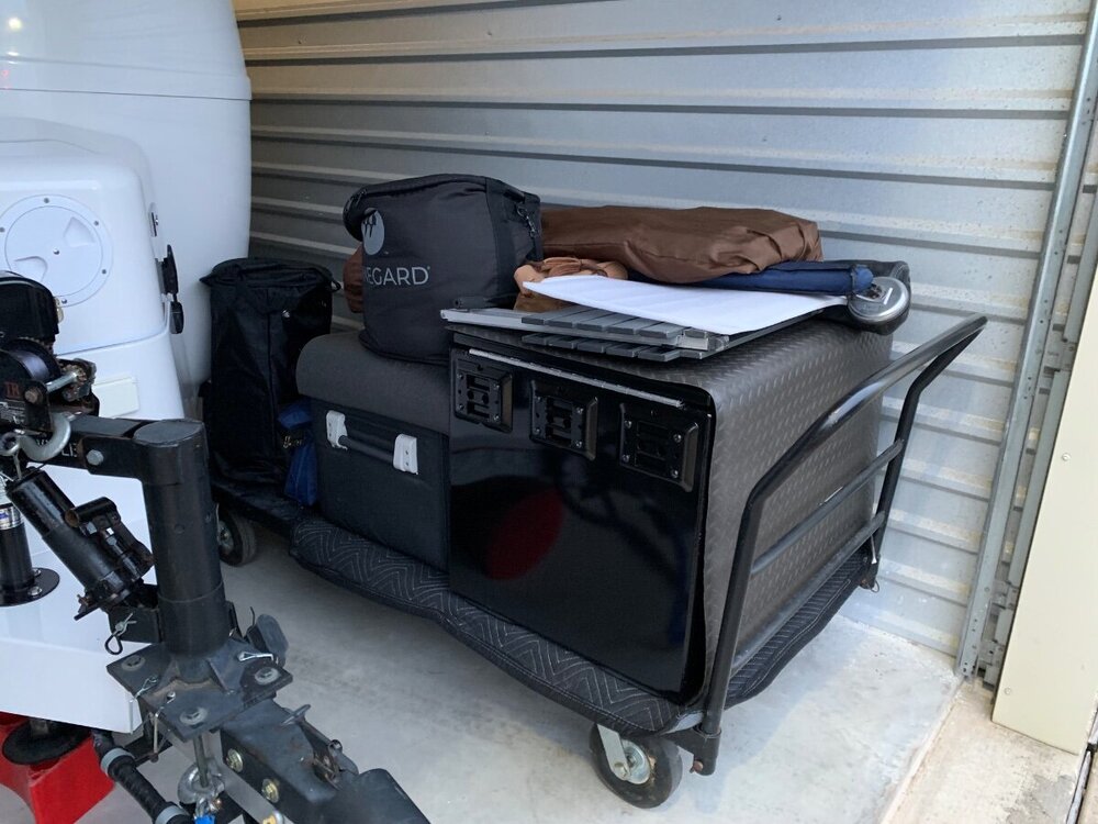

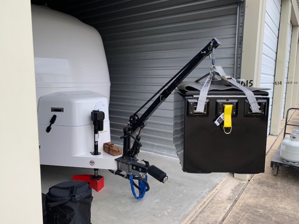

Oliver-mounted hoist used to transfer box at storage facility.
TV moved forward to enable box positioning. Cam straps used for the lift.

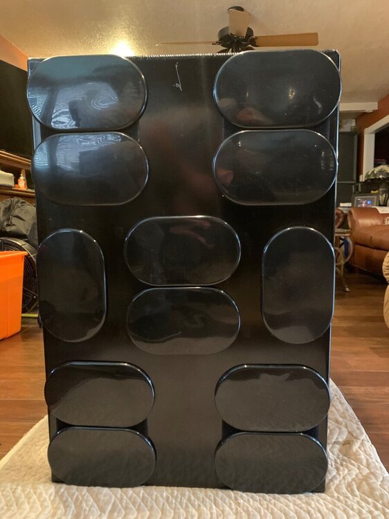

Containment box lowered onto platform cart.
Liking the modular containment storage.
