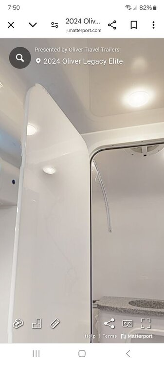

Two of my least favorite things about the Oliver are the awning that can’t be used in the rain and the floppy/noisy bathroom door.  I’ve long wanted to replace the door with a wooden one, but being a custom furniture maker, wifey has forbidden it because that's what I always do.  No more wood!  She just wants to keep with the shiny modern look for a change.
So, when I told her about Oliver’s new fiberglass bathroom door, she loved the idea and surprisingly suggested that I make one just like it.  Oh no!  This could be problematic.  I have no idea how the new door was designed, except that it appears to be made of fiberglass.
Since I won’t likely see one in person anytime soon, I’d be grateful if anyone could share details or close-up pictures of the door.   I’m curious about the jam, hinges, hasp, and finishes on both the inside and outside.  I’m also wondering how the mirror is attached, if it has a bezel or frame, and if the door is two-layered or similar to the closet door with the gelcoat on the inside.
If it seems doable without major wall or door jam modifications, I might build a reusable mold and try giving it a go.  Any insights or opinions on this are welcomed.

Definitely keep us posted. From the photo of the door on the OTT website, it looks like it could be made of a PVC or a dense foam-core material. It appears that it may be taller too which is great as i have already taken the top metal frame off of ours since I was tired of always scraping my head. The top corners of the door opening have also been cut rounded similar to the exterior door. The rounded corners would likely help prevent cracks in the bulkhead panel that some owners have reported in the past. Thanks, JoeScreenshot_20250301_075002_Chrome.thumb.jpg.70b9a3f2765794bf3af28b932f2ca76e.jpg

I believe the new door is fiberglass. For older trailers the entire bathroom wall would have to be replaced for the new door, which has rounded corners. I forget what Oliver said the price was to retrofit. It wasn't cheap. I remember the conversation with Oliver and the process was quite involved. I would contact Oliver for the latest info.

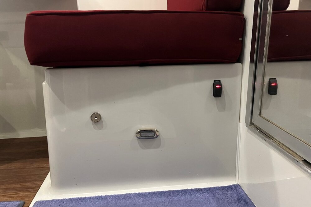

Any magnet will work since the door frame has steel in it. This is what I did (round magnet on left). I used 3M VHB to mount it. The magnet was too strong so I put some foam tape on the corner door frame to soften the pull.

The only change to what I posted is that I moved the magnet inside the dinette seat.  It doesn’t show and the grip is not as strong but holds fine.  You can see the magnet on the door, but only if you look.  You can order these door magnets on Amazon fairly easily.  Mike

Try putting the magnet inside the dinette seat.  It reduces the pull and can’t be seen.
Nice, excellent design idea!
