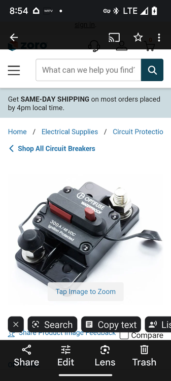

My 300 amp optifuse keeps tripping when I try to run the Truma AC. It’s pulling around 800-1100 w when the a/c compressor runs. The fuse randomly but often trips. This is the replacement fuse/breaker from Oliver. They sent me a new fuse right after we bought it for the same issue. I was at Oliver last fall getting the Truma a/c installed and asked them about the constant Error 20 code but they had no idea. So this year I’m not getting the error code just the 300 amp Optifuse keeps tripping. And it is very hot when I reach down to reset. Tripped again today (5/21). Everything looks good and tight.

That’s the same Optifuse breaker Oliver sent after I first reported the problem. Could I possibly have gotten 2 bad breakers?  Back to the drawing board…
Hull #1238 - Legacy Elite II, TB. TV 2017 Tundra TRD.

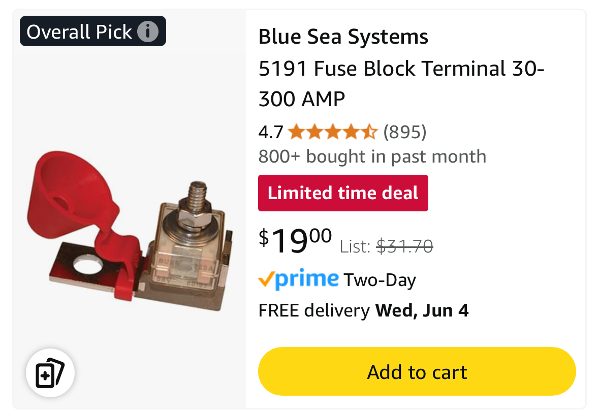

Time for anybody needing to replace the main breaker, get a fuse and fuse holder instead. Fuses protect bidirectionally, meaning they will protect the power source (battery) and the load, inverter and/or other loads.
Breakers are OK for like a 40A or 60A DC branch, but not on the 4/0 cables between battery and inverter. A fuse will protect a ground fault at the batteries or at the inverter and a breaker will only protect one side, depending on which direction it is wired.
In our older hull, OTT had wired a 250A ANL fuse and holder between the batteries and our original 2KW inverter (check inverter manufacture's spec for correct fuse amps). When I upgraded our inverter I only needed to get an ANL for higher amperage.
You can even better protection with Class-T fuses ($$$) but ANL will perform much better than the breaker shown above and certainly is good enough.
I would suggest these. The Blue Seas holder is rated to 750A. They have a smaller 300A holder for less money, but this one is nice, with two pairs of mounts which allows you to change the fuse without loosening the battery cables. The second link assumes you need a 300A fuse. Enjoy! 😂
https://www.amazon.com/Blue-Sea-Systems-Block-Insulating/dp/B001VIVWAW/
https://www.amazon.com/Blue-Sea-Systems-5133-300a/dp/B07D1VJ7BM/

Changed out the inverter breaker.  Turned batteries on, then inverter breaker, and finally solar.  Waited a few minutes and turned on the inverter at the remote.  Everything fired up.  I then placed a cup of water in the microwave for 2:15 minutes and it worked as it should have.
After speaking to Jason E. at the Mothership in February, Oliver is no longer installing the breaker system.  They are installing a more robust fuse.
JD, I agree with you on the use of a fuse vs. breaker.  I asked Jason what the cost to switch out and it was, I believer over4 $1,000.  Jason suggested I stick with the breaker.
Hopefully this will last for awhile.  I bought 2 breakers, so I have one in the closet.

11 hours ago, aaronorange said:
Is there any reason why I couldn’t use a 300A battery post fuse? It would seem to be easier to replace if needed.
I don’t see why not. This post fuse is called Marine Rated Battery Fuse (MRBF). I bought these in 60A to protect our DC2DC charger and another to protect my positive bus. I went with ANL for the main since OTT had installed a holder there and I needed to up it to 400A for our Victron Inverter upgrade.
They do make a 300A MBRF. I went with this South Bend brand. Here is their 300A MBRF holder and 2-pack fuses.
https://a.co/d/05ee0Ia
When I went to loosen the nuts on the breaker posts, I found them loose. I used locktite. I now wonder whether the breaker was actually bad. When I pulled cable ends off the breaker posts, I found them to be pitted, which leads me to believe there was arching due to loose connections. I gave both cable ends a good spray of DioxIT D5, both sides and two applications. I let them dry before re-installing the cable ends onto the posts. I used Green Locktite, per Jason E.  I tightened everything as tight as possible
I waited 24 hours for the Locktite to set-up before turning the power back on.
As mentioned in an earlier post everything works normally.
Lesson learned. Check all electrically connects at the beginning of the year. There probably wasn't anything  wrong with the breaker, just loose connections. Since I purchased 2, I decided to install a new breaker.
It appears what happened was Owner error for not checking the connections.
