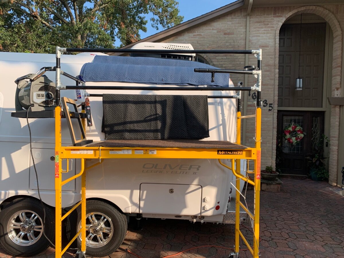

Ronbrink Posted June 6, 2025 Posted June 6, 2025 (edited) On 6/3/2025 at 5:31 PM, Treasure Coast Vault said: Hello this is my first post! I am removing the Dometic AC that came with my 2021 LE 2. I bought a Pioneer Inverter AC/Heat Pump 13,500 BTU. Any tips on removal and installation will be gratefully accepted! Removal made easy, used moving blankets to protect the gel coat. I detailed my a/c swap in Dreiha Atmos 4.4 Home Install/Ollie Modifications; follow your installation manual, the process should be very similar in general. Edited June 11, 2025 by Ronbrink 3 Ron and Brooxie | Clear Lake (Houston), Texas 2020 OLEll, Twin, 579: No installed solar, dual 30# propane tanks w/GasStop safety devices, Renogy 40A DC-DC charger, 460Ah LFP battery bank/Victron SmartShunt, auxiliary Cerbo-S GX/Victron 30A Blue Smart IP22 Charger combo, interior mounted Hughes Autoformer, twin independent sliding Lagun mount tables, extended dinette table and pantry landing, tongue-mounted hoist, Beech Lane refrigerator Ventilation/Evaporate Coil fans, metal valve stems with TST cap sensors and signal repeater, Waste Master sewer hose management system, Dreiha Atmos 4.4 A/C upgrade/Ceilo Breez Max thermostat, FlagpoleBuddy Starlink Mini suction mount kit. 2019 GMC Savana 2500 Cargo Work Van: Explorer Limited SE, Low-Top 7 Passenger van conversion, 6.0L V8 Vortec, 6-Speed Automatic, RWD; Air-Lift LoadLifter air suspension/WirelessAir compressor; Bilstein B6 4600 Series shocks; metal valve stems for TST tire pressure monitoring system; Buyers Products cargo containment boxes/DC Cargo securement system; rear bumper DC-DC Anderson power cable outlet; 100Ah 12V portable power station/Dometic CFX 75L Dual Zone cooler; front 2” receiver hitch/QuikrStuff Mach2 double bike rack; Mechman 320A high output alternator; Starlink Mini/Veritas Vans magnetic mount.

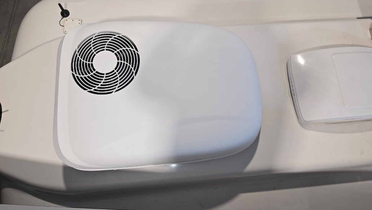

Treasure Coast Vault Posted June 20, 2025 Author Posted June 20, 2025 I installed the Pioneer A/C. Went very smooth. They make it easy. All the foam insulating collar and vibration pads are adhered to the unit. Just clean up the residue from the old unit and install it. Much quieter than the Dometic. Draws anywhere from 64 watts on fan and 500 to 700 watts when the compressor kicks on. Runs effortlessly on my inverter with no shore power. 2 1

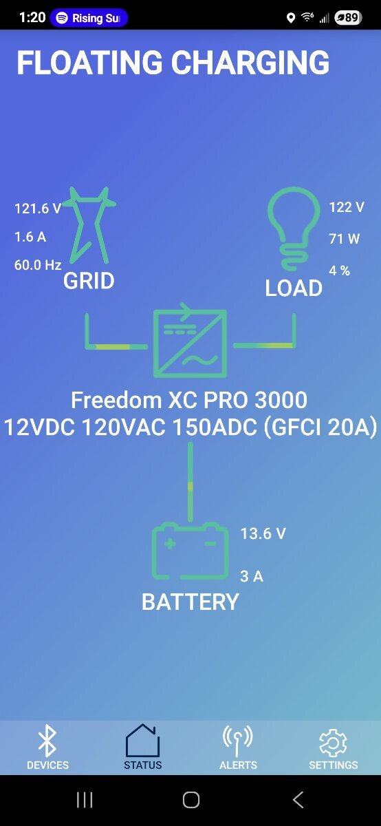

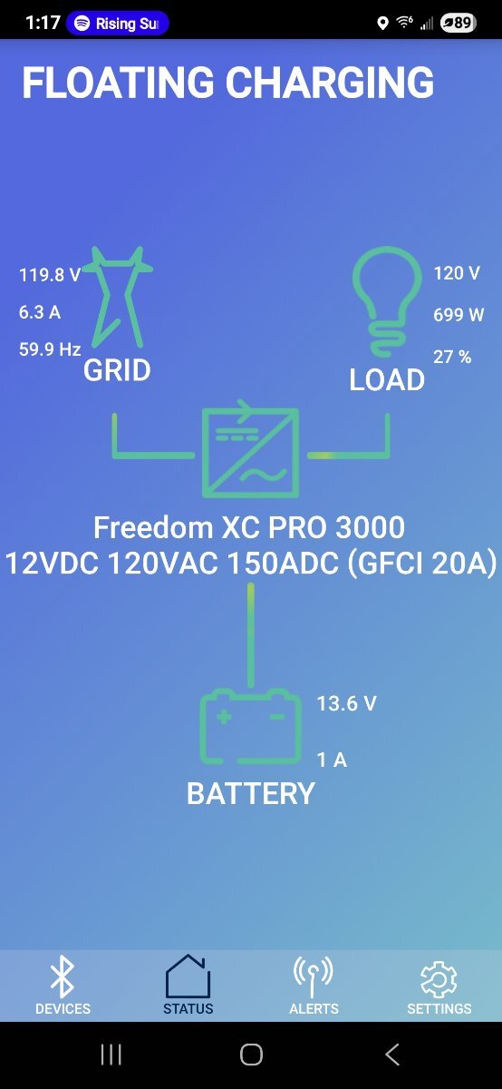

jd1923 Posted June 21, 2025 Posted June 21, 2025 7 hours ago, Treasure Coast Vault said: Runs effortlessly on my inverter with no shore power. Could you let us know what model inverter, Ah LiFePO4 and if possible could you show your app pic showing the -A draw with the compressor running? Also btw, quieter than the Dometic P2 is a lot like stating, “lighter than an elephant!” I know it’s near impossible to measure sound volume, forget the bad apps that attempt to do so. 🤣 Like @CRM I’m leaning towards the inverter A/C vs. some of the others. Running longer on batteries to me is more important than whisper quiet now, if it’s amply quiet enough. Thank you so much for posting this! 1 Chris & John in Prescott, AZ | 2016 EII #113 | '01 Ram 2500 Cummins!
CRM Posted June 21, 2025 Posted June 21, 2025 12 hours ago, jd1923 said: if possible could you show your app pic showing the -A draw with the compressor running? I would like to see this too. The specs for that unit call for cooling input power of 850 ~ 1500W so I'm guessing the compressor was operating at the lower end of it's capacity with the low watts he was seeing. Don't see how it's possible to get 13500 BTU's from 500-700 watts but I'd love to be wrong on that! The EER rating would need to be the the 20 range for that low of a watt draw. 1 2010 Elite II Hull #45, the first LE2 sold. 2020 Toyota Tundra TRD Off Road 4WD 5.7 with 38 gallon tank, 4.30 axle and tow package.
Treasure Coast Vault Posted June 21, 2025 Author Posted June 21, 2025 I have the Xantrex XC 3000 as shown in pics and 2 LifeBlue 200 AH Batteries. Here is with AC Compressor running and the lower wattage is compressor cycled off and fan running. It will drop down to near 500 watts as it cycles. It starts up around 200 watts and ramps up to 720 and settles in a few seconds just under 700 watts on start. 3
CRM Posted June 21, 2025 Posted June 21, 2025 1 hour ago, Treasure Coast Vault said: I have the Xantrex XC 3000 as shown in pics and 2 LifeBlue 200 AH Batteries. Here is with AC Compressor running and the lower wattage is compressor cycled off and fan running. It will drop down to near 500 watts as it cycles. It starts up around 200 watts and ramps up to 720 and settles in a few seconds just under 700 watts on start. Your watt numbers closely match those seen in this test of the Turbro unit (which I assume is the same as the Pioneer) when it is throttled down into the 8000 BTU range. It has a crazy good EER of 18 at that BTU range and I bet it will run at that lower level in an LE2 in most situations once set temperature is met. They only recorded a max watt draw of 1100 watts while running at full capacity which is also a crazy good number. Thanks for sharing this info... I'm just waiting and hoping for a sale on one now. 2 2010 Elite II Hull #45, the first LE2 sold. 2020 Toyota Tundra TRD Off Road 4WD 5.7 with 38 gallon tank, 4.30 axle and tow package.

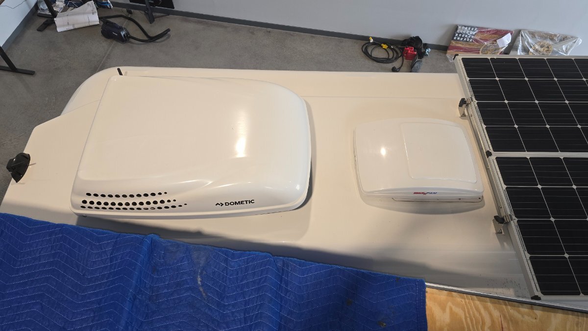

Treasure Coast Vault Posted June 22, 2025 Author Posted June 22, 2025 Turn off AC Breaker and Remove Furnace Fuse Step 1 Remove Interior Trims and Screws. Step 2 Remove the 4 Mounting bolts from Inside cabin. Step 3 Take a picture of the wiring Step 4 Disconnect all wiring to the Control Box and disconnect drain hose Step 5 use a little Braid fishing line up on the roof to cut the seal on 1 corner of the AC mounting gasket. Step 6 Break loose the unit by picking up on the Braid loosened corner then working your way to each corner until unil is no longer attached Step 7 Remove old rooftop unit Step 8 Clean the residue from the old gasket with any type of oil even vegetable or olive will work, Scrub the oil off after. Step 9 set the roof top unit in place. All the foam seal and leveling is attached don't overthink it just mount it. Hole is perfect size already. Step 10 Open Dometic Furnace and use a continuity tester to ID the 2 wire from the Furnace. They were blue on the Furnace but changed to blue and green somewhere before arriving up at the interior hole on my Ollie Step 11 Remove Dometic Thermostat and ID the wires to the Interior hole. I had a 3 wire Green, Red, White. Step 12 wire 2 wires from Furnace to Red and white going to ThermoStat. Push the wires into the channel the wires are in up top to get them out of the way Step 13 Cut off drain pipe even with opening. No longer needed Step 14 Eye up 4 mounting bolt holes in the square hole and make them even spaced to each corner. Mine used the 2 inch one. Step 15 Apply the correct thickness foam seal to the Unit or bottom bracket. Step 16 Mount the bracket make be sure to feed the wires through the big opening. Step 17 Connect the connectors and hook up power wire Step 18 Torque the bolts to 3.5 lbs Step 19 Install the trims Step 20 Install the batteries in the remote. Turn on the breaker and fire it up Refrain from using the LED lights for at least a day the Joy of the New AC and then the lights will be too much for your body to take in 1 sitting! Get a 2 wire Heat Only Thermostat for the Furnace. I will post the one I got later. Wire it up and install the fuse. Enjoy I may of forgotten a few things but you Geniuses can help me with that. ;^)) The Interior trim is much smaller than the Dometic, There will be 2 screw holes showing, I am thinking just get 2 screws with finish washers and fill the hole. Let me know if there's an easier fix. 1 1
