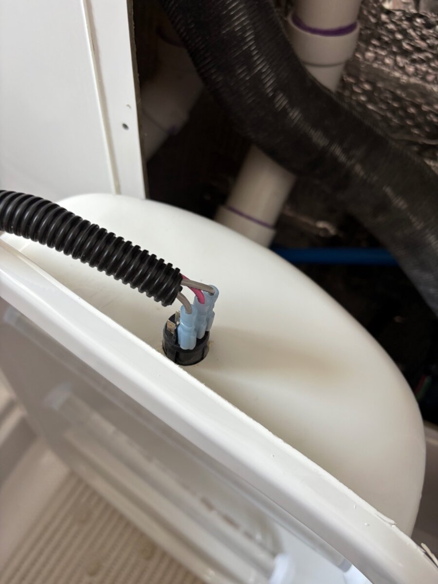

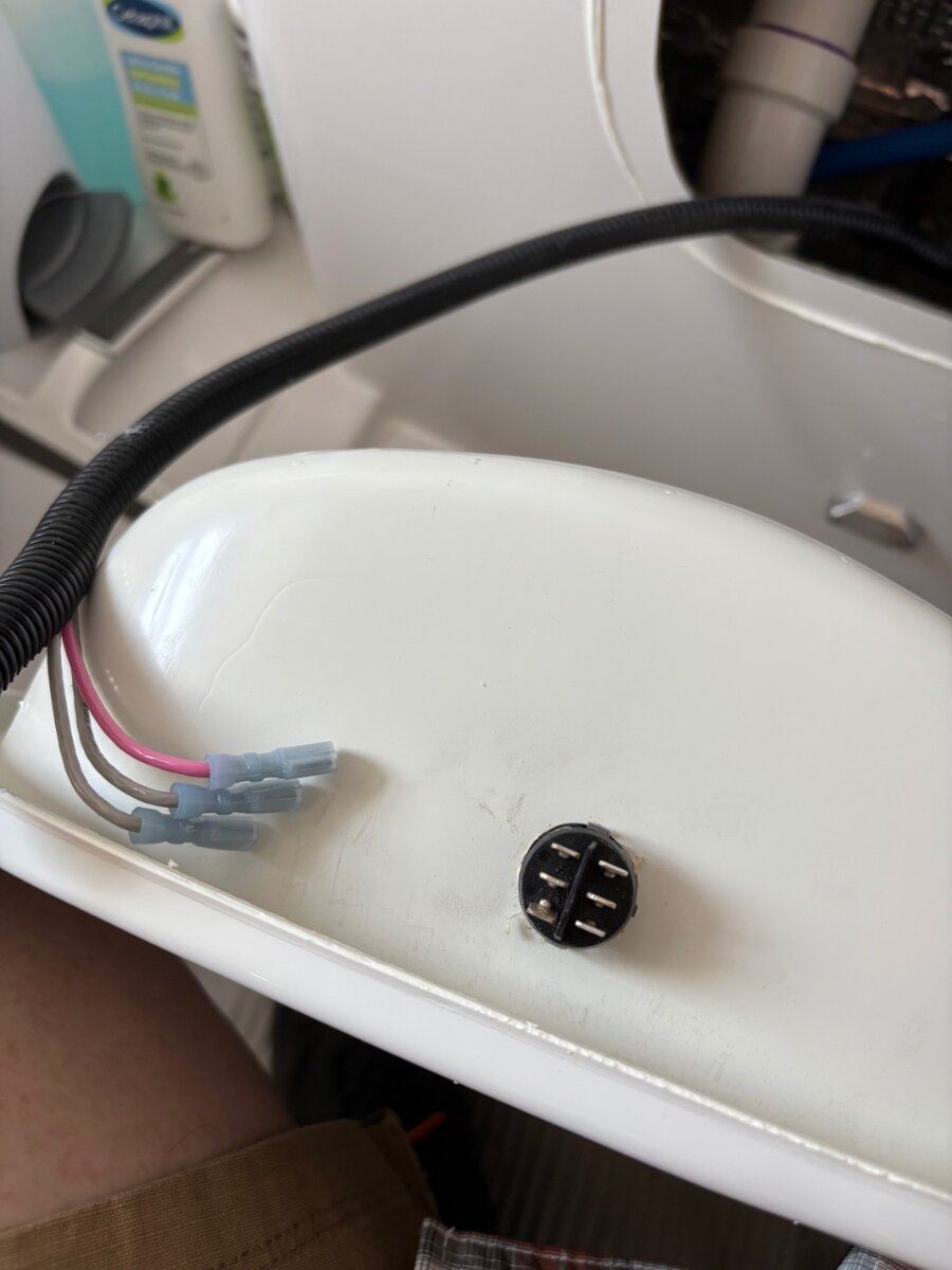

We were on our first long trip consisting of 2 to 3 months in the Ollie ( mostly Boondocking) . We were about 2000 miles from home in Billings,Montana and had stopped in a parking lot for lunch. I went to wash my hands and the water pump wouldn’t work. I noticed when I put pressure on one side of the switch in the bathroom it would pulse on like a momentary switch. I removed the screws from the bathroom caddy and carefully scored the caulk. When I removed the caddy all the wires fell off the switch. I had no idea which color wire went where. After a call to Oliver and with their help and research I used a pair of pliers to gently tighten the wire connectors and pushed them back on the proper spade. The red wire attaches to the center spade on the right side and the grays on the outside spades. I have two pictures that show the switch. Hopefully this post will help someone who might experience the same problem.

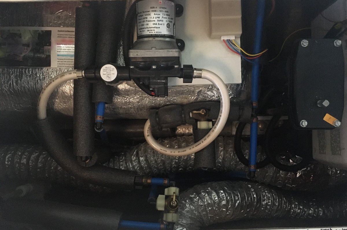

We’ve also had the wires come off of the water pump itself.  There are two red wires, I don’t think it matters which spade they’re attached to, it just took me a few minutes to find them!  Mike

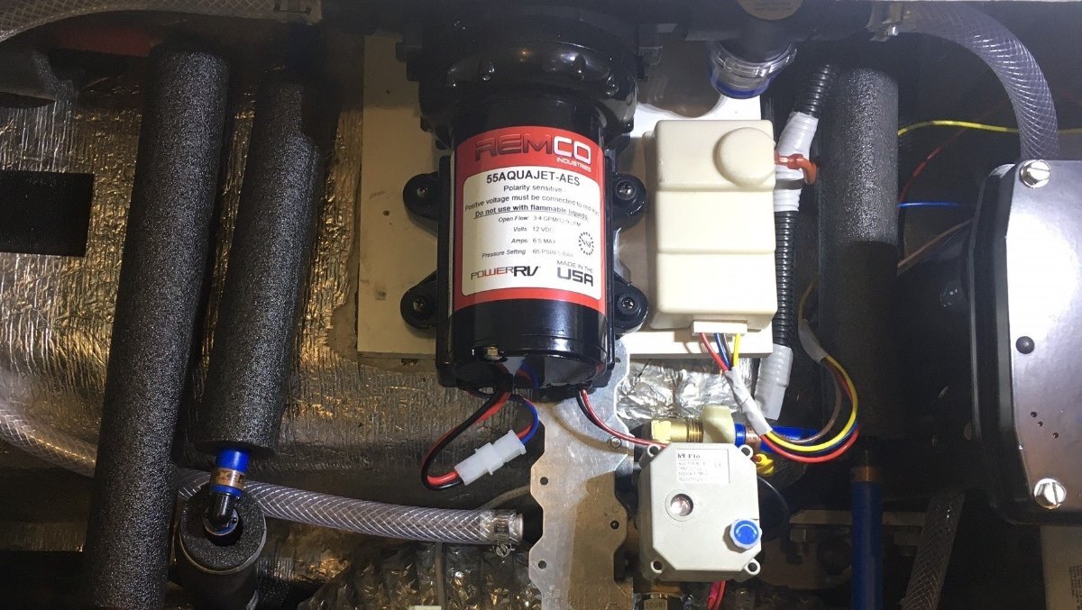

It's odd but true that the simple OEM ShurFlo water pump has two RED wires (see pic1, look very closely) which means it would run in either polarity. When I upgraded our water pump it certainly had explicit RED/BLACK wiring designating DC polarity (see pic2).
