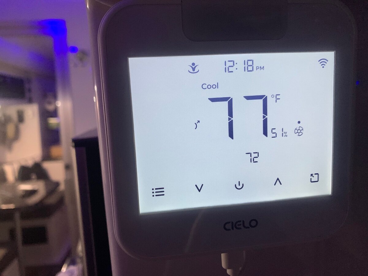

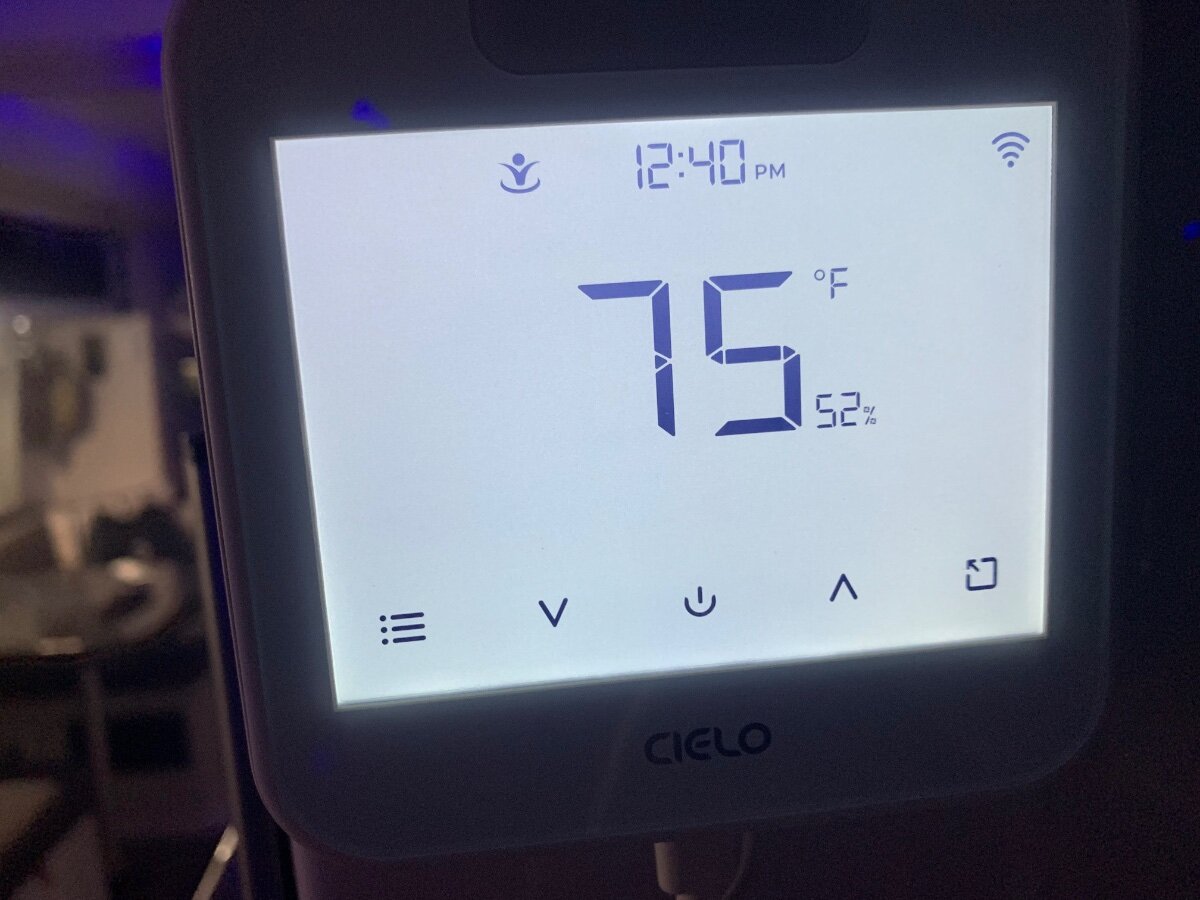

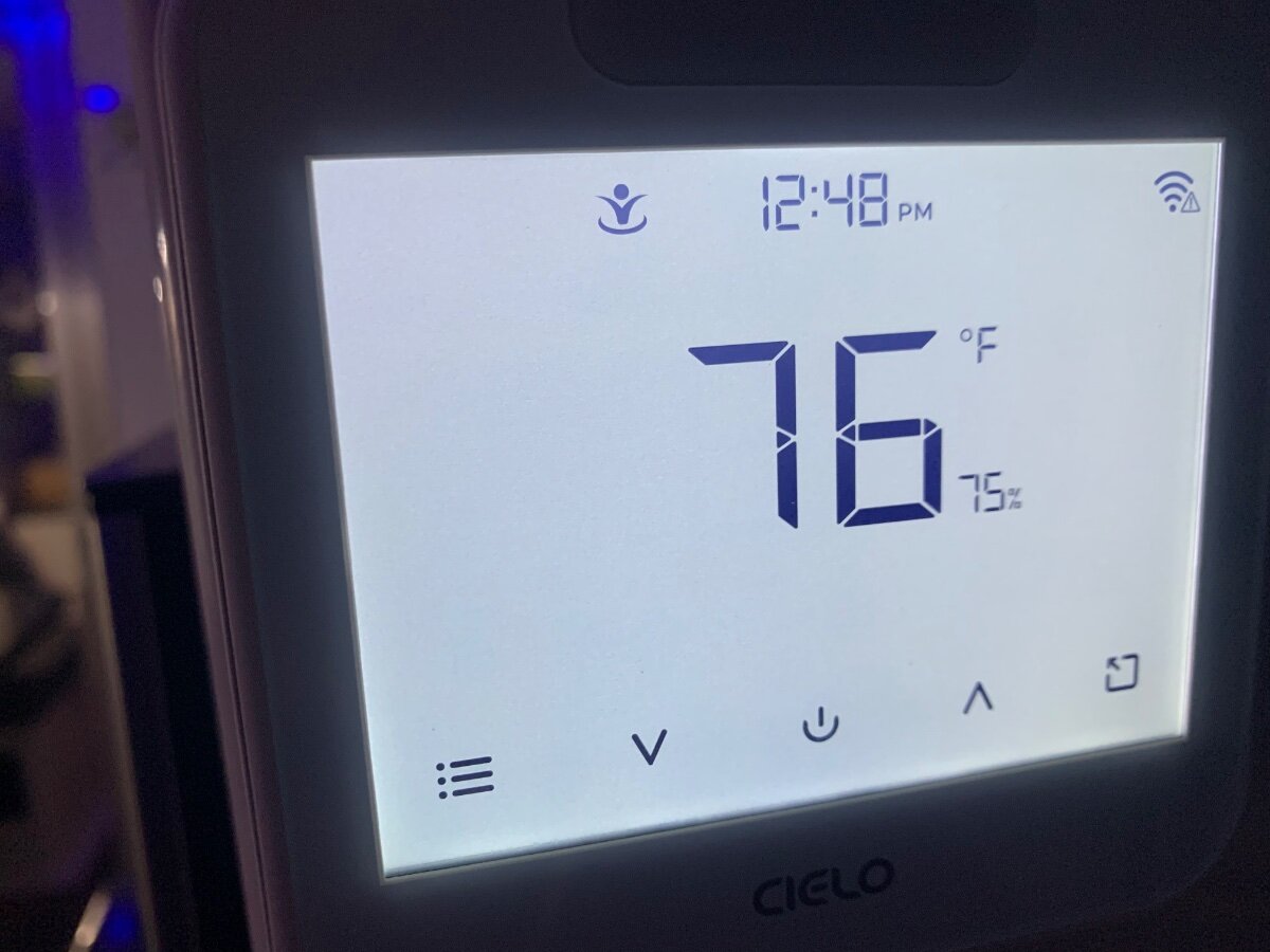

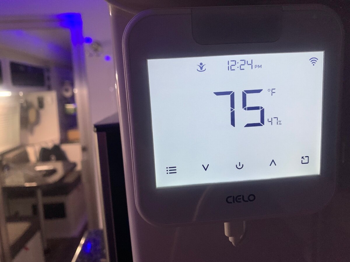

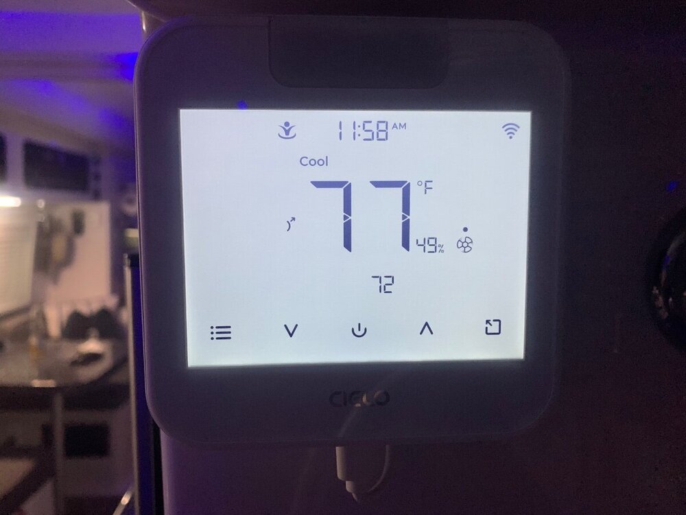

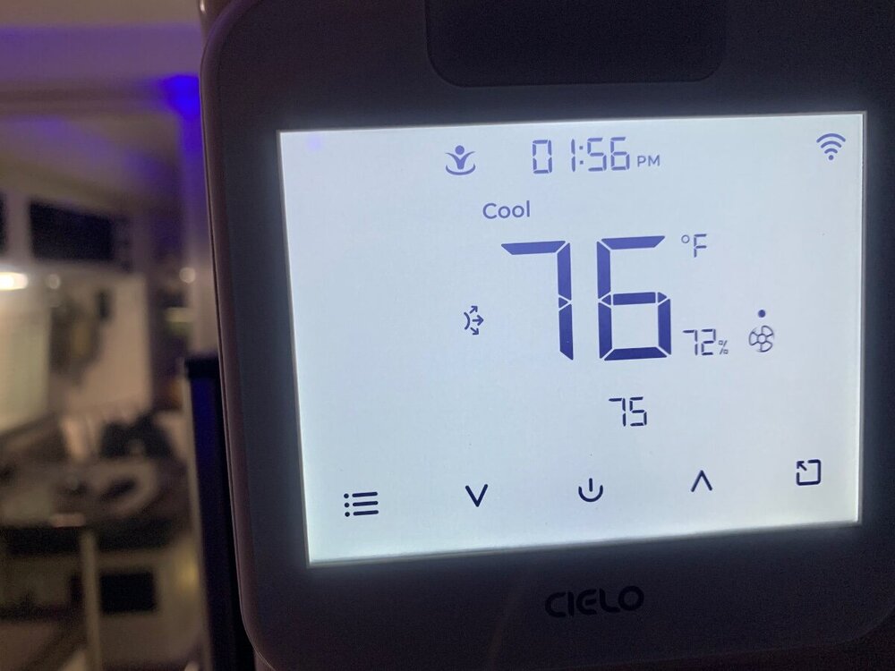

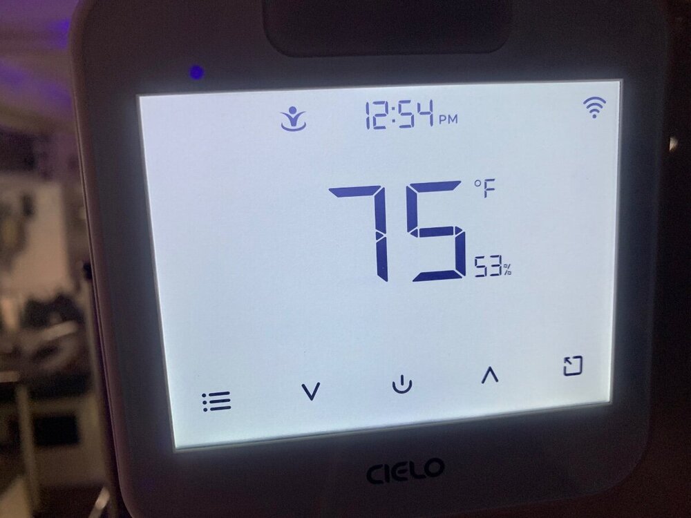

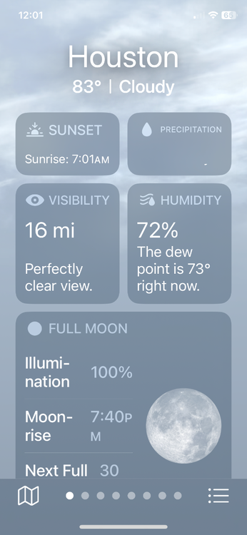

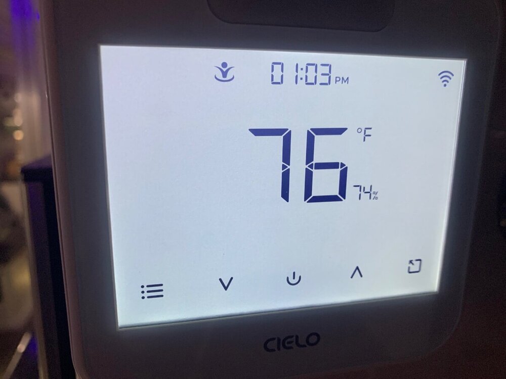

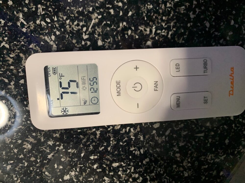

I have repeatedly stated how the Cielo Breez Max thermostat is effective in resolving inherent humidity spikes due to the a/c supply fan running continuously in the Oliver. This particular device has a Comfy Mode feature that will turn off said fan in sync with the compressor and thus, significantly lessen moisture from being reintroduced back into the cabin space. I would like to share the results of a test performed yesterday as tangible proof of its effectiveness:  As I rolled up to the COW Barn with my Starlink Mini’s new Standby Mode unpaused (low-speed data plan), the Cielo phone app was used to start the Drieha Atmos 4.4 from my vehicle to begin cooling. I spent about twenty minutes reorganizing inside the van before opening up the CB and entering the Oliver. I should mention we had a temperature drop from the day before, so not real hot (83°), but relative humidity was high (72%) (P1). The Atmos was still cooling in Comfy Mode (preset to turn off when temp falls below 76° and turn on when temp goes above 77°) and the Oliver was 77°/49% (temp/humidity) at entry per the Cielo’s display (P2). A few minutes later the Atmos turned off in total (supply fan and compressor), the display was 75°/45% (P3). As the interior temp increased the Atmos turned back on in total, the display was 77°/51% (P4). It is important to note that the humidity rose 6% during this total off period. The Atmos then turned back off in total, the display was 75°/47% (P5) with a 4% drop in humidity. I let the Atmos continue to cycle in like manner a while longer before switching from Cielo to remote operation (P6) set at 75°. Since the Cielo can still be used to monitor temp/humidity, at time of remote start the display was 75°/52% (P7) and the compressor shutdown soon after (supply fan continued to run). When the compressor came back on, the display was 76°/75% (P8). Yikes, a 23% spike in humidity! The compressor shutdown once again, the display was 75°/53% (P9) and back on again, the display was 76°/74% (P10); a 21% spike. Compressor off at 75°/53% (P11), on at 76°/72% (P12); a 19% spike. As demonstrated, it is evident that the Cielo’s Comfy Mode does in fact lessen those dreaded humidity spikes experienced at times, you be the judge!

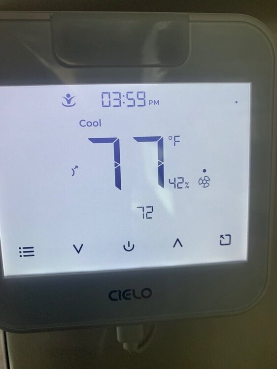

Let me know if you have any further questions unanswered. While running the a/c yesterday in my driveway, I snapped a couple of pics in the afternoon after running for several hours. Houston’s ambient temp at my residence was 97°and relative humidity was 67%. At total shutdown (both supply fan and compressor cycled off) the Cielo showed 77°/42%, moments later both came back on and the ThermoPro showed 75°/38% at next total off cycle.
