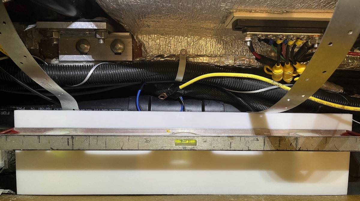

On 1/3/2026 at 11:20 AM, topgun2 said:
Can you say more about how the 3000 W inverter charger was secured? I just picked mine up and I was shocked at how heavy it is. Was it through bolted to the fiberglass with a backing plate or was it secured some other way?
2023 Chevrolet Express 4x4 - 2019 Oliver Legacy Elite II - Hull 529 - Roaming the Western US with Skye (my dog) (and at times my Canadian partner).
It was mounted using an additional extension piece of  “starboard” backing plate (as mentioned in a previous post) glued in with a very very strong industrial grade marine grade fiberglass adhesive. I do not know the name of the marine grade odorless adhesive that was used. I do know its used in Marine grade installs.
I opted not to have my installer drill through and bolt the backing plate through the fiberglass. My concern is the “hanging weight” on the bolt through the fiberglass from the 3000W inverter/charger could/would eventually cause the fiberglass to star or splinter and eventually just crack. In my experience and discussions with Jason E at Oliver service over the years, drilling through the fiberglass is not at all recommended.
So drilling just was not something I was willing to risk. So far my Victron 3000W inverter converter is still very secure.

On 1/3/2026 at 12:51 PM, Cort said:
You could use adhesives. OTT is really good at gluing things down, and drilling into fiberglass, but there are better installation methods. I wanted our Victron MP2 mounted on a solid platform and sitting on rubber to reduce vibration and sound, no way screwed to a board glued to the inner hull!  😎

How to keep the inverter/charger wedged against the fiberglass so that it seals was my next question. What did you use to do that?
Thanks. Finding out how to hang this thing has been my big question.
I talked to Randy at Inverter Sales - he recommended, if I got it right, mounting the unit to a board (HDPE/Plywood/?), scoring the board (with a skill saw/chisel/sandpaper -but go deep if using sandpaper), then using 5200 Marine adhesive to attach it to the fiberglass. Use sticks or tape to wedge the unit against the fiberglass so that it adheres.

  • Vertical Distance (Drop): From the top mounting holes (on the bracket) down to the bottom security holes is 478 mm (18.82 in).
  • Total Unit Height: The total height of the MultiPlus-II casing is 506 mm (19.92 in).
Pre-Drilling Guide for your PVC Board
Measurement Metric Imperial (Decimal)
Top Bracket Spacing (Horizontal) 175 mm 6.89 in
Bottom Hole Spacing (Horizontal) 230 mm 9.06 in
Vertical Span (Top Holes to Bottom) 478 mm 18.82 in
Total Unit Casing Height 506 mm 19.92 in
Total Unit Casing Width 275 mm 10.83 in
💡 Pro-Tips for the Oliver Trailer Install
  • Pre-Mount the Bracket: Do not glue the PVC board with the MultiPlus attached. Glue the board first, let it cure for 24 hours, then screw the bracket into the PVC.
  • Screw Choice: Since you are screwing into PVC board (which is softer than wood), use coarse-thread stainless steel screws (e.g., #10 or #12). Do not use fine-thread machine screws unless you are using heat-set inserts or T-nuts behind the board.
  • Pilot Holes: Always drill a pilot hole in PVC. If you drive a large screw into solid PVC without a pilot, the board can "mushroom" or even crack under the pressure.
  • The "Air Gap": Victron requires 10 cm (approx 4 in) of clearance above and below the unit for cooling. Ensure your PVC board placement accounts for this airflow in the Oliver’s compartment.
