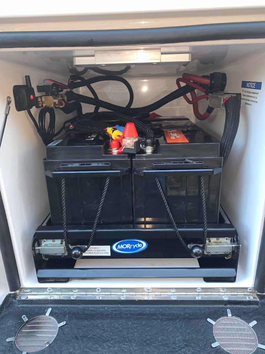

Gene G. Posted November 28, 2025 Posted November 28, 2025 (edited) Beginning to research what I need to do to upgrade to lithium batteries. starting from zero. So don’t even know what I don’t know yet. I am pretty handy. I manage power plants for a living. So I think I can do it myself once I know what needs swapping out. any help would be appreciated! Edited November 29, 2025 by Gene G. 1
jd1923 Posted December 3, 2025 Posted December 3, 2025 (edited) @Gene G. Most here have gone to Epoch (15% OFF ended yesterday! 🙃) or LiTime. Search for these keywords. Install new batteries, get rid of extra wires in bay in preference of new internal busses. Change charger configuration or replace charger for LiFePO4 type. That’s all. I installed 600 Ah Epoch summer of 2024. Just purchased on sale another 300 Ah Epoch Essential and soon we will have 900 Ah snug in the bay! 😎 Edited December 3, 2025 by jd1923 3 Chris & John in Prescott, AZ | 2016 EII #113 | '01 Ram 2500 Cummins!

Moderators Mike and Carol Posted December 3, 2025 Moderators Posted December 3, 2025 Some of what is necessary depends on what solar controller you have. We have Bluesky, so I had to do some reprogramming which was fairly simple to do. We replaced our four AGM batteries with three BattleBorn 100Ah batteries. We did do some wire/cable cleanup, but it was not difficult. 300Ah has been plenty for us when we’re camping without shore power. As Bill suggests, do a search, there’s been a lot of information posted on lithium upgrades. Mike 2 Texas Hill Country | 2016 Elite II #135 | 2020 Ram 2500 6.7L Cummins

Geronimo John Posted December 4, 2025 Posted December 4, 2025 (edited) Ditto. Love our Battleborns. But knowing what's out there now, as posted many times by many owners, the cost of three of them (300AH) and the cabling could lead me today to another larger single battery. PS: In addition to the SOC capability, our 2019 OE2's do not have a master 350 amp shut off switch. Yes there are lots of opinins as to where to mount it, but 95% see the need to ba able to stop the source of power in an emergency QUICKLY. So please add that to the need to do list. Below is John Davies' approach. John Davies Master Battery Switch.docx Note that his install was for 200 amps and inside the cabin basement. I suggest using the 350 amp version as it is higher than the fuse in the 4/0 cabling. Also, I suggest mounting it in the battery box to not delay exiting a smoke filled trailer in an emergency. Get out and shut it off outside. Always grab your fire extinguisher and have it handy. But get the family out first. Edited December 4, 2025 by Geronimo John 2 TV: 2019 F-150 SuperCrew Lariat, 3.5L EcoBoost, 10 Speed Trans, Max Tow, FX-4, Rear Locker OLLIE: 2018 OE2 Hull 342, Twin Bed. OLLIE DIY’s: Timken Bearings, BB LiFePO4's, Victron 712 Smart, 350 Amp Master Switch, Houghton 3400, Victron Orion DC - DC, 3000-Watt Renogy Inverter, P.D. 60-amp Converter, Frig Dual Exhaust Fans, Kitchen Drawer Straps. Front Wardrobe Shelves, Snuggle Shelf. TV DIY’s: 2 5/16" Anderson System, Nitto recon’s, Firestone Rear Air Bags, Bilstein 5100’s, Mud Flaps & Weather Tech all, installed Ham Radio (WH6JPR).
