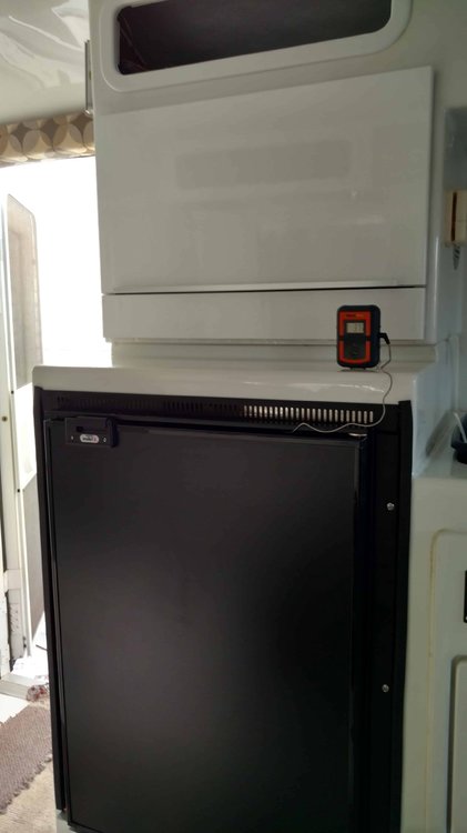

Thanks for the compliment. I do like how it looks but I’m always frustrated when looks get in the way of functionality.
The vent is the one on the backsplash. There’s a matching one that you can’t see in the photo that’s opposite that one but close to the floor, next to the door as you come in.
The fitting that you see to the right of the fridge is actually a recessed tie down from Sea Dog that is my solution for keeping the drawers shut while traveling. There’s one under each of the drawer sets and before we take off I just hook a short bungee from the towel rail to the tie down. Takes two seconds, does the job, and I think the tie downs themselves look good. I throw the bungees in the bottom drawer when I take them off.
Form v function. I get it. But I don't think most of the current fridges open 180. I was surprised that ours did...
Love the towel bar, too. Did you install it, or Oliver? The seadog fitting is clever, and looks good. I'll file that. Our Oliver drawers always stay shut, but we'll see how ikea/ Blum works on the road. The old school self closers on our oliver drawers are really hard to open, and close, both.

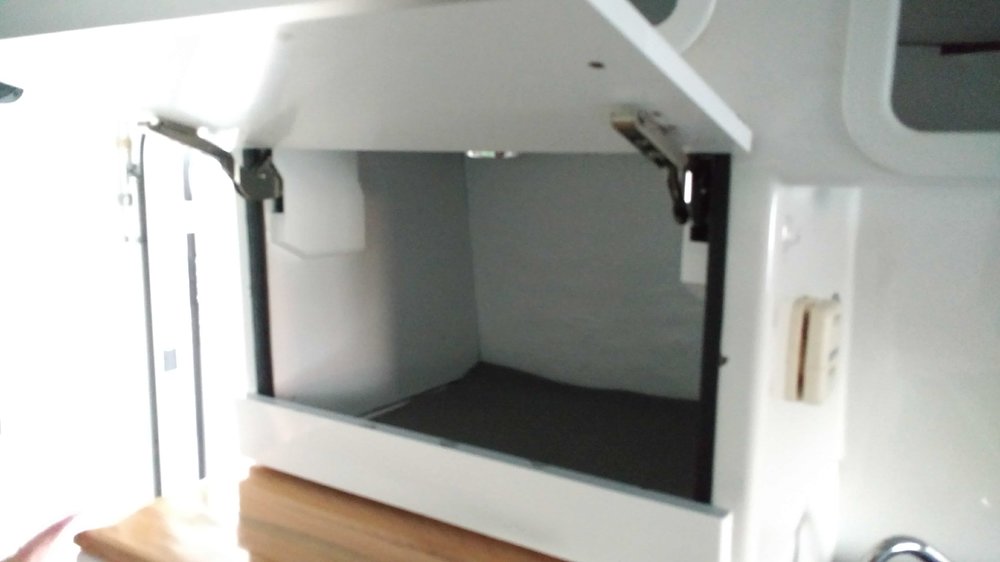

Worked on the microwave cabinet some more. Here's a photo of last dry fit of the cabinet.
Very happy with upswing door. And big storage space within. When we take the last clamps off, and put away the tools, etc., I will post another photo.

I don't know where you travel to, but I would be concerned with that venting Oliver installed, the Isotherm minimum required is 15 sq. in. and it looks like that vent plate is a max of 6 sq. in. without a fan forcing more air through it, the natural convection process does not have enough space to perform properly. Whether this results in poor performance or shortened life, due to overworking to compensate, I would definitely keep a close eye on it, in hotter areas where it might not be able to keep up.

Sherry, I'm digging the flip up door.  I want to see it in action!  Is that a standard size door from Ikea?  Looks like a perfect fit.

Randy, I was concerned about that, too - especially at first when we were having trouble with the ASU unit.  But I ran it for a while with the vent covers removed, and even pulled the fridge out for a few days to see if it ran better, but no difference.  It actually stays pretty cool back there - there's a ton of space behind the fridge, at least 10" or more I'd say, and the venting is diagonal across the back - bottom left to top right, so there's actually plenty of air.  I can take the cover off by the sink and reach in to feel the coils and they're at most a little warm to the touch.  And the air back there is no warmer than the cabin.  It has a small coil pack with a fan that sits pretty much next to the upper vent, which probably helps as well.  This summer I'll test it for a few days to see how it does in the heat, but we're more winter campers so I'm not too worried about it.
Overland, I really like the flipup door. It's a 12 x 24 drawer front, in high gloss white, with an Ikea Blankett 24 inch pull. Beneath it is a hacked 6 x 24 drawer front, cut down to 3.25 x 24. The bottom front gives me a lip to help contain items; the 12 x 24 with linear pull breaks up the great expanse of white. We had originally thought about ( and purchased) a 15 x 24 door, but the 12 intrudes just a little less into the space, and looks better, I think. The bottom lip could be hinged for drop-down, but I don't think I want that. I like the big clear opening, without having to clear the tiny counter of the stuff that usually lands there.. phones, glasses, flashlights, and anything else I don't want the dog to be able to reach.
I can still reach into the cabinet easily. I put a second coat of paint on the interior this morning, without issue. I also love the interior led light we dug out of the " archives", and Paul installed it for me on the ceiling of the cabinet. Really makes a difference.
We used the small Ikea hinges. I'd thought about the Blum aventos xs, as they'd take a little less space, but the Ikea ones were local, and work fine. They're Blum for Ikea, and very well built, and allow for a number of adjustments. And, we're familiar with them, as I have a bunch in my home kitchen...
The Ikea highgloss white is a pretty close match to our gel coat. Just a little brighter/ tiny fraction less grey.

Happy to report that the new fridge has been very quietly humming away for over two weeks now, maintaing frozen bottles frozen, and interior at an average of 37 in the fridge, set on Midway/ 4 setting. I'm loving the interior light, and being able to reach stuff on the bottom shelf without getting down on the floor.
I put a couple coats of paint on the plywood sidewalls and the black back wall/inside of the hull. Put some Ikea shelf liner on the bottom fiberglass. We'll wait to add any lipped shelves til we use it awhile.
I did take a few photos of the lift up door, and the open drawer. I'm very pleased with the additional storage space.
The fridge uses about 20 amp hours a day, in the dense shade of its home parking place, net of the tiny solar gain we get between two tall houses and a bunch of tall palms. When it runs, it uses about 4.2 amps, and runs a few minutes every ten or fifteen minutes. And, we've had a very warm two weeks, with temps like mountain summer weather. In 36 hours, I'm down to 79 to 80 per cent battery used.
I think that's totally manageable for us, and quite efficient. Travel camping, we won't have to plug in. We may have to adjust our panels if we stay put for a week or two at a time, or figure out how to connect one of our portable panels. Or, run the Honda 1000 every few days, if we camp in total shade. We'll see what works out.
