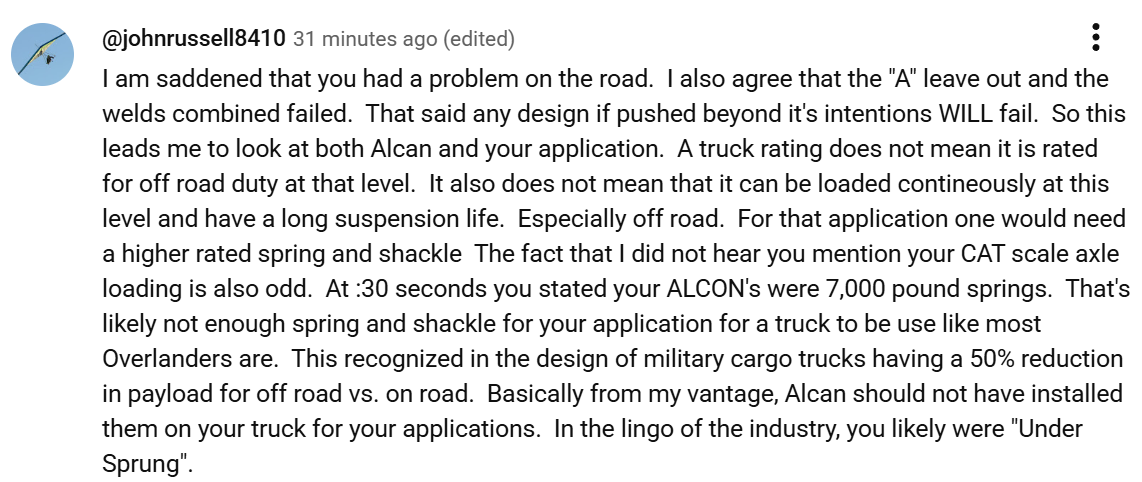

Yes it was a less than optimal design.  Ultimately everything fails if the use is pushed beyond the design limits.  I think this is the case for this young couple.  The fact that THEY INSEALLED the system from Alcan concerns me.  If so, was Alcan advised of the end weight of their vehicle during the purchase or was it a "Send me XXX" and I'll install it transaction.  More "Paul Harvey Questins".....
Crazy Horse has warned me about flaming arrows at times seeking me out.... but I can assure you that I don't intentionally try to be such a target.  Here is my response to the couple left on their comments section of Youtube.
