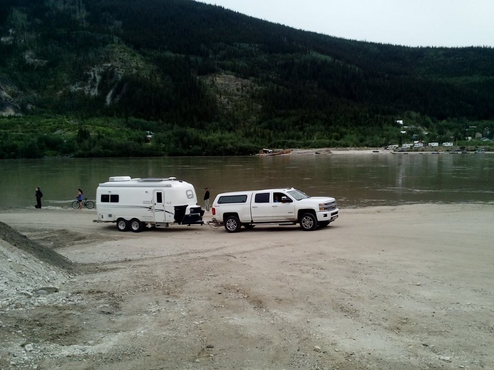

Hello, yes only used the buddy heater as a back up and would not run it when we were sleeping.  I placed it at an angle in front of the closet to place the heat down the walk way and not to close to the fridge corner as it does put out a good amount of heat. I always opened up a window in the front and the back of the  camper partially for fresh air and did this before we went to bed and turned it on again when we got up in the morning and ran it then for a while while the wife enjoyed her coffee. I would have to check the model but it was the middle size one that ran depending where you looked for it around $79 to $109 in the stores. The heater uses those small green propane bottles you see in all the camping store and Walmart, I usually carry at least 4 of them as I use them for a couple of my camping stoves and if you run out say in the Yukon or nowheresville USA they triple the price for them. Well I hope that helps you out and you never have to use it but I'm sure glad we had it. Thanks Gary
[attachment file=Oliver Dawson City Yukon.jpg]

Here is a picture of the better halves from Dawson city waiting on the Ferry to cross from the Provincial campground. This was doing the Top of the World Hwy.
