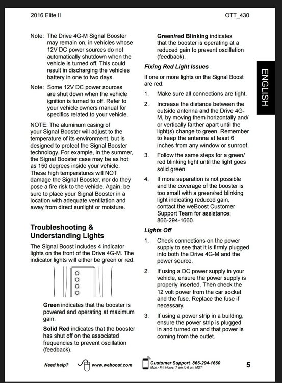

Tonight, I went to move the weboost and looked at the lights for the first time... The top 2 are green and the bottom 2 are blinking red which means according to the manual, that the antennas are to close and that it is reducing the gain... So I pulled the wire and ran it forward more and got the 4 green lights for a short time but everywhere else toward the back gives me the 2 blinking reds on the bottom. I haven't looked at everything yet, so I don't have the answers but...

Reed i had the same issue,  started off with 4 green lights then two of them turned red, seems like the wiring running through the cabinets were causing feedback ( don't ask me to explain, don't know) Richie at oliver moved the antenna to the sidewall right above the window, problem solved!

We also had ours showing all green then two changing to red.  That’s caused by feedback between the inside and outside antennas. Jason moved the inside antenna to the sidewall which cleared up one. Then he took a piece of metal backed insulation (about 12X12 inches) and we put it under the mat in the overhead storage right above the inside antenna. We’ve had no issues since.  All green. Ours does help when the cell signal is weak. Mike

We too had the issue of the lights showing all green on the cell phone amplifier, and then sometimes two of the lights going to red.  When we made our repair trek back to Hohenwald this was one of the items on the “to do” list.   The diagnosis, based on the instruction manual, was that there was feedback between the outside and inside antennas.  The standard cure was applied, i.e. move the inside antennae a few inches and put some aluminum foil on the bottom of the compartment above.
This seemed to help, but when I got back to home base the problem reappeared.  So, I called the manufacturer, WeBoost,  at the number in the manual.  I got this from the technician I talked to:
First, he had me describe the inside and outside antennae locations, and pronounced them plenty far apart. No need to fool around moving the inside antennae a few inches in any direction.  Then he had me hang up and do a series of phone signal strength tests (different from the bars) with the amplifier on and off, and record the data.  We talked the next day.  Based on the numbers he said that I was in a strong signal area, and the booster was reducing the amplification gain because it wasn’t necessary, and showing two red lights to indicate it was doing so.  The booster, he said, was working as designed, and there was nothing wrong with it.  When the booster sensed a weaker cell signal it would increase the gain and show all green.
What the tech told me seems to have been borne out by our experience while traveling.  When we are in the weak signal boonies the amplifier shows all green and we get a stronger signal with the amplifier turned on.  (The cell phone has to be within a few feet of the inside antennae to get the benefit.)   When we are in a strong signal area we get red lights and no boost.  Assuming that what I got from the technician is true and accurate, it would seem many of us have been misled & alarmed by reading an incomplete owners manual.  The “strong signal-reduced gain” phenomenon should have been fully described in the manual.
Electrons were never my long suit, so I can’t vouch for what I got from WeBoost.  It might be worthwhile if some of you who are commenting also call WeBoost and see what you can find out.  Be interesting to see if the story comes out the same,  and learn for sure whether we are really having a problem with our cell phone signal amplifier or all is okay.
