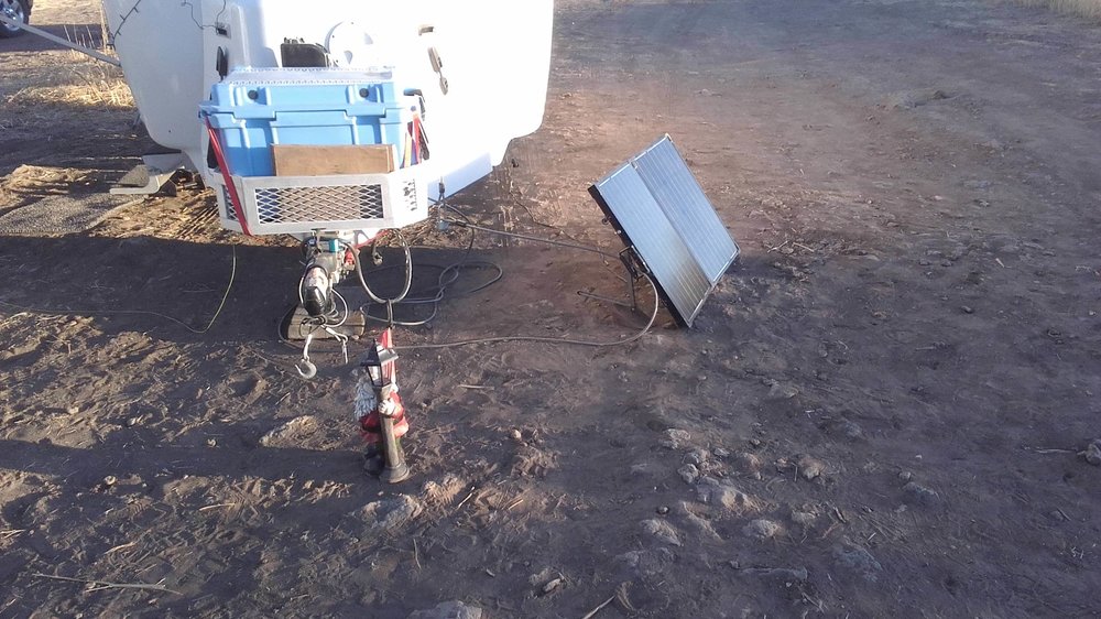

I thought that I would add to this being that we have been consistently using the Renogy Solar Suitcase as our main Solar System for most of the year. We have the Zamp and it continues to pulse away but here at 8am, the Zamp is putting out 1.4amps, while the Renogy Solar Suitcase is putting out 2.8amps. The 100watt Solar Suitcase is putting out twice as much as the 320watt Zamp hard wired Solar System! Then at noon, for a couple of hours the Zamp passes the Suitcase up because it has more wattage and the sun is at its highest at about 45° from the horizontal horizon. At that time the Renogy Solar Suitcase maxes out at 5.8amps and the Zamp maxes out at 6.8amps because of the 0° angle. I do have my Zamp panels tilted a touch to keep the rain rolling off of the street side, so we also take that into consideration when parking because we want to get the most out of the roof mounted panels that we can. Personally, I think that the best thing that Oliver could do if they really want to keep the Zamp system, is to Mount it on a tilting platform that will take it up to 45°... If I didn't have my Renogy Solar Suitcase, then I wouldn't have anywhere near enough Solar Power being that it is December and the shortest day of the year is right around the corner. Once again, my little 100watt Renogy Solar Suitcase is still my #1 Energy Provider.

I'll be interested to see what my portable panels do relative to the rooftop system once I get them set up.  (I decided to run them through our onboard charge controller, which means that I need to remove the charge controller from the panels, swap out cables, connectors, etc. - it's on the to do list still)
What I can say though is that location is a huge determinant relative to what your charge controller is doing.  Here's a graph of our solar output showing the difference between being out traveling in the desert vs parked at home in the shade.  It's pretty obvious when we parked it and you can see that even with 640w of solar and an MPPT controller, we're just seeing around 2 amps many days and only brief peaks of 6 to 8 even on good days...
With our fridge running, it's not quite enough to keep the batteries topped up.
To be clear, I do think that the MPPT controller will be better for you, but I'm going to guess that it won't show as big of an improvement as you're hoping - though I'm curious to see.  For me, the drawback of the Zamp is that it's a black box and no way to see or control what it's doing.  I would recommend my system to anyone and everyone, but because of the info and data rather than performance.
Because of the lack of info on the Zamp controller, any controller with a shunt will put it to shame...
