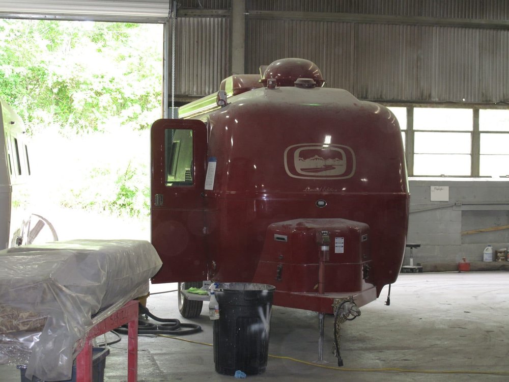

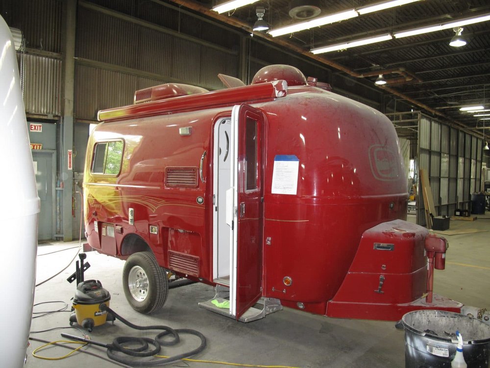

ScottyGS Posted August 2, 2017 Share Posted August 2, 2017 Hey Brandi, I was digging through some pictures of when we picked up our trailer and look what I found. I thought you might like to see these. I remembered that we had seen your trailer when we went to the factory but forgot that I took some pictures of it. Hope you enjoy them. Good Luck on the road. Scotty 1 Gregg & Donna Scott and Missy the Westie - The Flying Sea Turtle - Hull # 145 Western NC Link to comment Share on other sites More sharing options...
Bshaffer Posted August 2, 2017 Author Share Posted August 2, 2017 Thank you! Pictures are great Brandi Shaffer Link to comment Share on other sites More sharing options...
