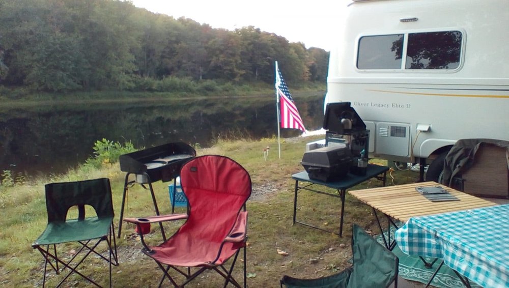

Thank you. We now have a plan, maybe more like a mental sketch, of our path forward. Still thinking we only want a hook up off the stern. Maybe hidden in a protected spot on the bumper. Now to see if we can conceive some sort of wye, as we use a grill and a CampChef stove/oven setup usually. The lobster /corn cooker we will probably leave with a 20 lb. tank as we don't always have that on the menu
We have been thinking of a Clam screenhouse. Wonder if too airtight for a propane fire pit? It would have been real nice at a gathering, on a couple of damp evenings this summer, when we had an arctic breeze coming in off Moosehead Lake. Next day it was in the eighties, go figure.
