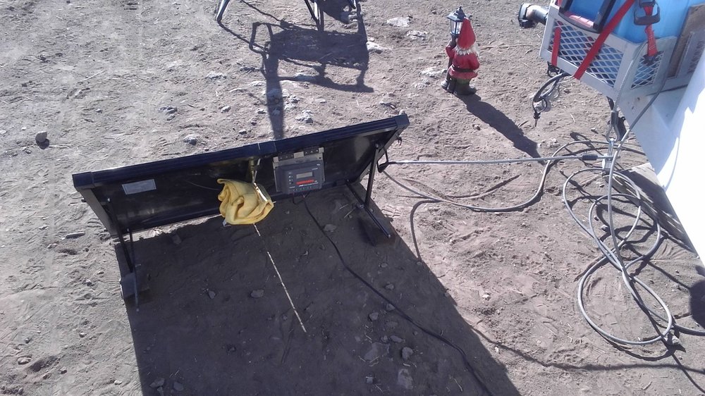

With Oliver's new and now standard "plug and play" port for solar I wanted to just use a Renogy Solar Suitcase for more flexibility but was told the port would not work without our trailer equipped with Oliver's solar package (plus it says so on the upgrade page). In other words, none of controls or wiring inside the trailer would even exist without Oliver installing them when they built my hull. Some of us are not gifted in every area of expertise needed to maintain or modify a trailer. Some of us do know how to do many things, but not all. I opted to have Oliver install what we needed beforehand so I would have more flexibility down the road and not have to drill more holes in my hull, and on. I can always get the solar suitcase if this roof-mount gizmo fails to do the job for us. But as others have advised, the Zamp works fine and I should be pleased with its performance. We shall see.

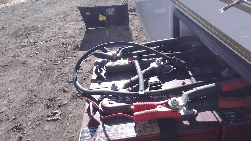

The Renogy Solar Suitcase doesn't need a port... It has its own controller built in and only costs a few hundred dollars. I have mine clipped right on to the battery and the wire runs safely out the battery door, no need for drilling, no need for any Zamp port or any different wiring. Having a fixed system that can't be pointed at the sun isn't getting the most bang for your buck :)
I will take some better pictures after the sun comes up here in a couple hours. I simply clipped on the battery clips, then closed the door and locked it. Then I have a safety cable padlocking it to the trailer so it won't walk off. I'm in a safe place, but I bought the cable and it's part of the system.

Interesting. I  would like to see those pics and learn more about this. My trailer goes into production December 21. What are the new Oliver (now-standard) solar ports for? One of my complaints with the sales force of Oliver is the lack and reluctance to provide adequate info for us to make good decisions. It is learn as we go. We are all faced with doing as much research on our own as possible as well as talking to as many Oliver owners we can. I get it that the sales force is in the business of selling trailers and options, but it would be helpful if they provided more information.

From the pic, it looks as if you still have the solar on top of your unit....Or am I looking at that wrong? So for someone like myself that knows NOTHING about the whole notion of solar, are you saying to leave the $2300.00 Oliver solar option off, get the solar suitcase (that I can clip directly onto the battery) and I will be just as well or better off?  I do like shady sites if I can get them, just to keep my trailer cooler...(I travel with my sheltie, and like to keep things cooler for him...And me)

From the pic, it looks as if you still have the solar on top of your unit….Or am I looking at that wrong? So for someone like myself that knows NOTHING about the whole notion of solar, are you saying to leave the $2300.00 Oliver solar option off, get the solar suitcase (that I can clip directly onto the battery) and I will be just as well or better off? I do like shady sites if I can get them, just to keep my trailer cooler…(I travel with my sheltie, and like to keep things cooler for him…And me)
Yup, I still have the solar on top of my unit but look at the difference in the angle that I can get with the Suitcase and also look at the shadow being cast behind it. Enlarge the pic to see it clearly. The wire just comes out the battery door while being protected by the rubber seal.
This time of year, the sun doesn't go up over your head, it just comes up and follows the horizon around a bit, then goes back down; so having a flat panel on the roof like you see in my pic has no chance of pointing at the sun at all - all day... So I'm getting more amps and full charging capability out of the Solar Suitcase that I have pointed directly at the sun. Being that the Elite has a has a marginal 200watt system in the first place, you would be better off just not buying it because you will get more watts out of the Suitcase being pointed at the sun. Why is Oliver charging $2300 for a 200watt system that doesn't even tell you how many amps it's putting out? The Suitcase here is only $260.00, it tells you the amps, volts, etc... Pretty much a no brainier...

Personally, after doing my research, I can honestly say that I got ripped off on the Zamp Solar... I was told by the Oliver Sales team that The Blue Sky 320watt MPPT system was what was being installed on my trailer and to me, that was a high price, but worth it because Blue Sky is top of the line. I didn't find out about the bait and switch until I picked up my trailer, and then I'd never heard of Zamp and didn't know their reputation of selling their systems for way more then they're worth...
Learn the difference between an old school PWM Solar System and the new state of the art MPPT systems. Take the time and make your own decisions. Anyone offering advice that has a trailer made before this year (2017), has the Blue Sky System, which is a really good system and unfortunately you will hear them say how great their system is, but the reality is that Oliver doesn't put this great system into their trailers anymore... So they can say all of the great things they want too about theirs and it's all true, but your Zamp system isn't even in the same ball park... Save yourself a THOUSAND dollars or more and put in your own 200watt system. There are many great systems to choose from, here's one -

Basically I'm saying, do your research! I did...
https://www.amazon.com/dp/B015DEY2TM/ref=psdc_2236628011_t2_B06VY9DVY9
My other pic didn't stay in the post above, so here it is, pointed right at the sun. I took both pics at 8am here in Sedona, Az.

Reed.  So it looks like one of the systems to mentioned mounts to the roof and the one you have is portable and you place it where the sun is.  For someone like me who is somewhat mechanical but knows nothing about solar, what if anything special to do you to make this work?  Just clip it to the battery or do you somehow have it hardwired?  Also i typically sightsee a fair amount when camping.... National Parks, etc....do you worry about theft?

Reed. So it looks like one of the systems to mentioned mounts to the roof and the one you have is portable and you place it where the sun is. For someone like me who is somewhat mechanical but knows nothing about solar, what if anything special to do you to make this work? Just clip it to the battery or do you somehow have it hardwired? Also i typically sightsee a fair amount when camping…. National Parks, etc….do you worry about theft?
I have the 3/8 cable and padlock around it securing it to the trailer that you see in the last pic in the above post.
The Amazon page with the Solar System is a link for you to start with and to see the prices. That page has both MPPT & PWM systems listed and you can follow the other links in there to start yourself down the path. Basically the kits just need to be mounted and wired into the battery. Where the Solar Suitcase just has the standard battery cable clips that you connect straight to the battery and it comes complete as a plug and play basically.
[attachment file=IMG_20171213_132446.jpg]
The Suitcase gives me the option of being able to tilt it for full sun contact and being able to charge the batteries in the winter when the sun is never overhead. Plus it's $2000.00 cheaper then the Zamp and is a great starting system. I've had mine for over 3 years and if I didn't need it with the 320watt Zamp system that I have... you wouldn't be seeing it.
