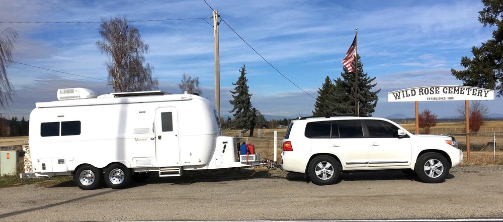

John E Davies Posted December 13, 2017 Share Posted December 13, 2017 If you have multiple tow vehicles, then this RF controller might be a wonderful tool, but I too have reservations about using wireless control of brakes. Wireless (Bluetooth especially) has improved greatly over the last few years BUT the devices may be susceptible to connectivity issues, and outright failures due to voltage spikes. The trailer brake system is just too important to make compromises in terms of reliability. If you have several TVs, go for it, if not wire in a new Prodigy P3. There is a Tekonsha Toyota plug and play adapter harness for about $20, if your Sequoia is fairly recent. I'm not sure where the factory connector is in your truck, on the Land Cruiser 200 and Tundra it is located under the dash, far left side. It can be a little hard to spot.... The hardest part is locating a place to mount it that won't be in the way. Toyota forums might give you some ideas about that. BTW, you will love the way your Ollie pulls behind the truck, IF it has the 5.7 drivetrain.... It's a beast. My Land Cruiser does great. If you have an older 4.7 truck, then it is going to be very inadequate. You will definitely need the Anderson hitch, unless you want to beef up the rear suspension and shocks. You might want to change the tires for beefier 10 ply All Terrains. That will provide noticeably more stability when towing on twisty roads and when maneuvering. The OEM tires on these Toyota SUVs are too squishy, and are very vulnerable to sidewall damage off pavement. Have you selected your graphics? If your Sequoia is white, consider no graphics at all: John Davies Spokane WA 1 SOLD 07/23 "Mouse": 2017 Legacy Elite II Two Beds, Hull Number 218, See my HOW TO threads: Tow Vehicle: 2013 Land Cruiser 200, 32” LT tires, airbags, Safari snorkel, Maggiolina Grand Tour 360 Carbon RTT. Link to comment Share on other sites More sharing options...

Geronimo John Posted March 8, 2018 Share Posted March 8, 2018 "BTW, you will love the way your Ollie pulls behind the truck, IF it has the 5.7 drive train…. It’s a beast. My Land Cruiser does great. If you have an older 4.7 truck, then it is going to be very inadequate." John D: For her maiden voyage, I'll be heading from Ollie pick up in TN to OR, to ID, To UT, To TX, To NC, to VA, and back to Dallas. About 8,000 miles starting in late May. I'll let you know how inadequate the 4.7L Sequoia turns out. I'll also go with 60 PSI on the tires as suggested. Future upgrade: Tire monitoring system. If your observations are spot on, I'll be looking for a Land Cruiser 5.7! Thank you for all the thoughts and advice you have provided to the Forum, and wishing you many more years to continue doing so. Geronimo John TV: 2019 F-150 SuperCrew Lariat, 3.5L EcoBoost, Max Tow, FX-4, Rear Locker OLLIE: 2018 OE2 Hull 342, Twin Bed. OLLIE DIY’s: Timken Bearings, BB LiFePO4's, Victron 712 Smart, 350 Amp Master Switch, Houghton 3400, Victron Orion DC - DC, 3000-Watt Renogy Inverter, P.D. 60-amp Converter, Frig Dual Exhaust Fans, Kitchen Drawer Straps. TV DIY’s: 2 5/16" Anderson System, Nitto recon’s, Firestone Rear Air Bags, Bilstein 5100’s, Mud Flaps & Weather Tech all, installed Ham Radio (WH6JPR). Link to comment Share on other sites More sharing options...
