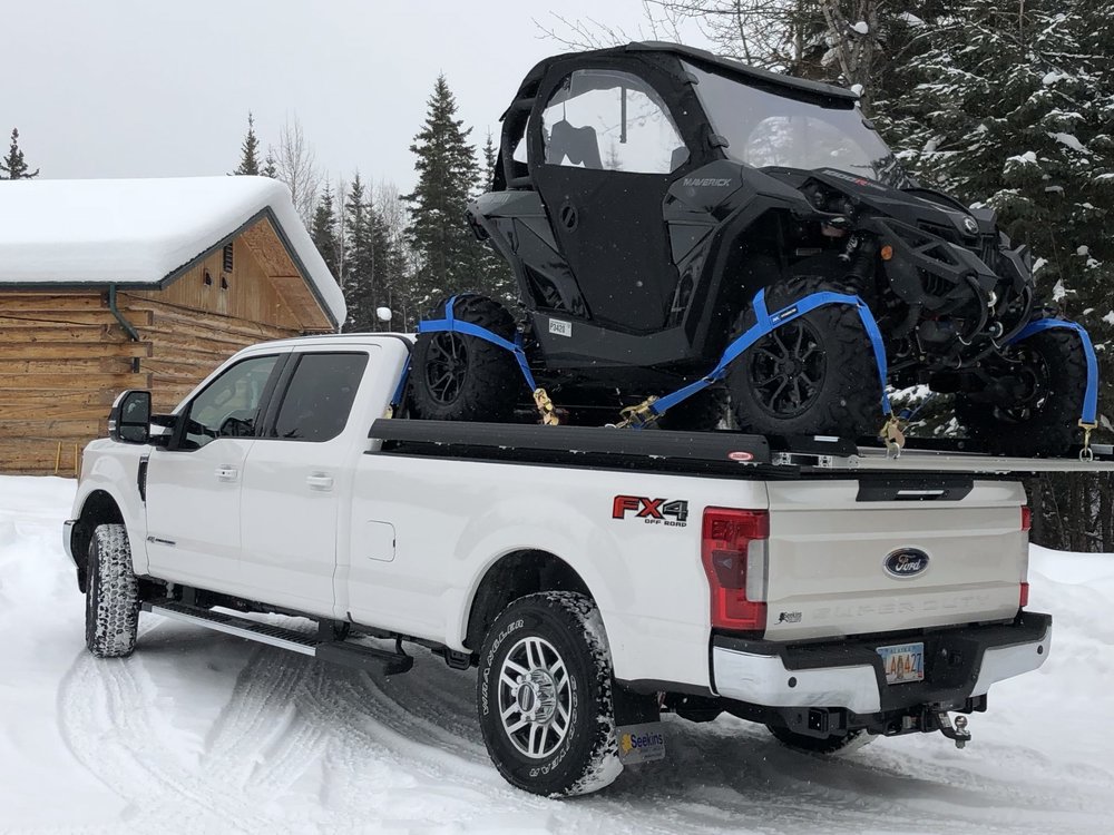

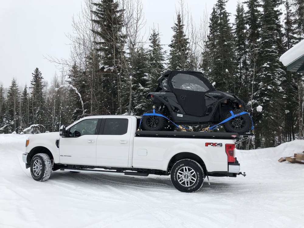

Pic of new tow vehicle and Bed deck I just installed....I think this will be a great adventure!

I love your tow setup, that will work great. I am not sure about leaving the top up on the Can Am for that many miles, is there a tight fitting tonneau that would protect it and also lower the profile? Do you plan to install larger mudflaps on the Ford? Those factory ones are definitely adequate for such an epic trip....

As far as your Rock Tamers go, if you have slop in your receiver, you will be unhappy to see them flopping around when you drive empty. A little play at the hitch translates to up to a couple of inches movement at the far end of the bars. It is not a problem while towing. You can buy TWO of these if it is a problem:

Oh yes, what is the payload of your truck, and the weight of the toy tray and the CanAm?
Subtract those fixed loads, and the rest is what your truck can deal with in terms of “stuff” and 700 pounds of draw bar, Rock Tamers and trailer tongue weight.
If you will be close to maxxed out, then perhaps a WD hitch will be needed.
Some of those HD Fords have massive payloads, do the math for us. My Ram was pretty lightly loaded compared to your rig.
John, no massive payload here.  It's 2700.  I'm actually within 300 pounds of maxing out my cargo capacity with the bed deck and the Can Am.  While I'm close to maxing out payload, I agree, I don't need the WDH.  I'm going with the adage that I have it, paid for it, might as well use it.  It's really for the wife's truck when we get back to Alaska.  She's a healthcare provider and travels to and from the remote Alaska villages several times a year, and prefers driving her Tundra over my rig--and I'm glad she does!

I think you may be underestimating your numbers slightly, my Outlander weighs over 900 lbs, those Mavericks are over 1300. The TruckBoss decks are really sweet, but it looks like you've got the 6.5' bed model, which weighs 450lbs.
The F250 has a maximum payload of 3450lbs before you drop the diesel in it and add the Lariat trim. Does your yellow door sticker really state you have over 3000lbs of payload left?
While you have the extra weight of that diesel on the front axle, I would, at a minimum, recommend the Andersen so that you can dial in as much balance in as possible. The FX4 package makes for a softer off road ride, but can be a hindrance when max towing.
