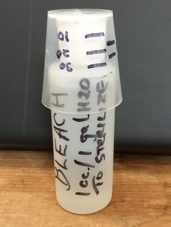

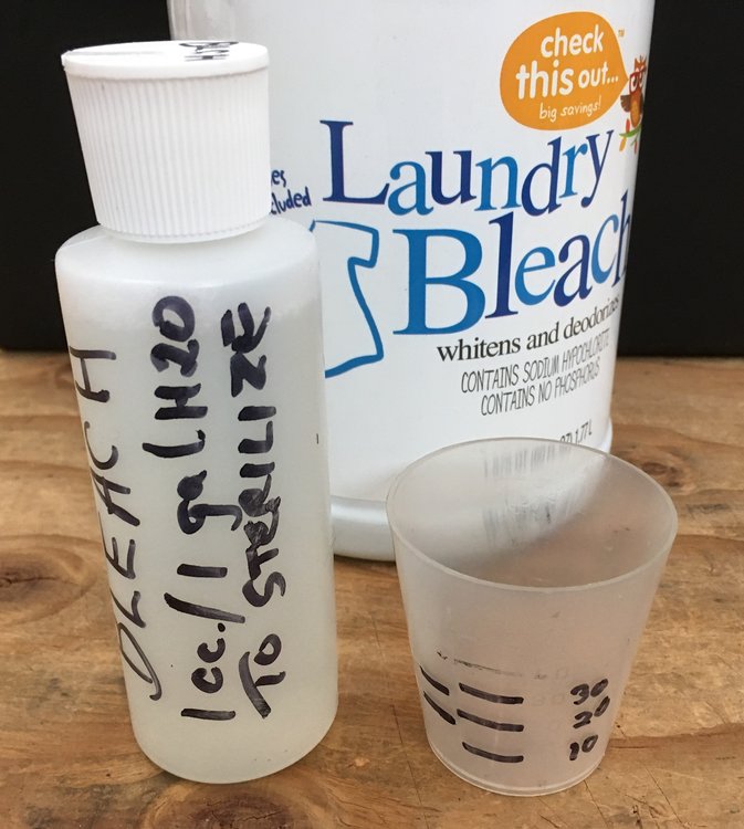

I was looking for a compact storage solution, and I found a 4 ounce squeeze bottle and a small shot-glass style measuring cup from a cough syrup bottle.
Conventional recommendation is 2 teaspoons per 10 gallons. Unless you bake, you may not find measuring spoons lying around....  I converted tsps to milliliters (ccs) and to my delight, 2 tsps = 9.9 ml. So 10 gallons of water needs 10 ml of bleach.
My little shot glass is graduated 5 ml increments, which means 5 gallon increments.
Plus it nests neatly on top of the bottle:
From looking at different websites, this amount is on the high end, so I would not add any more....
