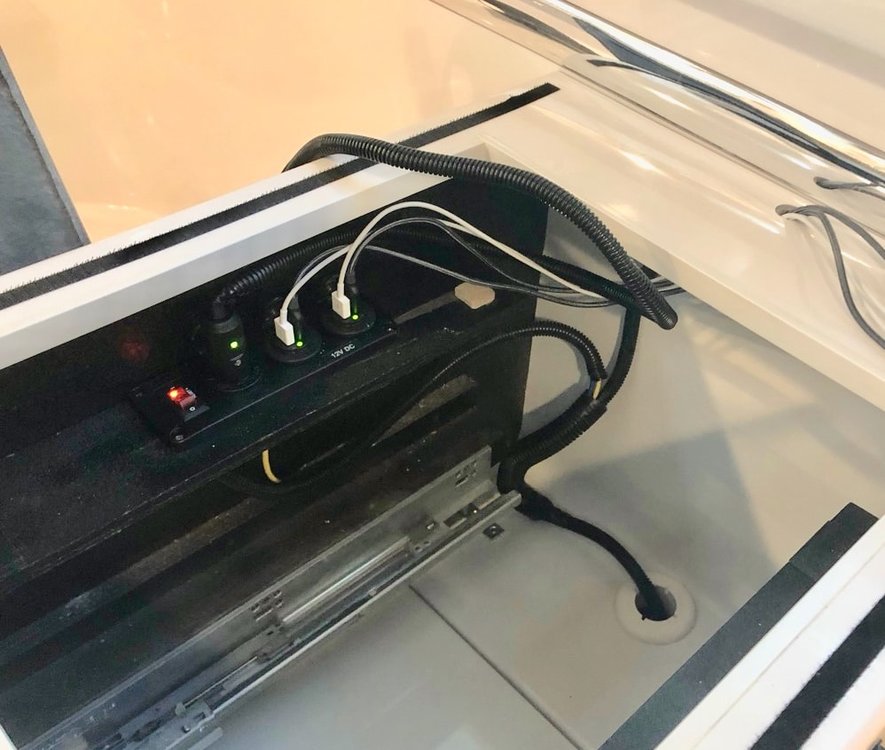

Third, you'll need a socket for the plug if you go that route.  I was fortunate in that I had asked Oliver to provide us with USB ports on the nightstand, so I already had 12 volt power run.  If you don't, then you'll need to tap into the wiring behind the breaker panel on the right side of the attic and then run your wiring down to the basement and then up through the base of the nightstand.  Shouldn't be too difficult but I can't say for sure since I didn't have to go that route.  But I did need the socket, and while I was at it I wanted to add some USB ports inside the nightstand as well.  (That's actually what I'd asked for, but Oliver placed the outlets on the side of the nightstand instead.  Easily accessible, but otherwise you've got to deal with cords getting in the way of bedding and a little green light shining in your eyes.)  So I ordered a combination outlet panel by Blue Sea off Amazon.  It has a pair of dual USB sockets and a lighter outlet, and also has a switch and circuit breaker inside.  It's a really nice panel.

In the nightstand, I removed one of the little shelves that hold the tray in place and mounted the outlet panel there.  The panel is a bit too wide, but it's a good spot for it, so I cut a little notch on the bottom of the tray for it to fit back.  I just unclipped the wiring from one of the USB outlets Oliver had installed and clipped it to the new panel.  I'll probably run a jumper back to that outlet even though I doubt we'll ever use it now.  I don't like the angle of the wire coming out of the plug, so I'll need to add another zip tie mount or something there, but I was down to the two I used on the top so I'll need to get some more.  I then cut a scallop out of the back of the tray to run the wire, and any other cords we might have for charging stuff in the tray.  You'll also notice in the pics that I drilled a hole in the back of the nightstand for USB cords to run, and ground out a little notch in the bottom of the top for the cords.  I think I need to grind out a notch along the back as well, since right now I have to pull the top out a bit for the cords.

Nice installation. Pretty! I especially like your choice of power distbution box. Did you get the high output USB ports?

Did you secure all those floppy wires? But I guess they all ride pretty well just lying in the wood tray when stowed.
Not yet. I ran out of zip tie mounts. Plus I've ordered some with clips off amazon that will allow me to plug and unplug stuff without having to cut zip ties every time.
