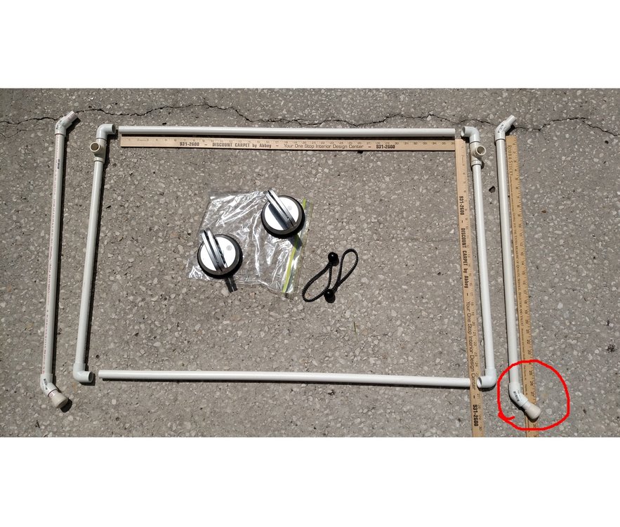

I like it - nice job. Care to share the dimensions of each piece of the PVC? Is that one bag filled with suction cups and are those used to secure the curtain to the sides of the Oliver? Assuming that you use this on the other side of the Oliver, have you used it with the outside shower - is the hose long enough?
Mike –

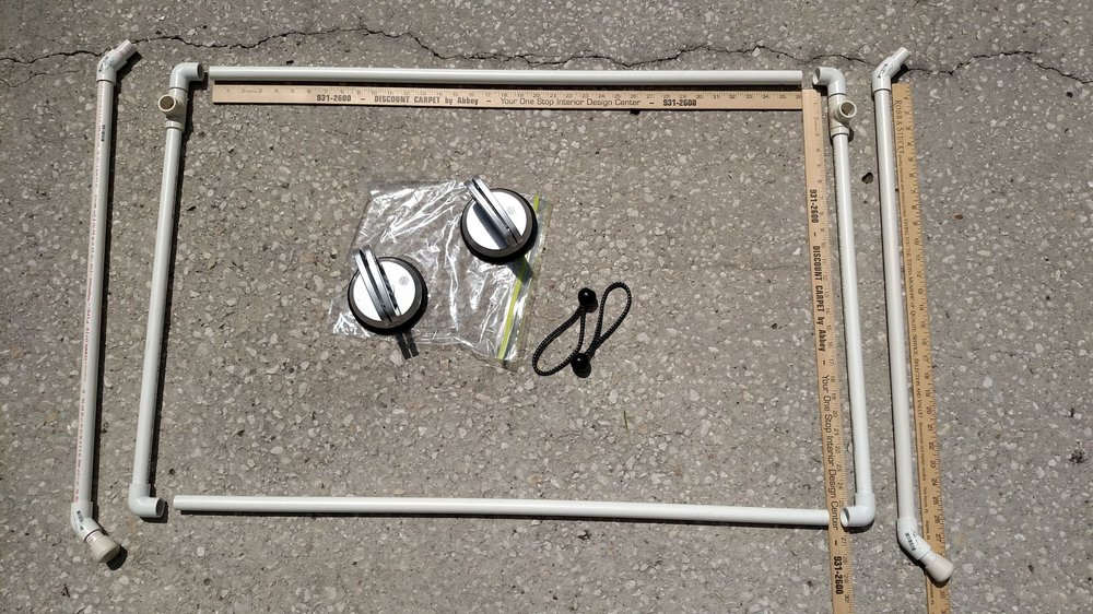

I like it – nice job. Care to share the dimensions of each piece of the PVC?
Will this picture suffice for measurements?
Yes they are Harbor Freight aluminum suction cups holding the frame to the hull.  They are the most expensive parts used, but they do double up in the closet to secure our camp chairs with a bungee cord.

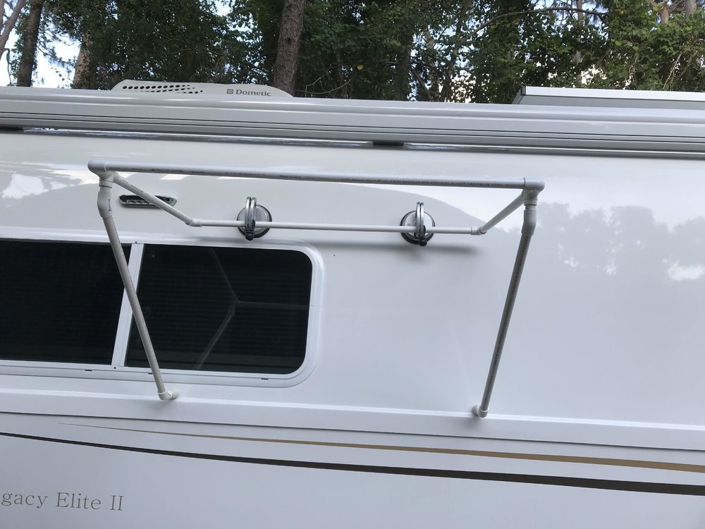

PVC frame attached to street side with shower head attached to holder
Suction cup and bungee ball

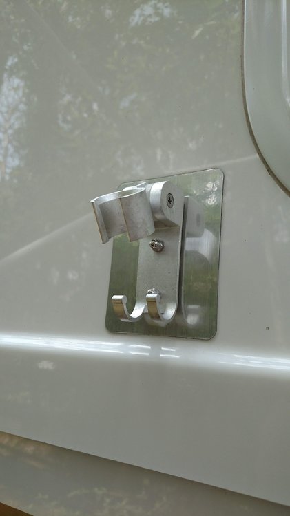

Shower head holder

Where did you get the "shower head holder"?

Amazon??

Thanks for the link on the shower head holder. Even though I will be passing fairly close to Craters of the Moon it doesn't look like I will have the time to stop. One would think that being on the road for just about two months there would be plenty of time - but - no. Looks like I should have planned for a three month trip!
I’m glad you found it useful. It’s a cheap and simple mod. One suggestion for anyone adapting this for their use is to cut the short horizontal with the chair tip last. It will be easier to make your frame horizontal when installed.

After getting two ten foot sticks of 1/2 inch schedule 40 plastic pipe, it took all of about 20 minutes to cut the pieces, and another ten minutes to glue most of it together. Remember - you probably do not want to glue the cross pieces and the "down" arms so that you can disassemble for storage.

Since I didn't want to permanently stick the shower handle holder to the exterior of the Oliver I ordered this suction model
https://www.amazon.com/gp/product/B074V9JSK3/ref=oh_aui_detailpage_o00_s00?ie=UTF8&psc=1
Finally, the rubber feet that Mike used are available at Ace Hardware - the 7/8 inch size fits on the 1/2 inch plastic pipe.
