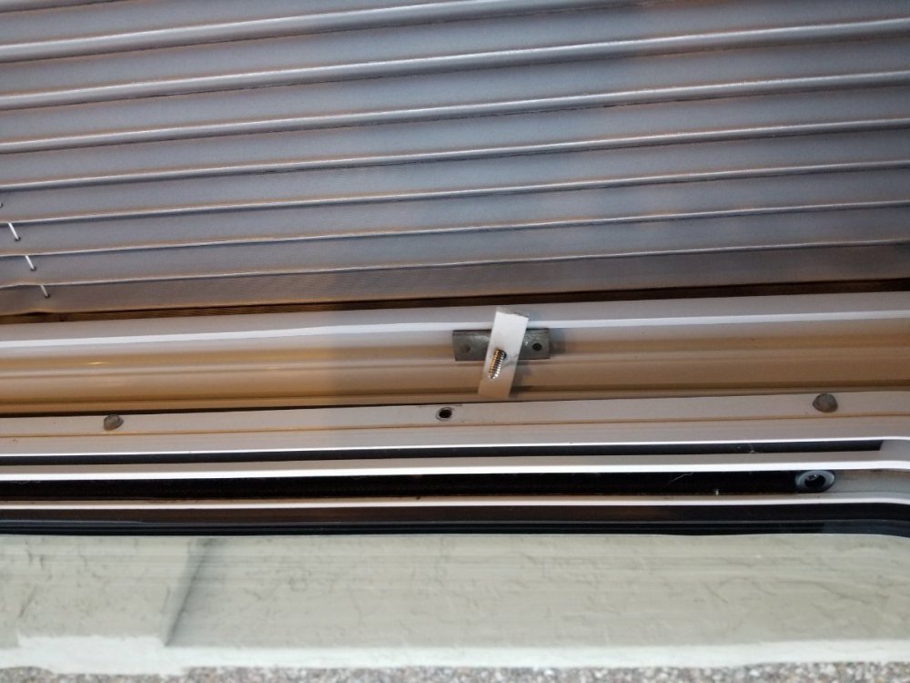

Liana Posted February 3, 2021 Posted February 3, 2021 On 1/31/2021 at 7:06 PM, John E Davies said: Here you go. Be careful working with those stainless steel clips, they can draw blood, especially if you use a power driver on the screws. https://olivertraveltrailers.com/forums/topic/2202-how-to-fix-and-flip-your-blinds/ A couple of mine were falling off every trip. After fixing, there have been no worries for four camping seasons. John Davies Spokane WA Thank you for the link. I've gotten up enough guts to tug the shades off the windows and flip them around. BUT, when I did that, I found several of the screws loose (I'm sure I saw somewhere what someone else did to address this!), it seems as tho the holes for the screws that are loose are actually stripped. So, exact opposite of the holes being too small: one of the screws pulled all the way out of the window frame with the clip still embedded in the shade frame. Should I just go hunt down some bigger screws? 2018 LE2 #333 "the Otter" 2015 Silverado 2500HD
John E Davies Posted February 4, 2021 Posted February 4, 2021 17 hours ago, Liana said: the holes for the screws that are loose are actually stripped. So, exact opposite of the holes being too small: one of the screws pulled all the way out of the window frame with the clip still embedded in the shade frame. Should I just go hunt down some bigger screws? Please submit a service order about what appears to be an ongoing problem with how these are being installed. It sounds as if the pilot hole in the frame was drilled too big, which is an easy mistake to make, but it does present problems; the next larger screw diameter may fix it, but the head will be a little bigger too. If they are using “self drilling” screws instead of regular ones, that is OK but only if the clip holes are larger, so that the clips can pull down tight and flat to the frame. The clip must be free moving in relation to the screw threads. Post some closeup pictures here for a more detailed opinion😬 John Davies Spokane WA 1 SOLD 07/23 "Mouse": 2017 Legacy Elite II Two Beds, Hull Number 218, See my HOW TO threads: Tow Vehicle: 2013 Land Cruiser 200, 32” LT tires, airbags, Safari snorkel, Maggiolina Grand Tour 360 Carbon RTT.
Liana Posted February 4, 2021 Posted February 4, 2021 25 minutes ago, John E Davies said: Please submit a service order about what appears to be an ongoing problem with how these are being installed. It sounds as if the pilot hole in the frame was drilled too big, which is an easy mistake to make, but it does present problems; the next larger screw diameter may fix it, but the head will be a little bigger too. If they are using “self drilling” screws instead of regular ones, that is OK but only if the clip holes are larger, so that the clips can pull down tight and flat to the frame. The clip must be free moving in relation to the screw threads. Post some closeup pictures here for a more detailed opinion😬 John Davies Spokane WA Thanks for the thoughts, John, I'll snap some pics later today. I don't know if it's an "ongoing" problem, I saw the first post about the whole window shade thing in 2018 and ours is a 2018 2018 LE2 #333 "the Otter" 2015 Silverado 2500HD

Liana Posted February 5, 2021 Posted February 5, 2021 On 2/4/2021 at 8:30 AM, John E Davies said: Please submit a service order about what appears to be an ongoing problem with how these are being installed. It sounds as if the pilot hole in the frame was drilled too big, which is an easy mistake to make, but it does present problems; the next larger screw diameter may fix it, but the head will be a little bigger too. If they are using “self drilling” screws instead of regular ones, that is OK but only if the clip holes are larger, so that the clips can pull down tight and flat to the frame. The clip must be free moving in relation to the screw threads. Post some closeup pictures here for a more detailed opinion😬 John Davies Spokane WA Two of these on the same frame pulled out like this. I put #10 screws instead of #8 (the #10 heads fit just fine) but there's nothing preventing the same thing happening with those 2018 LE2 #333 "the Otter" 2015 Silverado 2500HD
