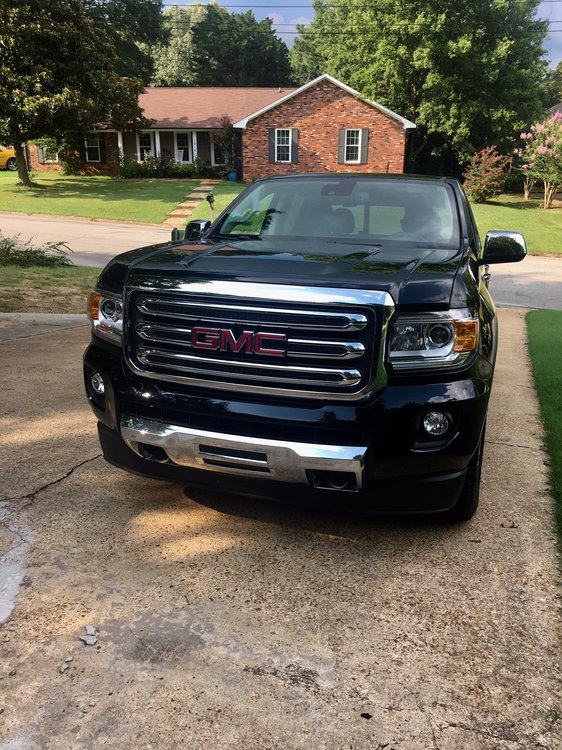

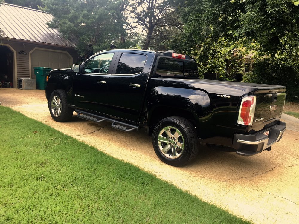

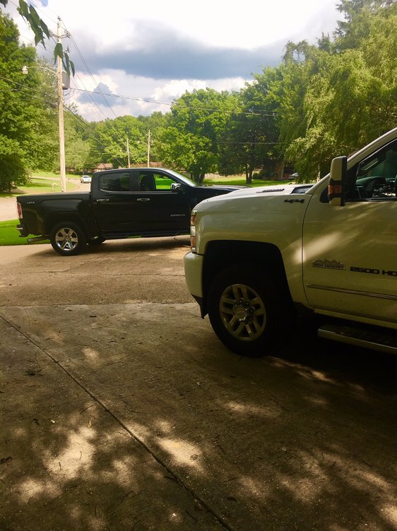

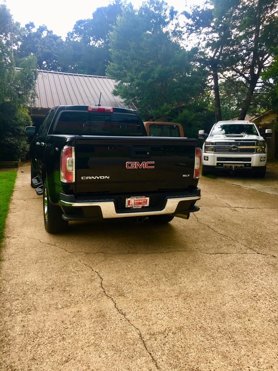

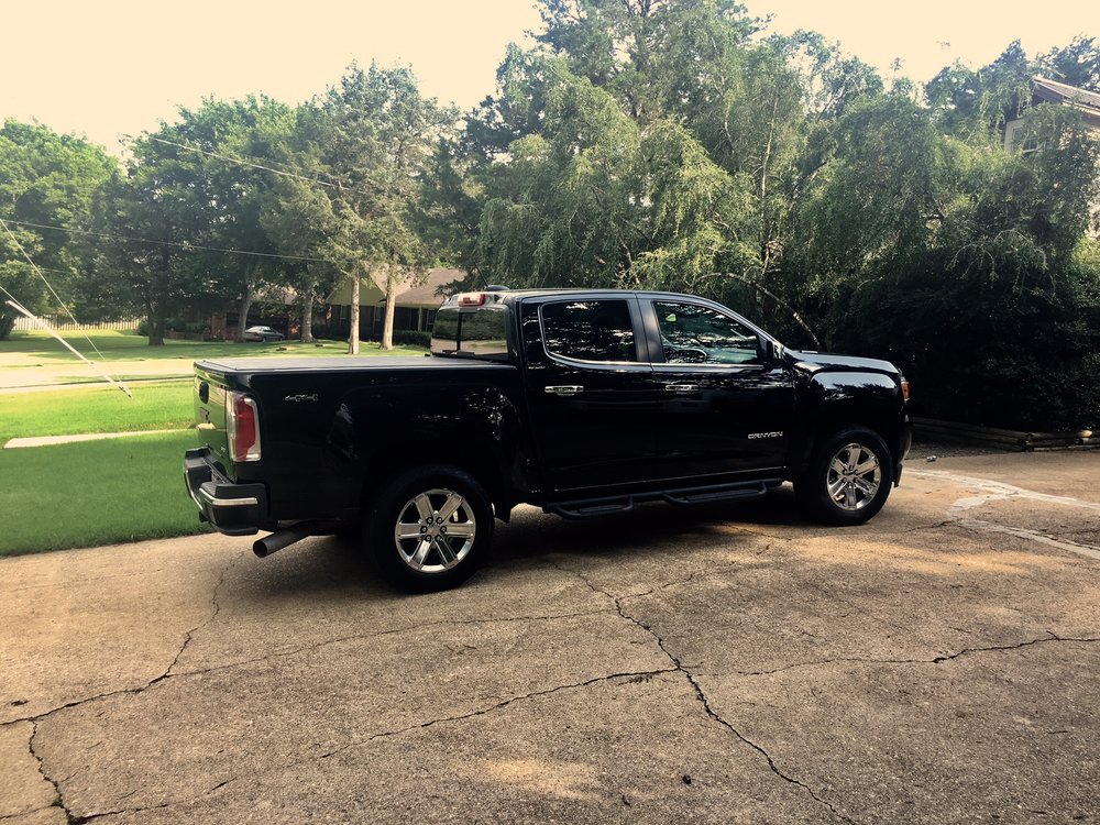

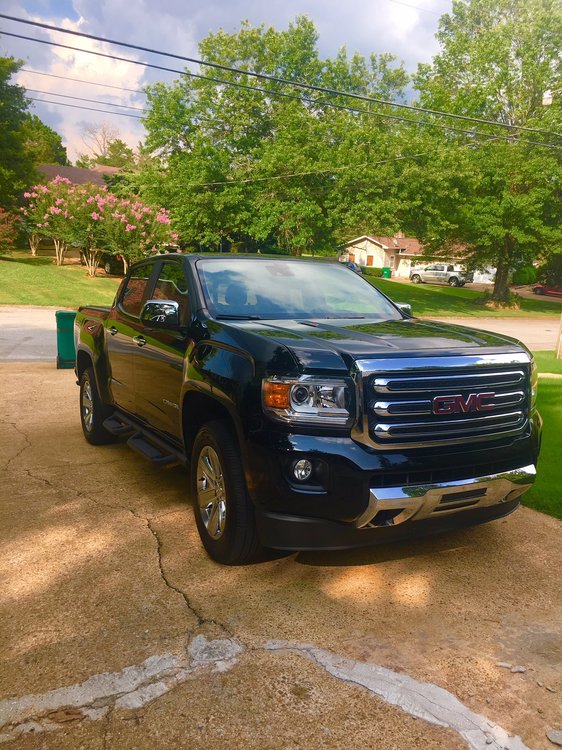

We brought the new Canyon home yesterday.  It is a crew cab, short bed, SLT model and has the "baby" 2.8L Duramax and we are really pleased.  It is a 2017 model with all the bells and whistles and had been retained by GM to use as a loner.  Although it has 23000 miles in it, it has never been titled and was sold as "new" with the warranty and factory maintenance agreement intact.  Considering we were looking for just that vehicle and they knocked $16K off the $48K sticker price, I thought that was too good a deal to pass up.  Based on the fact that it weighs about half of what the Silverado does, I believe it will get much better mileage towing than the bigger truck.  It has a tow rating of 7700 pounds and the Oliver only weighs a little over 7000 pounds so we should be good to go, right?  The 13000 pounds capacity that the Silverado has just seems to be a lot of wasted potential.
Just kidding folks, the new truck belongs to my DW Tali and will become our daily driver.  The Silverado lives on and will remain the TTOC (Tow Truck of Choice) for pulling the Oliver.  We have other, smaller trailers for different purposes and the Canyon will do nicely for them.
It’s a good looking truck, Steve. Hook up the Ollie and take it for a spin up the Trace to see how it does! Mike
Nice truck!
Out of curiosity, what is the payload rating (located on sticker on the driver side door jamb)? Could be just right for my Ollie1....maybe....hopefully.
Dave
2015 Oliver Elite 1, Hull 107
Mmm...a two-pickup-truck-family now. You and Tali must wear a cowboy hat when driving those trucks. Also, didn't know you had moved to Tupelo, Texas!
Seriously, those are 2 nice looking trucks sitting in you driveway. They should serve both of you well for years. Congrats!
