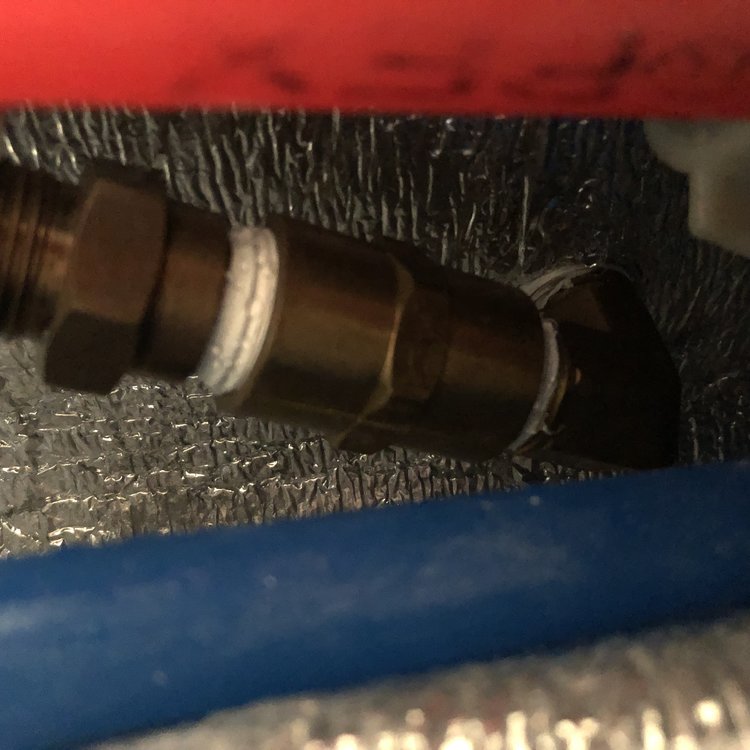

MaryandBill Posted December 9, 2018 Author Share Posted December 9, 2018 Great help and thanks to everyone for offering ideas. The drip in the rear scupper hole stopped as soon as I unhooked the water from the city inlet. I need to tighten the fitting I replaced last week. Maybe retake it. I had a terrible time getting pipe tape on it in such a small space. The water from the front scupper hole has continued to drip. Would condensation be more likely to occur in the front bathroom corner? There are no other drips except this one. Link to comment Share on other sites More sharing options...
Moderator+ ScubaRx Posted December 9, 2018 Moderator+ Share Posted December 9, 2018 ...The water from the front scupper hole has continued to drip. Would condensation be more likely to occur in the front bathroom corner? There are no other drips except this one... My suspicion is that the water stopped at the rear due to you removing the source (water from the city inlet.) Further it is probably still dripping from the front due to the amount of water that has collected along the length of the trailer. Lower the front end slightly and see if the water won't run out quicker. The quicker you get the bulk of the water out, the better off you'll be but there won't be any lasting damage. Probably just a small leak. For the repair, some of this or this might be easier than dealing with the teflon tape. 1 Steve, Tali and our dog Rocky plus our beloved Storm, Maggie, Lucy and Reacher (all waiting at the Rainbow Bridge) 2008 Legacy Elite I - Outlaw Oliver, Hull #026 | 2014 Legacy Elite II - Outlaw Oliver, Hull #050 | 2022 Silverado High Country 3500HD SRW Diesel 4x4 Link to comment Share on other sites More sharing options...
MaryandBill Posted December 9, 2018 Author Share Posted December 9, 2018 I’m going out to lower the rig right now. Great idea for alternatives to pipe tape. I’ll pick some up and redo that connection. Thanks! Link to comment Share on other sites More sharing options...
