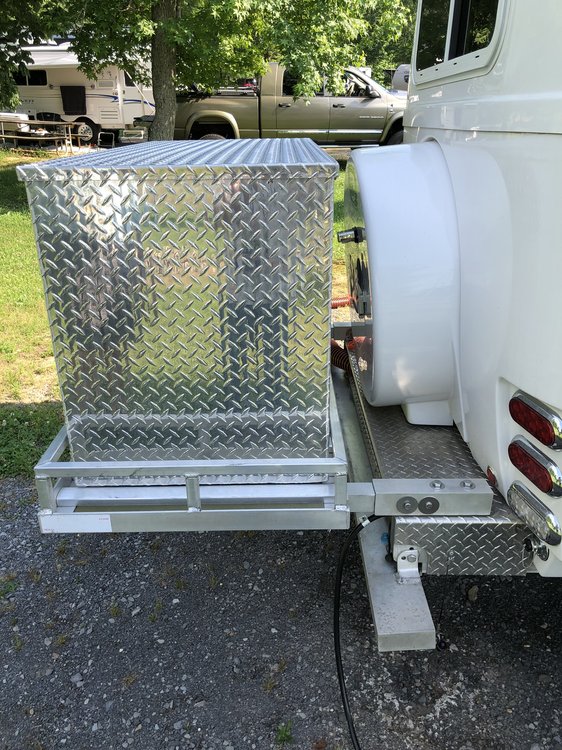

I meet a fellow Ollie owner at the Oliver Festival in Alabama who has the exact same setup as mine. 2017 Audi pulling Elite II. The only difference, he had a large tool box mounted on the back of his Ollie. He doesn’t get the ACC warning error. His cruise control worked all the way back to Colorado.
My next project is to add carrier to my Ollie. Need one anyway.
