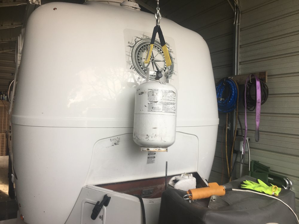

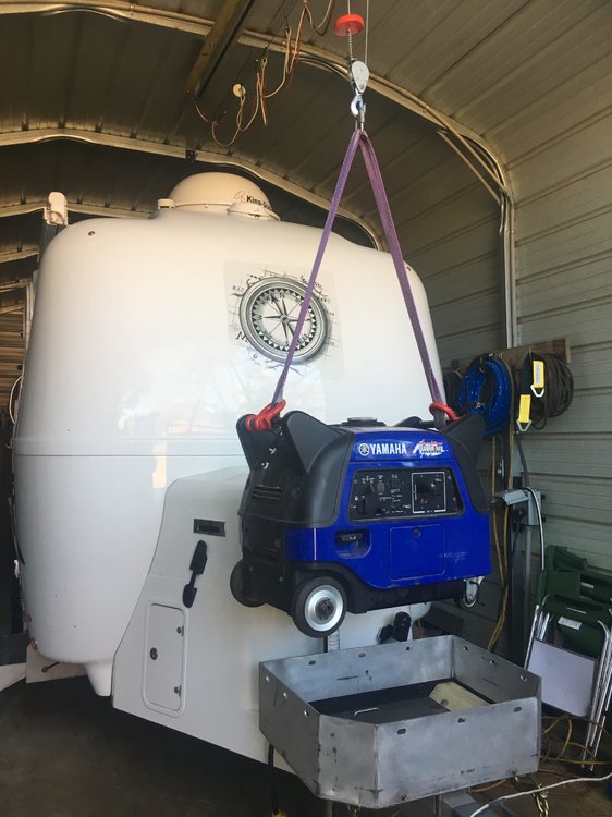

Moderator+ ScubaRx Posted March 12, 2019 Moderator+ Share Posted March 12, 2019 Many of us have to use what we have. We are unable or unwilling to buy a new piece of equipment because it's lighter or more fancy. I love my EF3000iSEB Yamaha. Yea, it is heavy and it was expensive (sounds like all the other Fiberglass Trailer Owners describing our Olivers) but it's what I've got. It never fails to crank (it's 10+ years old) and it will run the entire trailer. I don't have or need the EasyStart system. It's ridden on the tongue of both our Olivers these past 11 years and I only take it out of the basket to service it. With a full tank of fuel it weighs over 175 lb. I couldn't begin to lift it so I installed a lift in the roof of the garage the Oliver lives in when it is (rarely) not on the road. The lift also serves to remove and replace the propane tanks for filling and the 250 lb tool box that rides in the truck when we travel. 1 Steve, Tali and our dog Rocky plus our beloved Storm, Maggie, Lucy and Reacher (all waiting at the Rainbow Bridge) 2008 Legacy Elite I - Outlaw Oliver, Hull #026 | 2014 Legacy Elite II - Outlaw Oliver, Hull #050 | 2022 Silverado High Country 3500HD SRW Diesel 4x4 Link to comment Share on other sites More sharing options...
BackofBeyond Posted March 12, 2019 Share Posted March 12, 2019 The lift also serves to remove and replace the propane tanks for filling and the 250 lb tool box that rides in the truck when we travel. At first look I did a double take, "you store the gen set on the roof". I need me one of them "portable lift system", but I digress. Nice home set up. I'm holding out on a gen set - If I need AC I'm either in the wrong place, or I'm at a spot with shore power. But again, seems I've got everything else, but the sink and a gen set..... Cindy, Russell and "Harley dog" . Home is our little farm near Winchester TN 2018 Oliver Legacy Elite II - 2018 GMC 2500 Duramax "Die young - As late as possible" Link to comment Share on other sites More sharing options...

Moderator+ ScubaRx Posted April 8, 2019 Moderator+ Share Posted April 8, 2019 Mingy wrote: Greetings All, Does anyone know if an EU 3000I by Honda will fit in the tongue box without mods? Its weight is about the max allowable in the tongue box, say about 150 lbs. Mingy According to Honda specs: The EU3000IS has a footprint of 25.9 x 17.6 which I don’t believe will fit within the basket due to the front of the basket having angled, front corners. ... Our Yamaha EF3000iSEB's footprint is 26.8" x 17.5" and it fits quite nicely in the box with the angled corners. It actually has about an inch clearance on either end and the back with about three inches in front. 1 Steve, Tali and our dog Rocky plus our beloved Storm, Maggie, Lucy and Reacher (all waiting at the Rainbow Bridge) 2008 Legacy Elite I - Outlaw Oliver, Hull #026 | 2014 Legacy Elite II - Outlaw Oliver, Hull #050 | 2022 Silverado High Country 3500HD SRW Diesel 4x4 Link to comment Share on other sites More sharing options...

Moderator+ ScubaRx Posted April 10, 2019 Moderator+ Share Posted April 10, 2019 We’ve never regretted buying the larger generator. I’m all about overkill and it never fails to supply what power we need. Yeah, it’s heavy, but I have an overhead hoist to remove and replace all the stuff I can’t, or don’t choose, to manage alone (generator, tool box in truck and propane tanks. Steve, Tali and our dog Rocky plus our beloved Storm, Maggie, Lucy and Reacher (all waiting at the Rainbow Bridge) 2008 Legacy Elite I - Outlaw Oliver, Hull #026 | 2014 Legacy Elite II - Outlaw Oliver, Hull #050 | 2022 Silverado High Country 3500HD SRW Diesel 4x4 Link to comment Share on other sites More sharing options...
