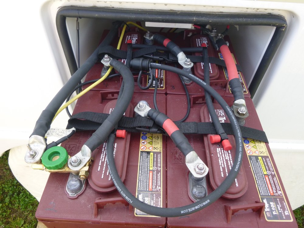

For a time I had a battery cut-off switch installed as shown below - the piece with the green knob.  It worked "OK" but I had to remember to check the connections for tightness often.  I have since removed it and now use a small solar panel while Twist is in storage to constantly keep the batteries charged.
Easy to do.  You might see if Oliver is willing to do it first (I've complained many times that they don't have them standard, so the more people who ask, the better).  If they won't, then I'd ask the guys in service to sell you an extra battery cable, which will keep you from having to make one up.  At that point it's just mounting the switch and connecting the cables.  I like these switches.  You'll have plenty of room to mount it in the compartment under the street side bed, which is where the battery cable comes in.  Or inside the battery box if that's where you want it.
